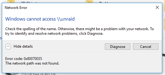

Randomly I will attempt to connect via these quick access shortcuts, and I receive an error that the network path was not found. Typically, I'll wait 30 seconds to a minute try again and I'm then able to connect with no issue.

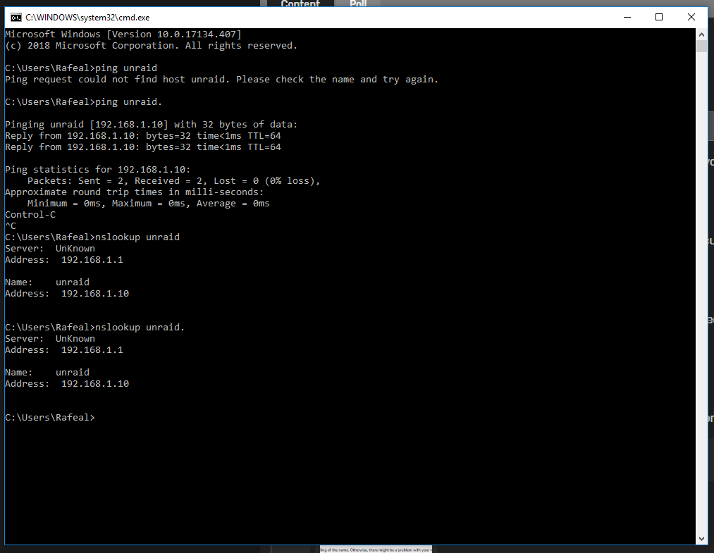

I've changed the name of my server to unraid, and have Quick Access shortcuts mapped to \\unraid. The attached command prompt shows the results, below is a summary:
  • ping unraid; "ping request could not find host unraid"
  • ping unraid.; works successfully
  • nslookup unraid; works successfully
With this in mind, I added a period (.) to the appened DNS suffixes, which hasn't resolved this issue. I run an EdgeRouter Lite as my router, and I've also added a static host mapping for unraid which also hasn't resolved this issue.

As a work-round you could map your short cuts to \\192.168.1.10 instead. The issue is name resolution related.
