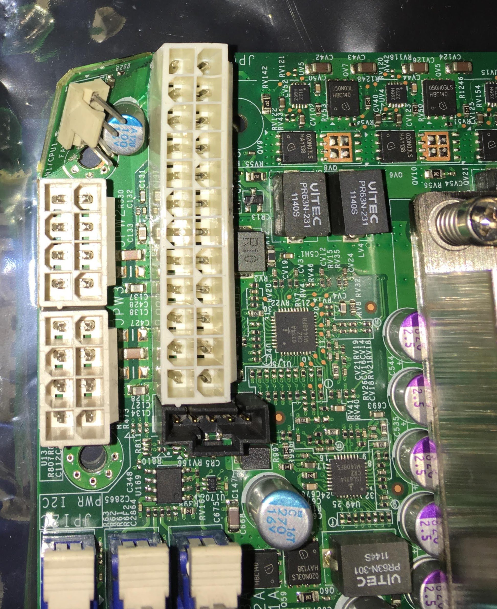

To my horror the board arrived damaged (one corner had almost completely broken off). But the seller was on the up and up and sent me a replacement which worked right away.

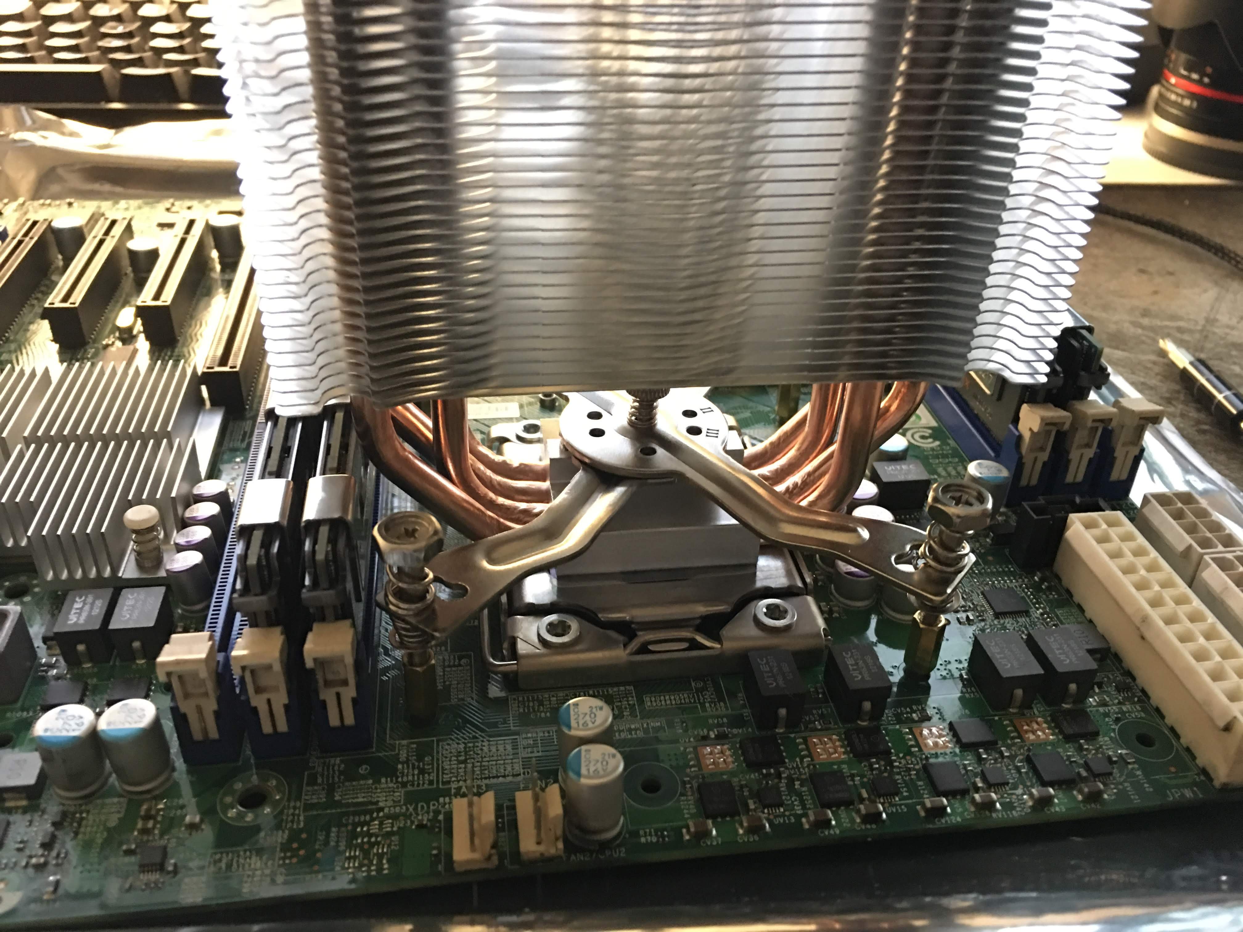

The third challenge was to get coolers to fit. And to my delight I found a guide that said the 212 EVOs would mount by using some 10mm M3 standoffs on the server-variant 1366 backplate. It worked like a charm, although it was a tight fit! (the heatpipes are in contact with the RAM sticks).

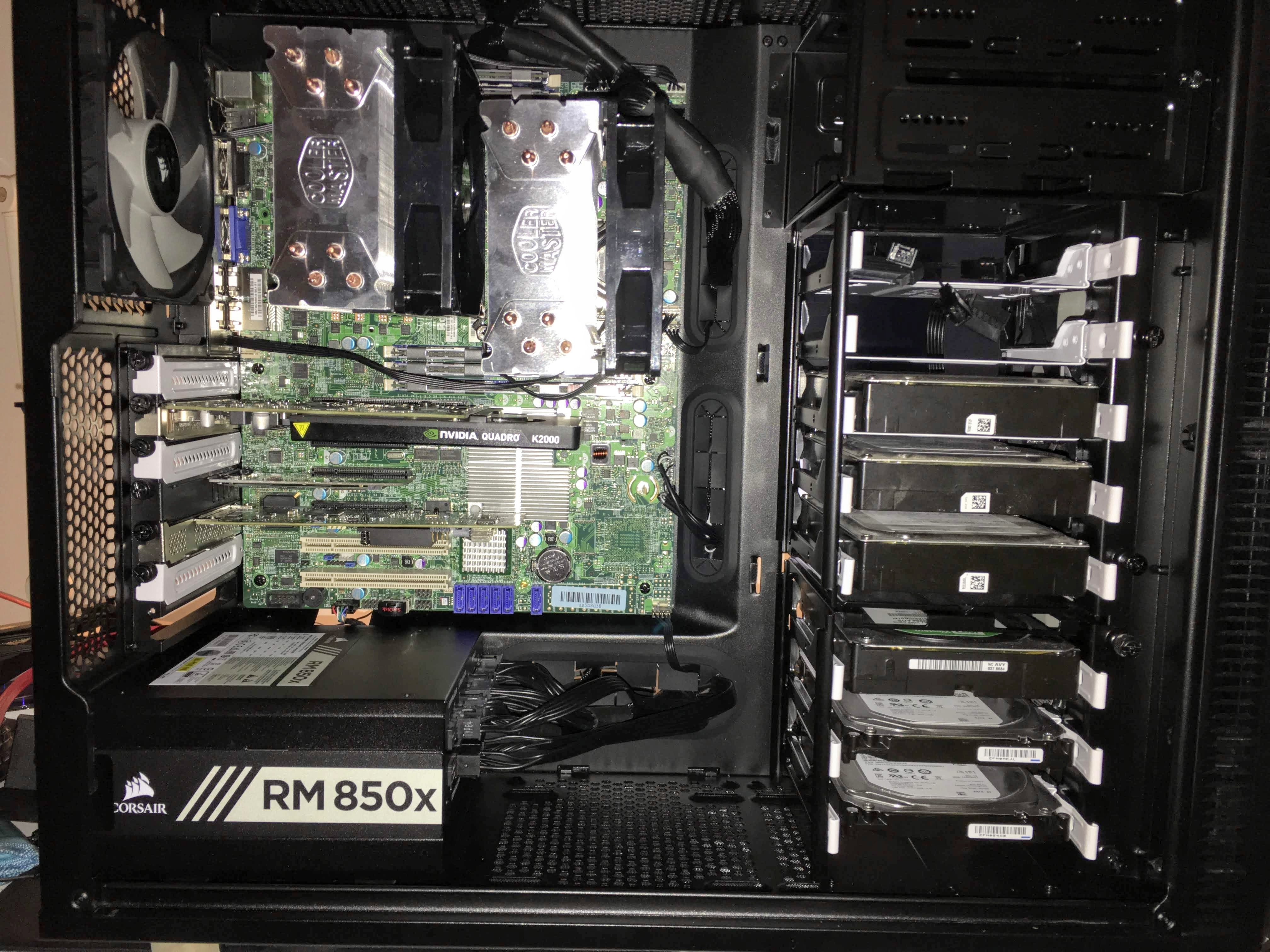

Anyway, besides the hot southbridge, it works great. I added a Quadro (only viable option i found for a single slot card) and the Windows 10 VM I installed worked perfectly! I haven't done any extensive benchmarking yet, but encoding my blu-rays goes a lot faster than my i3 in the old machine. Here is the final hardware list:
Case: Fractal Design Define R5
Mobo: Supermicro X8DTL-i
CPUs: 2x Intel Xeon E5645 6 core/12 thread 80W TDP
Coolers: 2x Cooler Master Hyper 212 EVO
RAM: 6x Hynix 4GB DDR3 ECC 1333 GHz
PSU: Corsair RM850x
Fans: 2x Corsair ML140 (front intake), 2x Corsair ML120 (side panel intake, rear exhaust)
GPU: Nvidia Quadro K2000 2GB Kepler
Storage controller: LSI SAS 9201-8i HBA
Adapter: NVMe PCI-E M.2 SSD to PCI Express 3.0 X4
Storage: 2x 4TB (1 as parity), 2x 2TB, 2x 750GB
Cache: Intel 600p 256GB NVMe SSD
