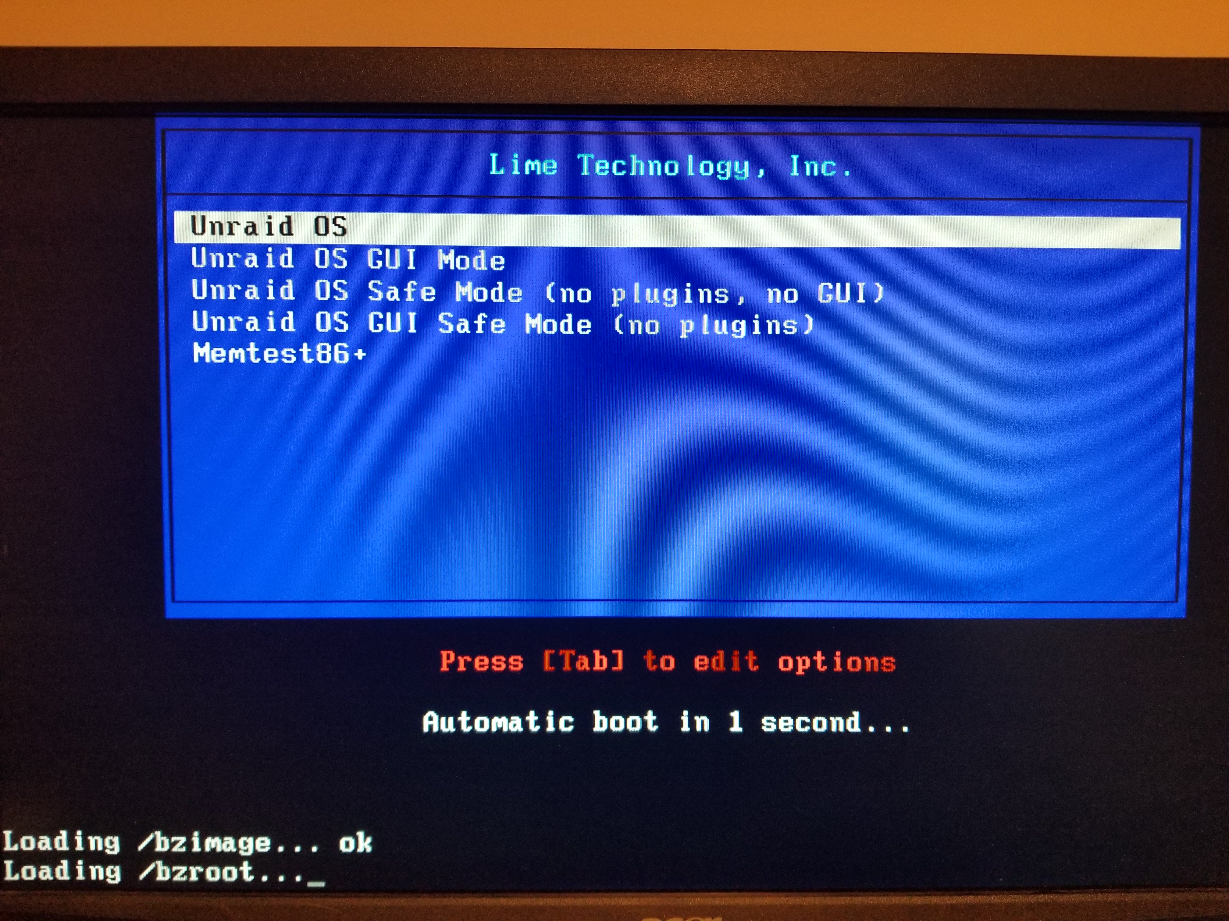

When i boot, i have this and nothing happens next (see picture)
What should I look for?
Thanks

However, I feel it takes longer to boot - It stays on "Loading/bzroot..." for more than 2 minutes before scrolling all the text
Is this normal?
Perhaps there's a problem with the USB port. An old motherboard perhaps doesn't support USB 2. Post your diagnostics. The logging won't start until the kernel has booted but it might reveal something. I haven't tried running Unraid on a server with only 2 GB of RAM recently - it might no longer be enough.

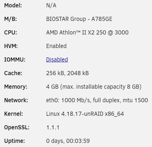

My "new" built has now 4GB and an Athlon X2 II 250 - Previous one (until yesterday) was a Sempron LE 1100 and 2 GB Ram
I'm sure the newest board is USB 2 (but using the headers from the motherboard, not from the back panel)

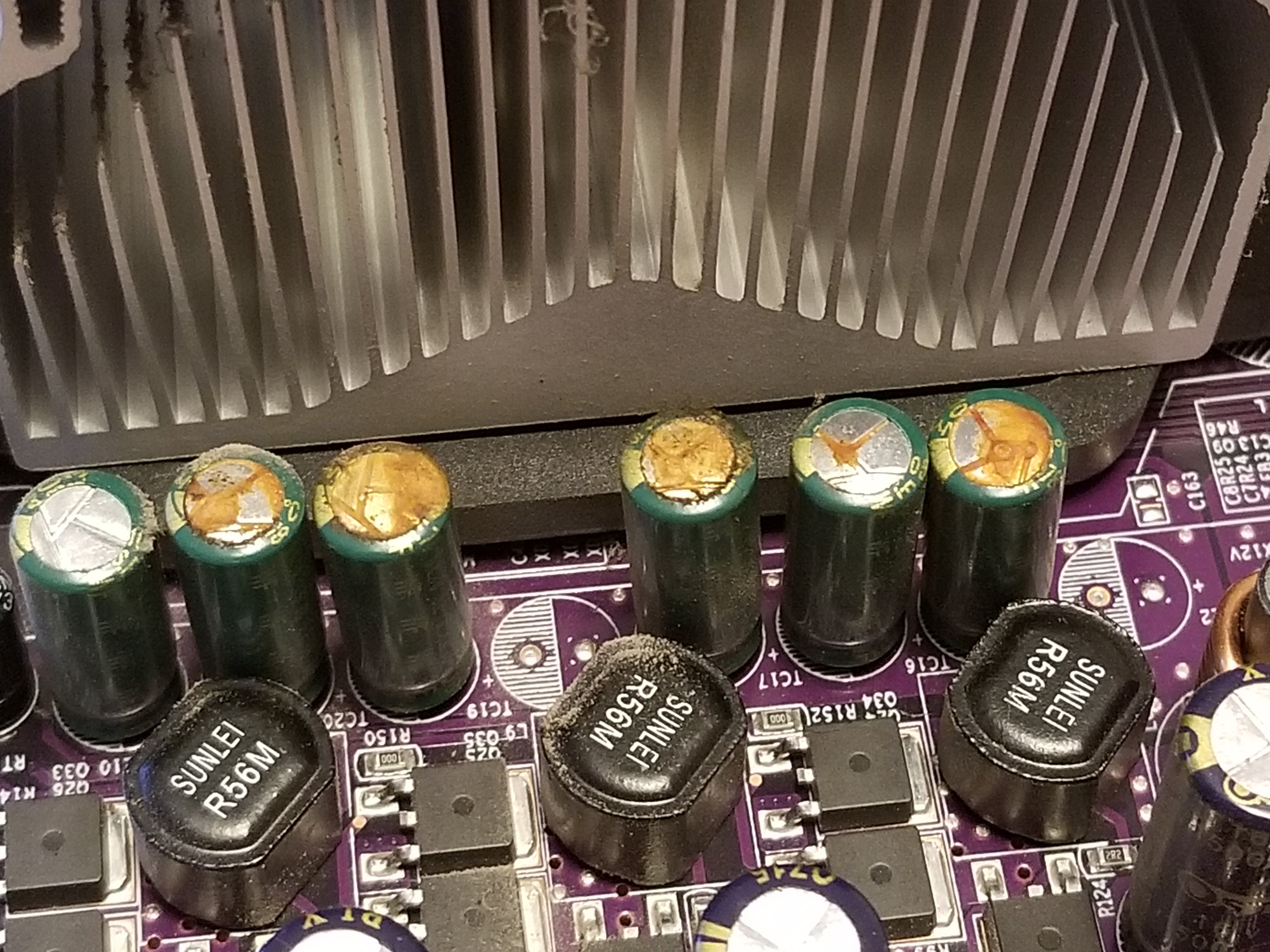

And by the way, here is a picture of the old motherboard that was making this strange noise........It was really time to replace it !!!

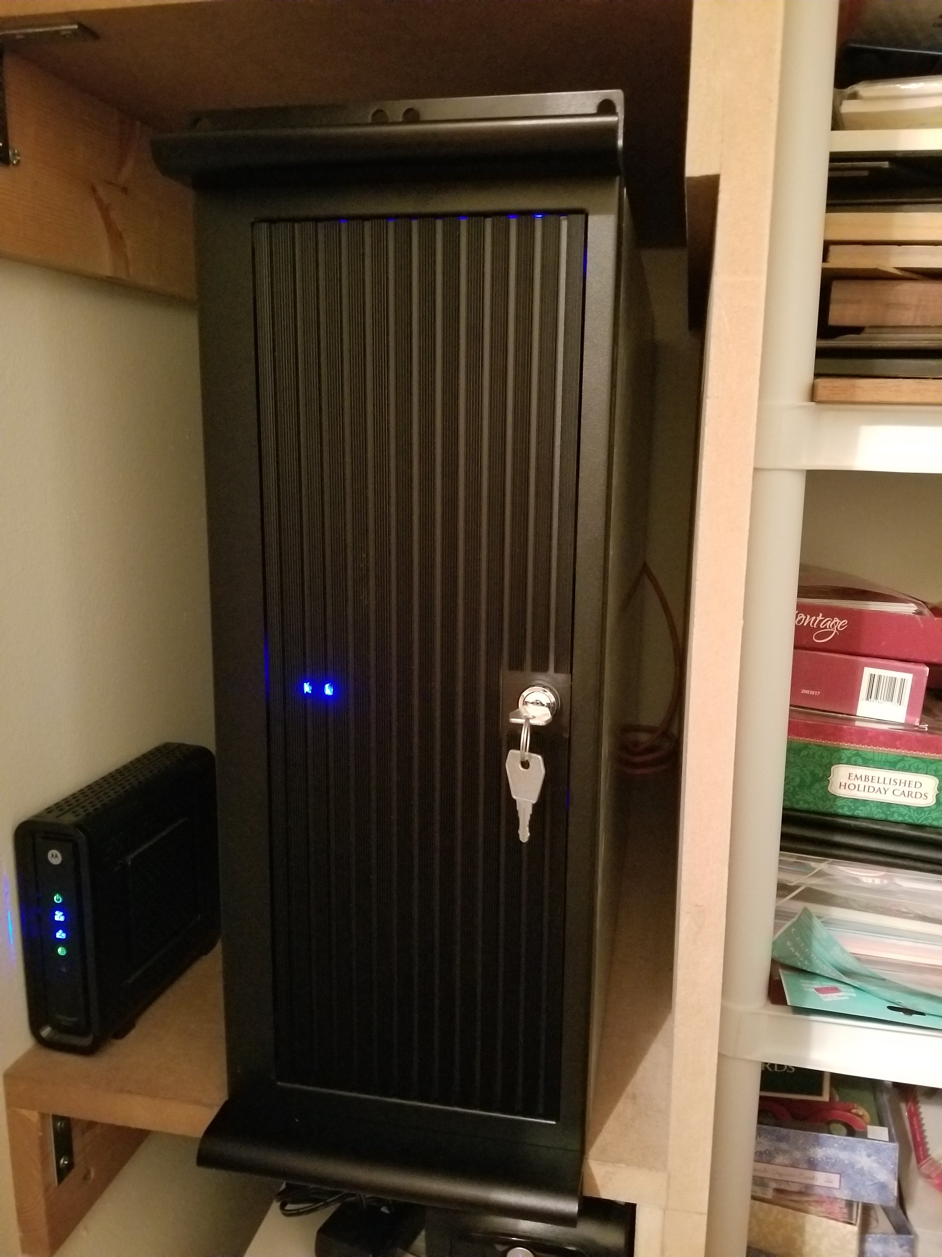

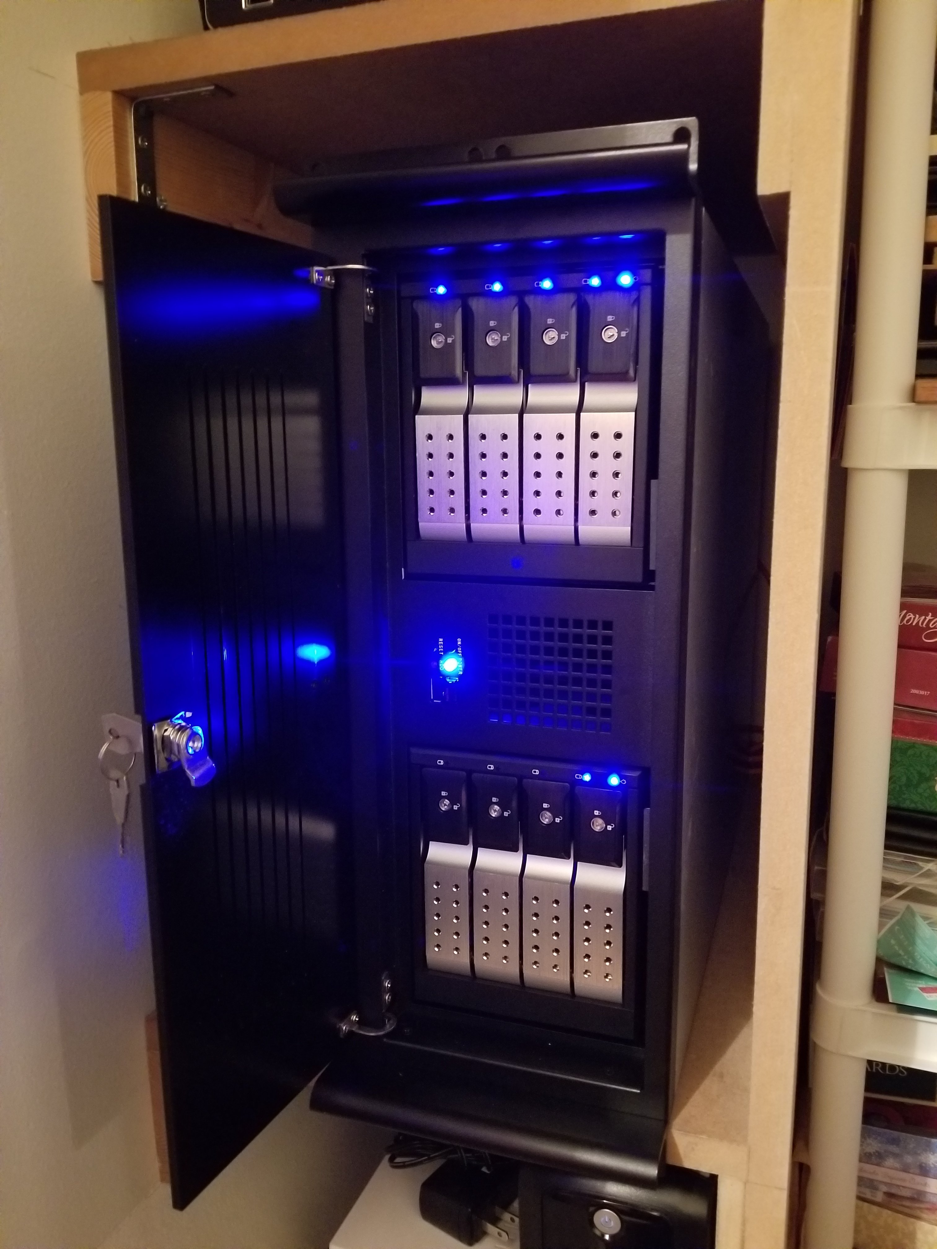

And finally my new case, up and running...
