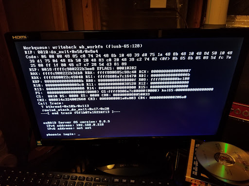

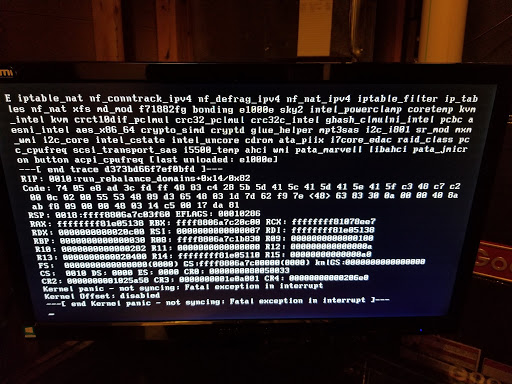

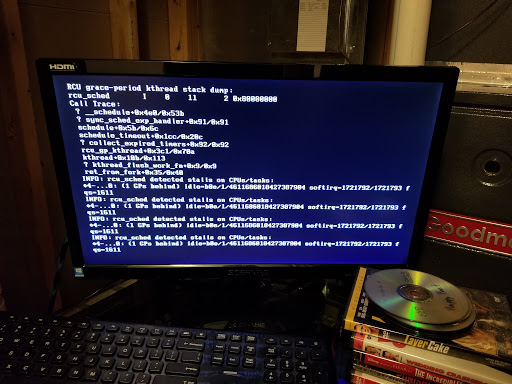

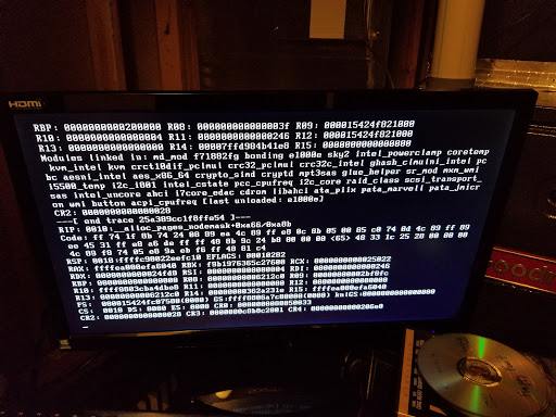

Here are some screen shots of the crashes prior to last night, I'd find the host unresponsive, no keyboard input worked and I couldn't access the web gui forcing me to do a hard reset.
This morning I again found a similar error but this time the system was responsive to both local keyboard input and via the web gui

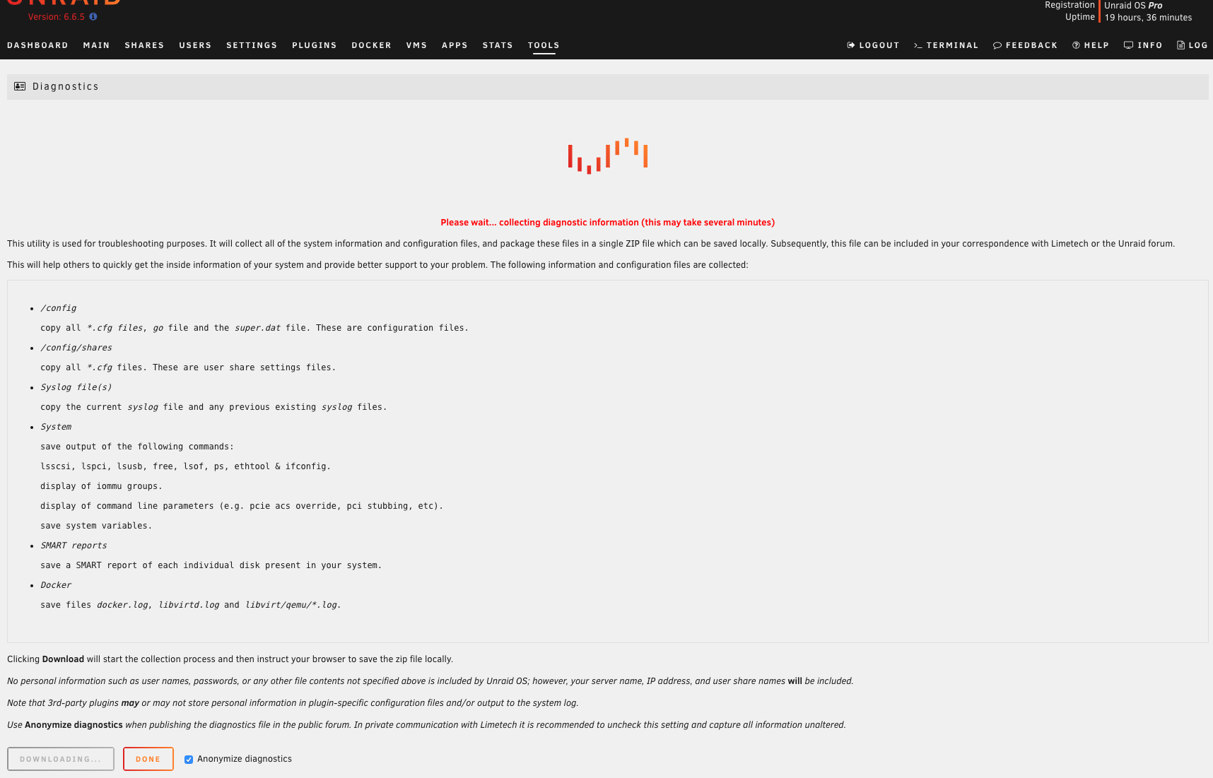

I tried to grab the full diagnostic file but after 40 some odd min the page still hasn't generated the diagnostic file.
When I scp'd the syslog file above down I saw a number of diag .zip files in the same directory but nothing for today, so it appears its failing to generate the diag file not just failing to let me download it via the GUI.

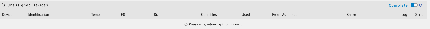

The other oddity I noticed is failure of unassigned devices to finish loading its data on the main page.
