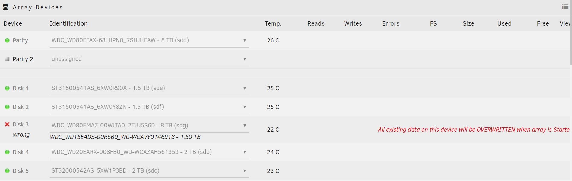

So I've taken out Disk3 and installed instead the new 8TB drive
I've assigned this new drive to Disk3 in the GUI
Then I started the array, and now it says Parity sync/Data-rebuild 0.5%............................So wait and see

3 minutes ago, trurl said:
All of these questions, and your reference to the post where you quoted the wiki about shrinking the array, make me wonder if you actually have a good grasp on exactly what you need to do at this point.
Forget about shrinking the array for now. You need to concentrate on rebuilding disk3. Then when that is done and anything else that needs to be done to make sure you still have your data, then we can talk about removing disk2.
And removing disk2, since it is already empty, will only require you to New Config without that disk and rebuild parity, if shrinking the array is indeed what you want to do. If not, then rebuilding the empty disk2 onto a new disk is also possible.
So, without any reference whatsoever to that "safe method", which is irrelevant, tell us exactly what you intend to do to replace/rebuild disk3 so we can clear up any misunderstandings. Then when that is done we can decide what to do next.
That is right so far.
