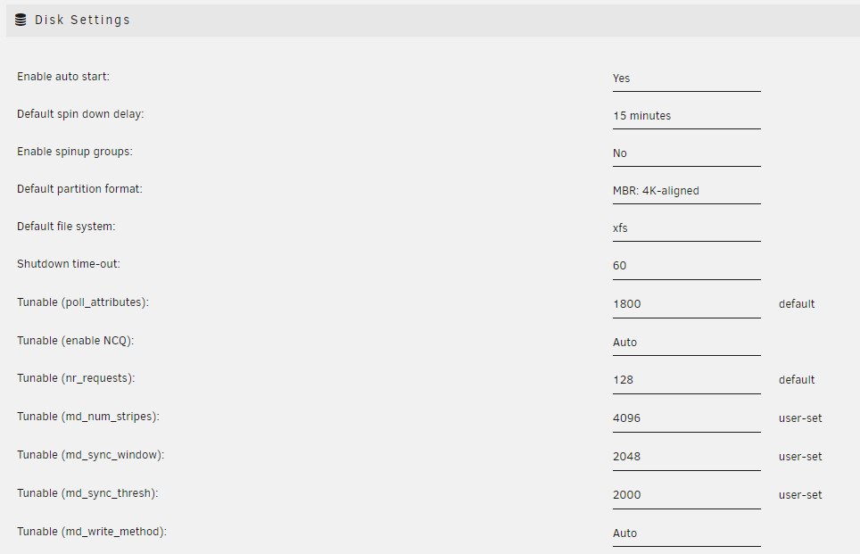

Disk Settings:
Edited by Takedown
Add info for current performance
