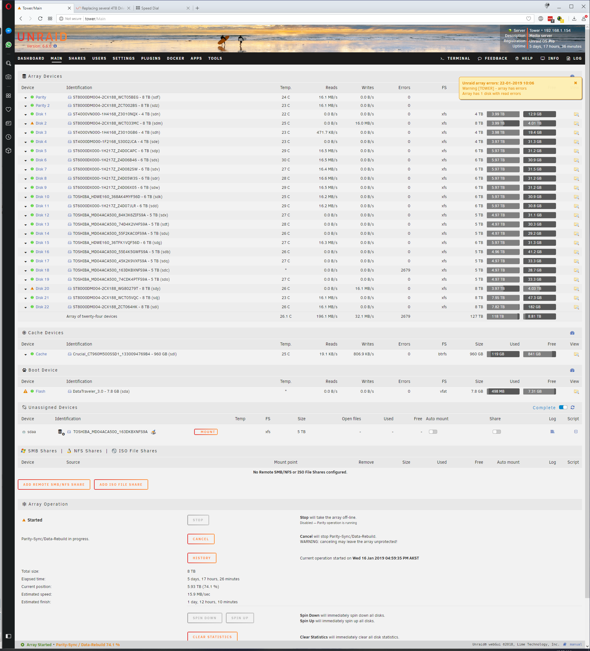

Ok this is really weird.  I got 37 read errors on disk 18 which is toshiba 5tb. And it is increasing - 1797 - started 15 minutes ago.  But I am almost to 6tb in disk rebuild now..   There is no temperature on disk 18 as well.  Perhaps it has shut down?
Since i have 2 8tb parity drives and i have replaced 2 4tbs with 8tb and am rebuilding them, if i were to pull the shut down 5tb out of hot swap and reinsert it would i jeopardize my data? I would assume it would.  This is really confusing.  I am rebuilding zeros from 4.01tb to 8tb on the 2 new drives, so the rebuild is technically done? and they are all zeros because i precleared them prior right?   I have attached another diagnostics that is a few minutes old.  the problem starts at 10:05 1/22/19.  Also attached a screenshot if that helps to show what is happening.
I have 16tb of parity drives (2x8) but if i had 3 drives fail, say a 4tb and 2 5's i would lose data right?  It would seem that normally i would have lost data, if it weren't for the fact that all this is happening past the points on drives that have data? ie if i am at 6tb on a 4tb rebuild to an 8 is my array safe with drives that are currently being rebuilt with zeros on the last half?

Looks like disk 18 dropped offline, but diags are before the errors.
Diagnostics are Fixed in post above - thanks!
Edited by FrozenGamer
Also i just noticed that the 5tb is showing up in unassigned devices, i think i may have updated unassigned devices shortly before the problem, which could have possibly caused it to go offline out of the array?  And it appears that data is missing from the array in its current state - a tv show which was there is no longer there when i go to the array on the network.  This was likely written to disk 18 just prior to the disk rebuild.  Perhaps the increasing errors are from Dynamix Cache Directories refreshing every so often.
additional info.
Disk18 appearing in Unassigned Devices is likely just a result of it disappearing and then coming back. The errors are the result of disk18 dropping, since the rebuild is attempting to read it and every other disk.

You should post diags to confirm rebuilds were not affected, since the ones you posted are before the errors.
Prettty sure I fixed that diagnostics posted a few hours ago?   Should have the errors.  I’m at Crossfit gym and will be home to double  check in few hours.  Thanks for you help!
Yeah, sorry about that, some times the forum "eats" post from the unread list.
Disk dropped offline and came back online with a different identifier, but it didn't affect the rebuild, it wasn't disabled because you already got 2 invalid disks, it will comeback online after a reboot, take the opportunity to check/replace cables.
