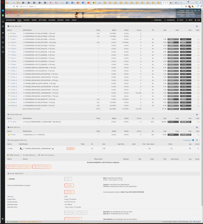

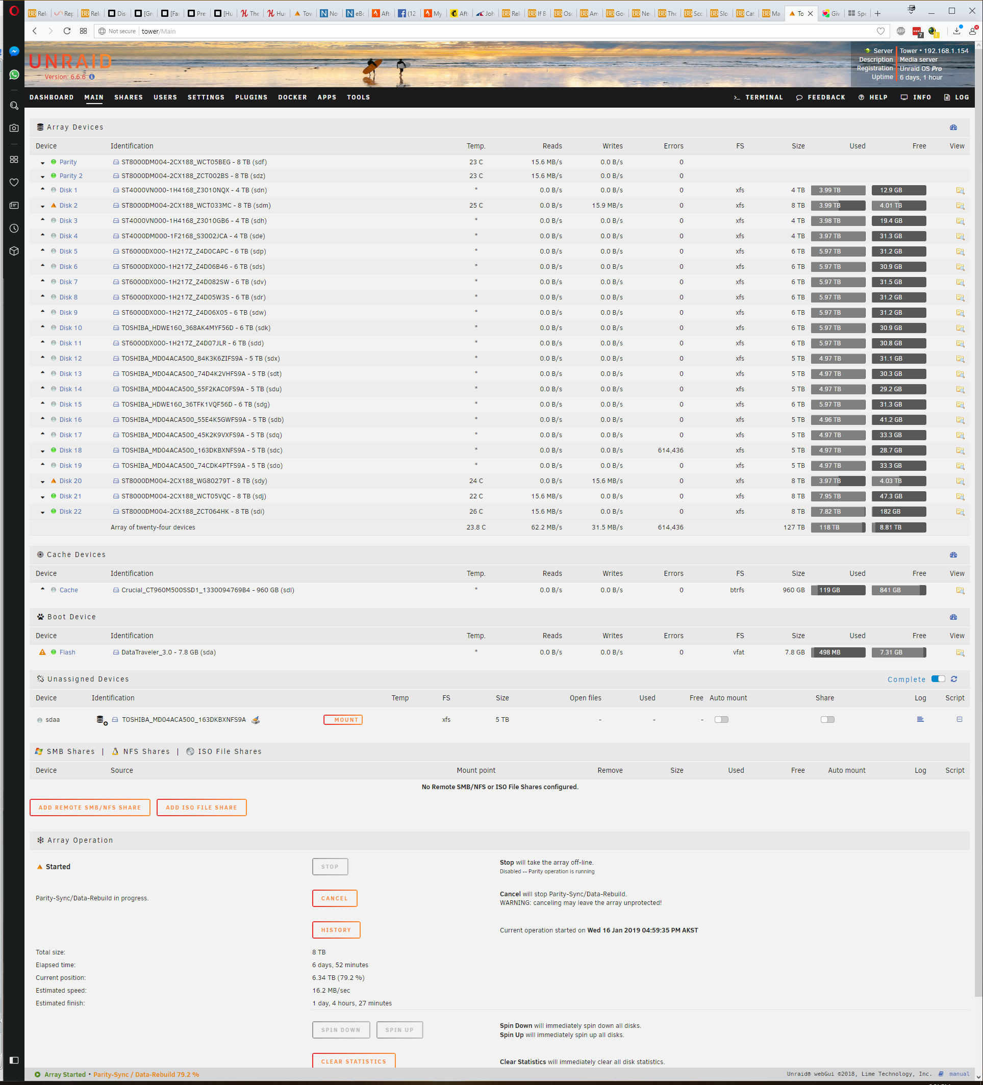

For what its worth turning off Cache Dirs Plugin seems to have stopped the errors and all the drives are spun down that aren't currently being used.  i wonder if the continuous scans could have been a factor in the slowdown spikes.  Seems that there were no slowdowns past 6tb either before i turned off the plugin and that slowdowns continued after 4tb and to some degree after 5tb.
904276566_Screenshot2019-01-2217_51_57.thumb.png.2f83e35d570b12acc973537f98d7bd65.png
