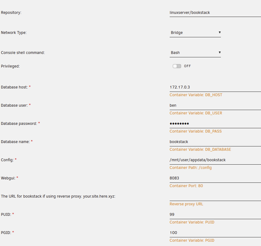

when configuring this container, there seems to be a problem in how the host_db parameter is managed.
I have both mariadb and bookstack in separate containers, bridged.
When I launch bookstack, I use either mariadb or linuxserver/mariadb as the database address. Unfortuntely does not work.
When I put in the actual ip address given by docker (172.xx.xx.xx), then works fine.
Unfortunately this is not supportable, as these numbers will change when bringing up/down the server.

@bucky2076 you might need to try your `<IP>:<PORT>` as the value for `DB_HOST`.
I tried this again... and it worked after a fashion. I used my top level ip instead of the container ip for the DB.
Interesting though when I appended the port number to the IP, it barfed.
I simply added a new variable for DB_PORT and it liked that better... despite what the documentation said.
Not very container friendly at this stage... but it worked !

This config actually works... because of the following:
  • .env is ignored if overidden with params...
  • DB_USER in template replaced with USERNAME
  • DB_PASS changed to PASSWORD
  • DB_PORT was added
Would be better if it accepted the host as the container name rather than the ip.
  • DB_PORT was added
The default bridge doesn't support DNS resolving, so you can't use the name of the container as the host for the database. This has nothing to do with the containers. So you have to use the unraid IP in DB_HOST.
You can make a custom bridge to use the container name in DB_HOST, but it doesn't really matter if you use the name or the IP as it works both ways.
Is 192.168.1.254 the IP of unraid?
oh thanks I did not realise that about unraid docker.... I have done some docker stuff in a normal linux host, and the docker networking is quite sophisticated. You would simply use the name of the docker rather than its internal IP. You also have the opportunity to manage your own networking so that you can split your backend from your foreground tasks across different network subnets (sql database, versus web server hosts).
I did obscure a few things in the above post for obvious reasons... Name/PW and such. My server IP internally is actually 192.168.92.254, so there you go.
I am ok using the host IP since that dosen't change. The 172.xx.xx.x.. ip changes each time you present a different order during startup.
I did leave a message on bookstack issues section (git) suggesting the parameters need some attention.
Thanks again for the chat... hopefully this will help the next newbie...

What do you mean with the parameters need some attention?
simply the template variables are misleading, causing some confusion. Also, the port assignment did not work when adding port to host name., I had to break this out to its on env var.
The .env provides the proper name for these variables.
What exactly is misleading?
I don't see anything misleading and they are pretty clear in my opinion.
You can specify the database port as a variable and set it that way. Most people use the standard port.
We don't add every option available in the application in the template as we can't foresee all the different options. Usually there are documentation that the user can look up themselves, as now. A quick Google search will find the way to set the database port.
Neither me or the template told you to set the port in the DB_HOST variable.

saarg,
the basic unraid template did not work for me, and I had to tear my hair out.
  • DB_USER variable was incorrect. Needed to be DB_USERNAME
  • Same issue for DB_PASS
  • Passing IP/Port did not work for me on the DB_HOST
/usr/local/emhttp/plugins/dynamix.docker.manager/scripts/docker run -d --name='bookstack' --net='bridge' -e TZ="Australia/Sydney" -e HOST_OS="Unraid" -e 'DB_HOST'='192.168.92.254' -e 'DB_USERNAME'='ben' -e 'DB_PASSWORD'='xyz' -e 'DB_DATABASE'='bookstack' -e 'APP_URL'='' -e 'PUID'='99' -e 'PGID'='100' -e 'DB_PORT'='3306' -p '8083:80/tcp' -v '/mnt/user/appdata/bookstack':'/config':'rw' 'linuxserver/bookstack'
