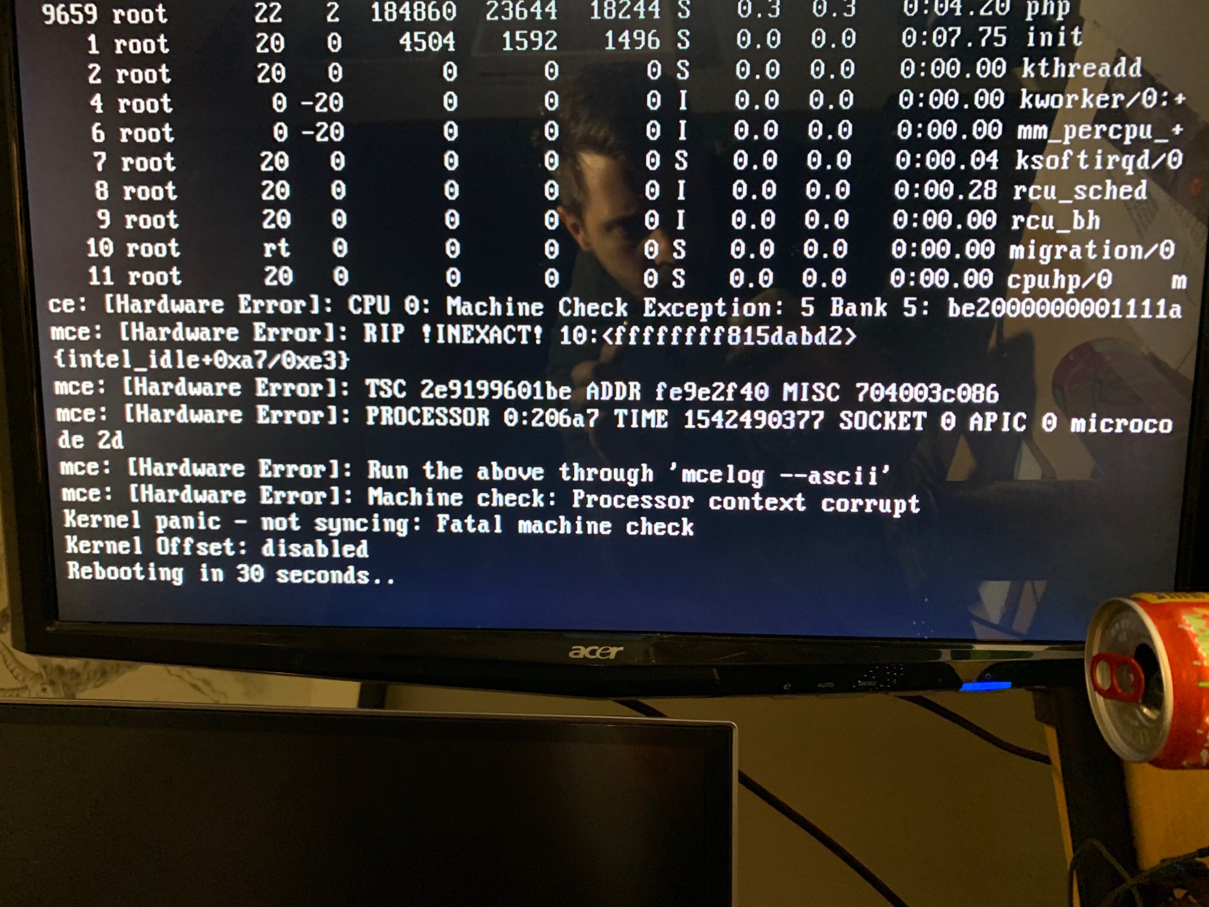

I've seen similar topics on the forum so sorry if I'm not understanding things properly. Within ~10 minutes of my server starting & the array starting it dies with a Machine Check Exception:
I'm not able to type anything at this point as the kernel has panic'd. Similarly, I see no reasonable information in a syslog. Lastly, /var/log/mcelog doesn't exist at next reset reset, I assume because it's not persisted across resets. I have no idea how to actually run this through mcelog.

try this during the brief period you can
mcelog --syslog --daemon
tail -f /var/log/syslog > /boot/syslog.txt
then wait for the system to crash..  After that, upload syslog.txt in the root of the flashdrive
Alrighty, I just did it.
When I ran `mcelog --syslog --daemon` it produced the below in the logs.
'Nov 21 07:00:57 Tower mcelog: Cannot open `/dev/mcelog': No such file or directory'
syslog.txt
The server also went down at roughly 07:10 (there are no recent logs around that time). Let me know what more I need to do.
Edited by yousillygoose
Since my last post, I also swapped the PSU but it's still panicking. My MOBO Bios is really old so I think I'll try to flash it. After that, I'm entirely at a loss. Hopefully someone can assist in getting a useable log which points to the issue.
I've updated the BIOS (z68 board) and it has been stable for a bit over a day. I'm still using a different PSU and only 1 DIMM so I'll start adding back in original components to make sure it remains stable.
