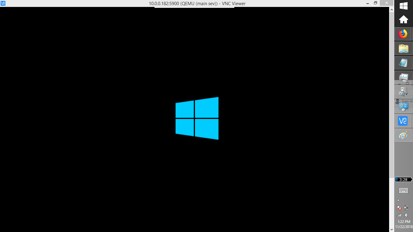

i have been trying to install windows server 2012r2 standard as a second vm, but the installer keeps crashing on the windows logo. this happens on all versions of windows after windows 7 /server 2008r2.

no dice with the driver, and the image is actually from microsoft,  just renamed so i can keep track of it. the regular named version didn't work either.
