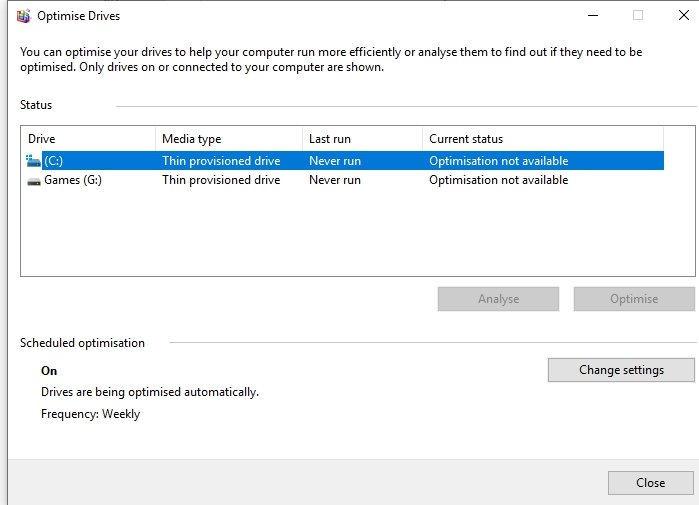

I can't for the life of me see why as I've done this loads of times using @johnnie.black guide.
What's strange about all 3 VMs is that in Windows it says 'Optimisation not available', even for the drive that seems to be ok, although I can't be confident that space will be recovered in the future.
Any ideas how to fix?  Thanks in advance.

Vdisks are already being detected as thin provisioned devices, so that part is OK, don't know why optimization is not available, but you can "resparsify" the large vdisks for now, and unmap should keep smaller for the future, to resparsify (with VMs shutdown):
cp --sparse=always original.vdisk new.vdisk
Then delete the original and rename new one to old name.
Thanks!  I've just completed this and I've gone from 16GB free to 106GB free on a 256GB drive - excellent.

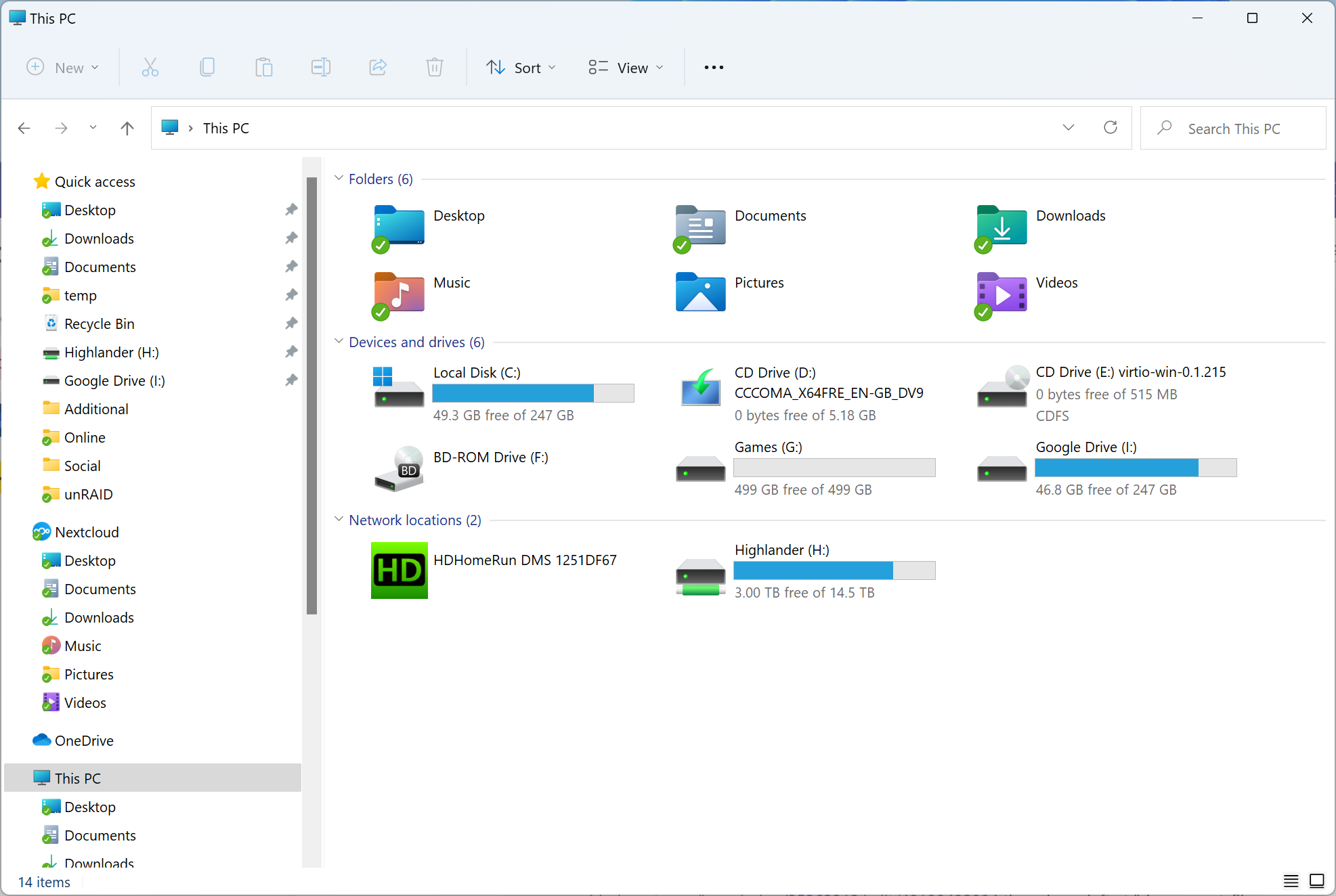

I'm resurrecting this old post as I'm having problems with thin provisioning on my new W11 VM.

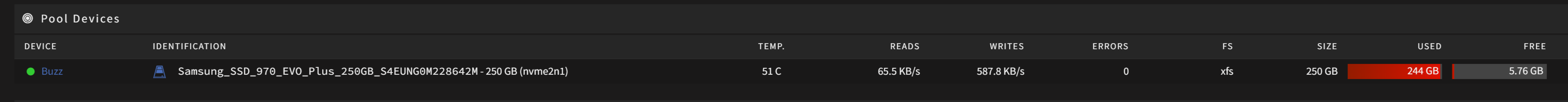

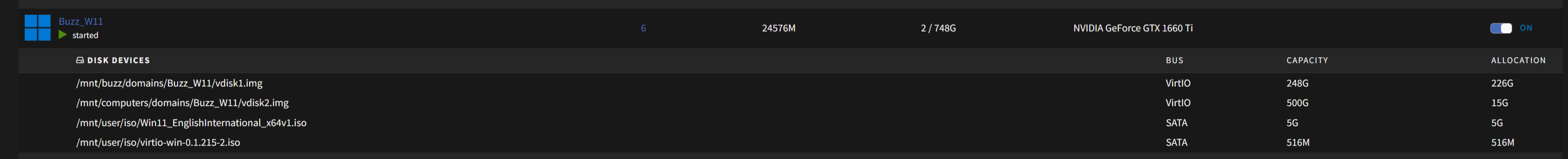

The main vdisk is the only thing on my Buzz hdd which is showing only 5.76GB free, even though on the VM tab it says 226GB of 248GB allocated.  This is despite Windows saying there is 49GB free.
I've used the sparse command above which has always worked for me, but seems to be failing me now.  Are there any other things I can try?
Thanks in advance.
VM page uses binary units, rest of the GUI uses SI units, 226GiB is 243GB so it looks about right.
thanks for replying.
But in Windows it only says about 200GB used - shouldn't it "recover" the other 26GB?
ahh, I'd forgotten this step - solved.  Thanks
