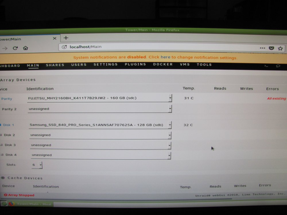

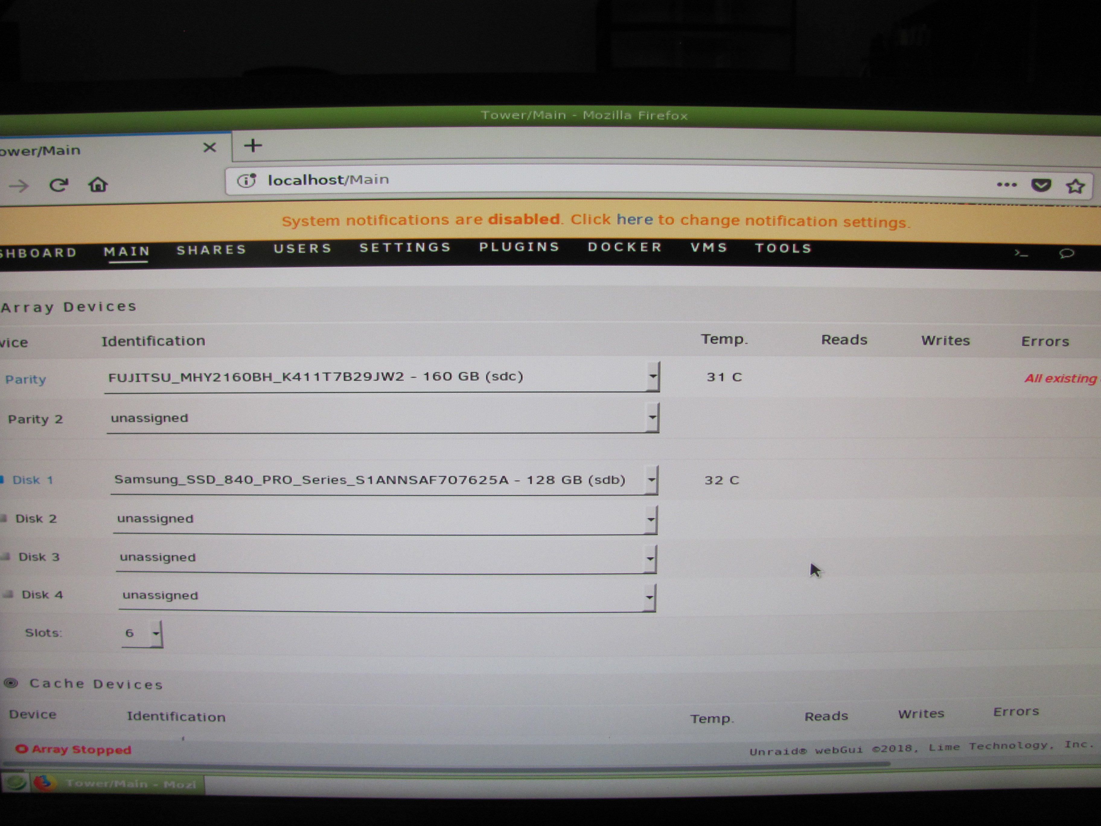

I have installed UnRaid, and build an array with 160gb hd as parity and 128gb as drive one. I have downloaded windows ISO, and VirtIO ISO into UnRaid array's ISO folder.

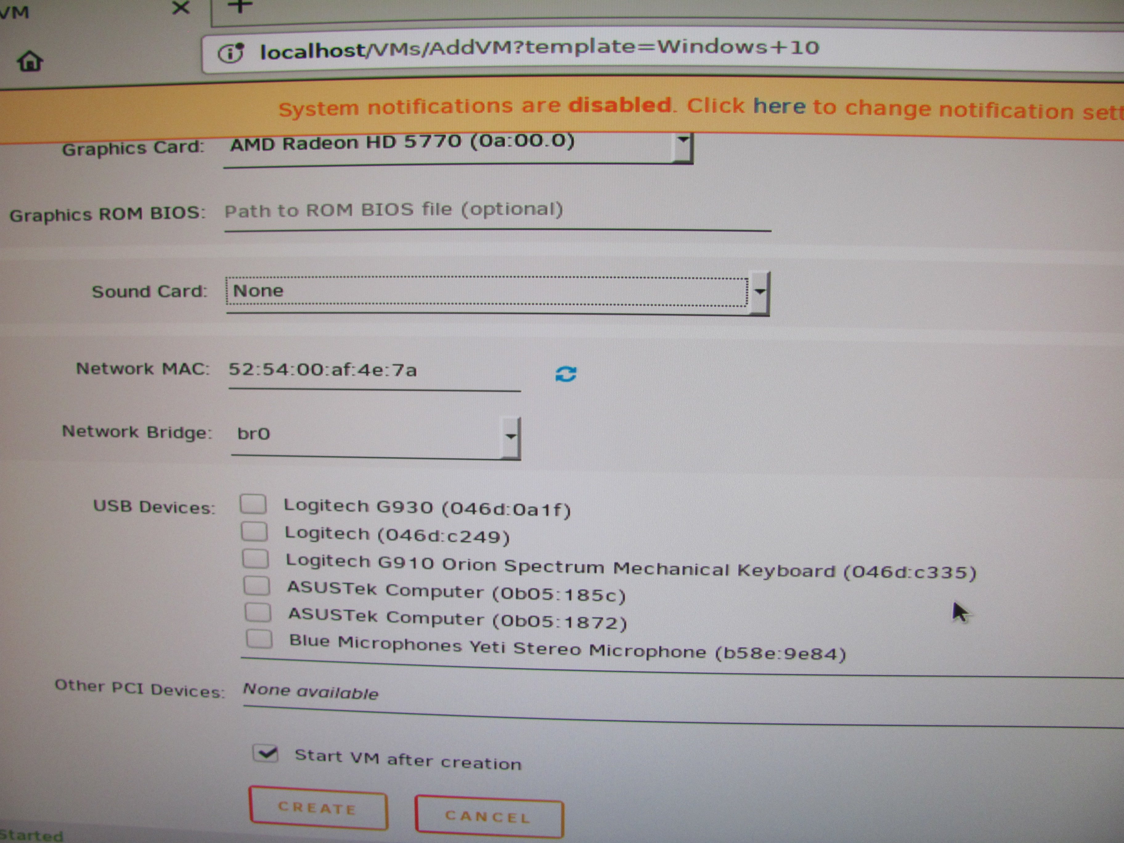

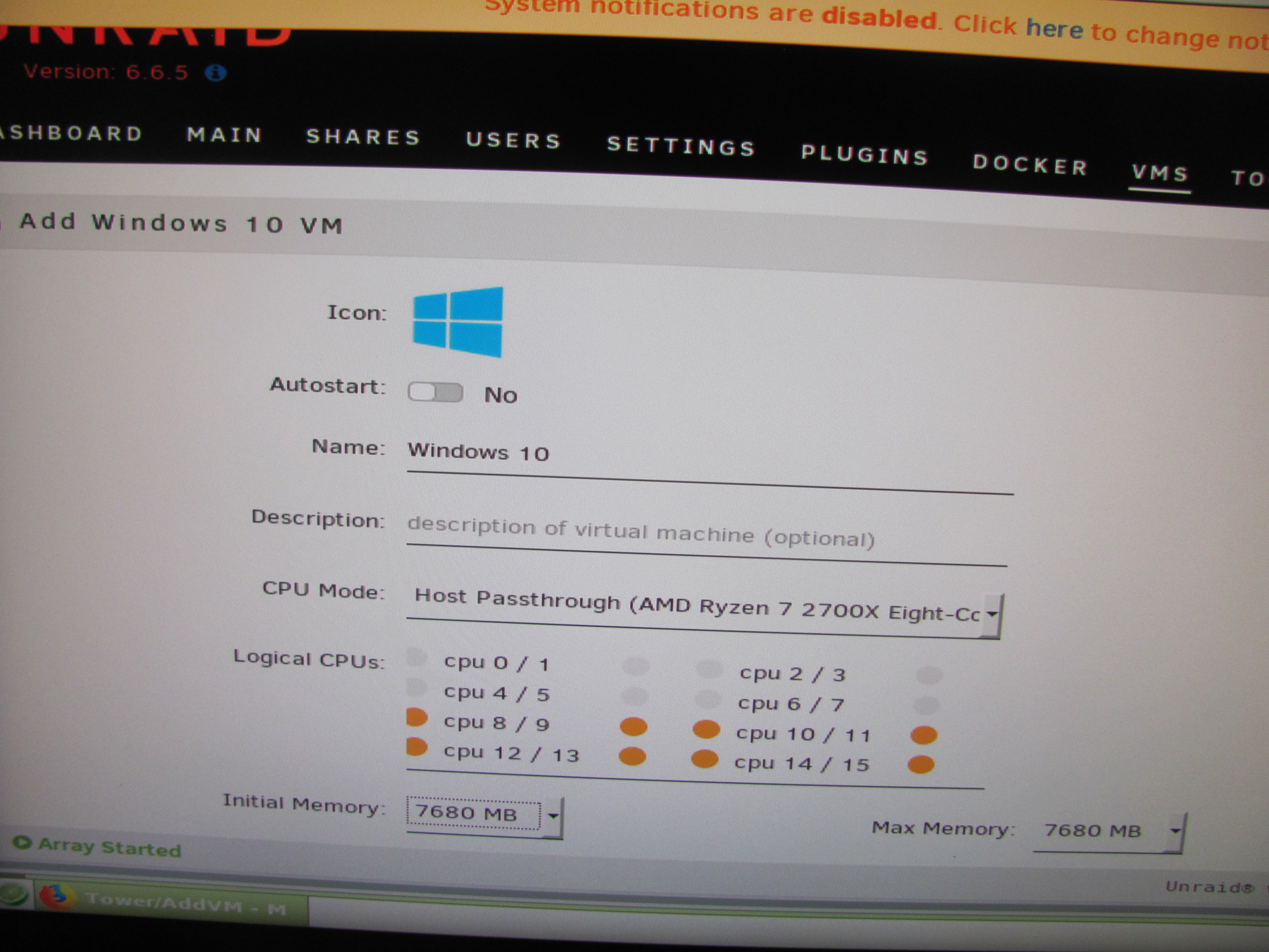

Switching to monitor this forum on laptop now, rebooting onto the USB stick loaded with UNRAID and starting array.  I have installed the MSI 5770 HAWK into pci slot 2, and will try to get a VM to work onto a 1080p screen.

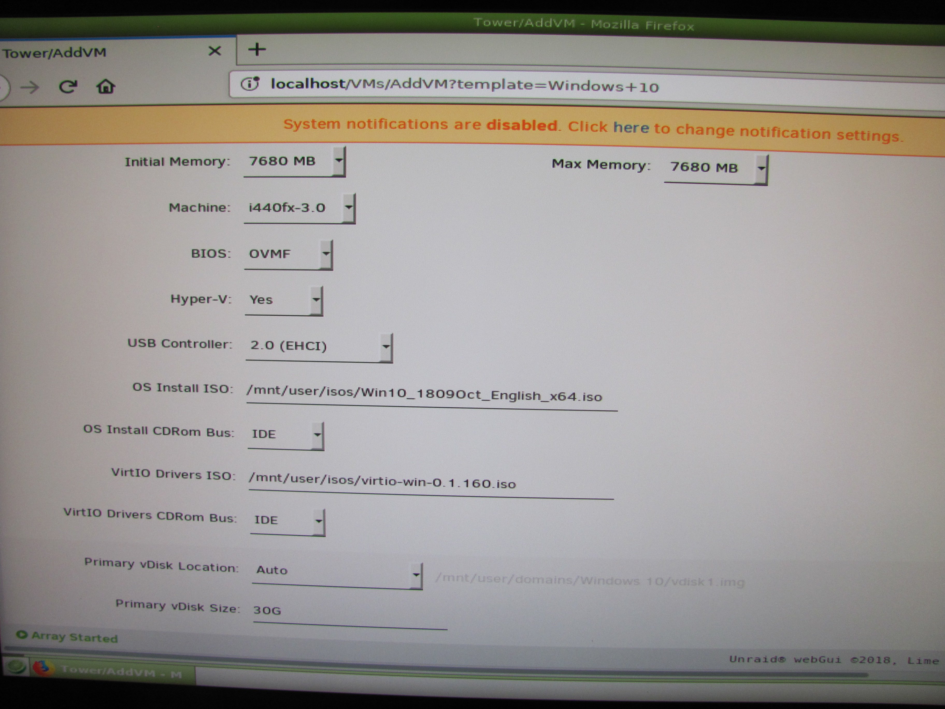

I will be trying to install with 1 CPU and 30gb vdisk onto the array.  I do have a new clean install of windows 10 on this new SSD that is not a part of the Array, If there is a way that UNRAID can just be a tool to boot multiple VMs onto their own hard drives with windows 10 installed on them that seems the easiest.
Will post pictures of progress soon.

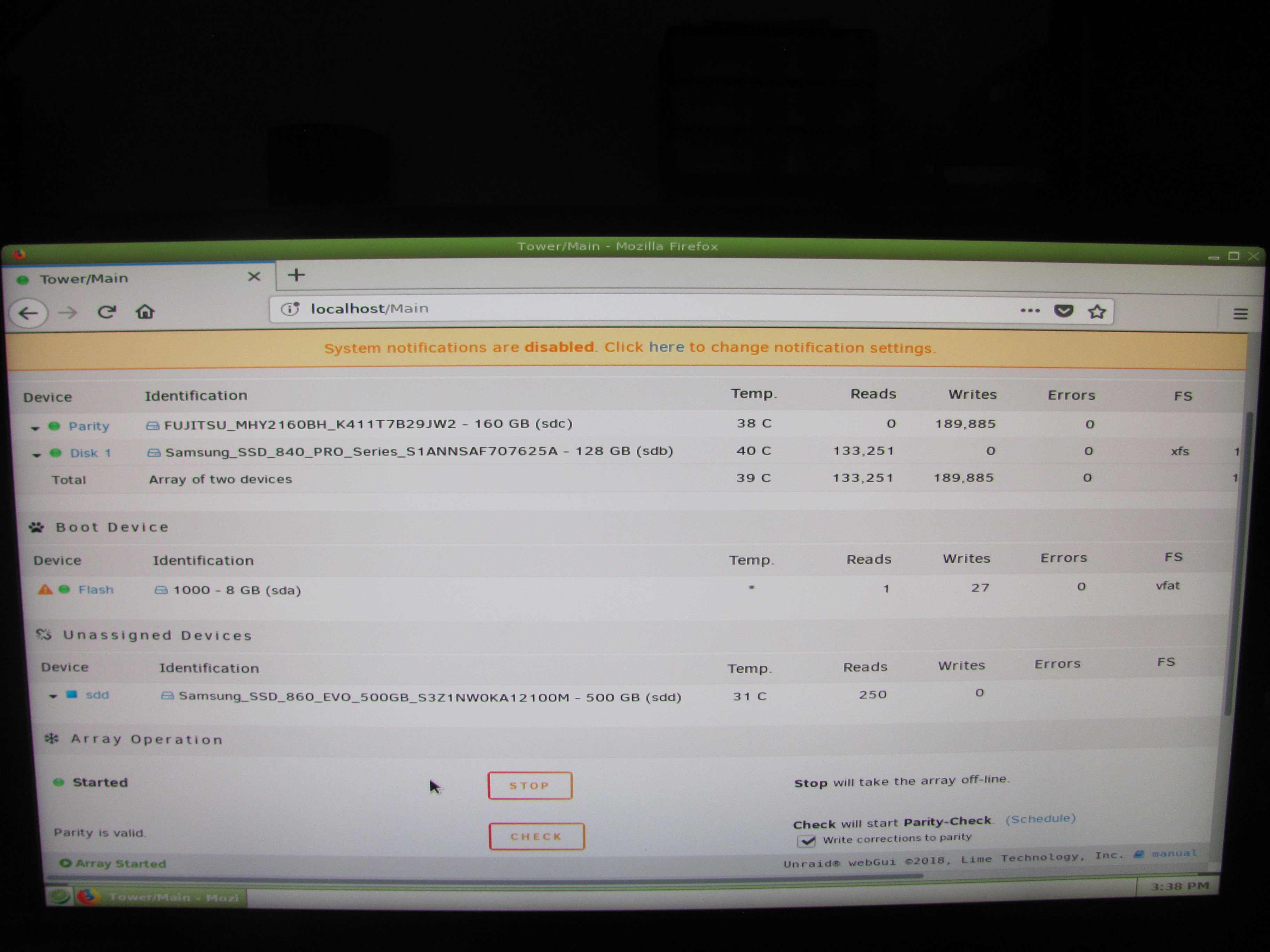

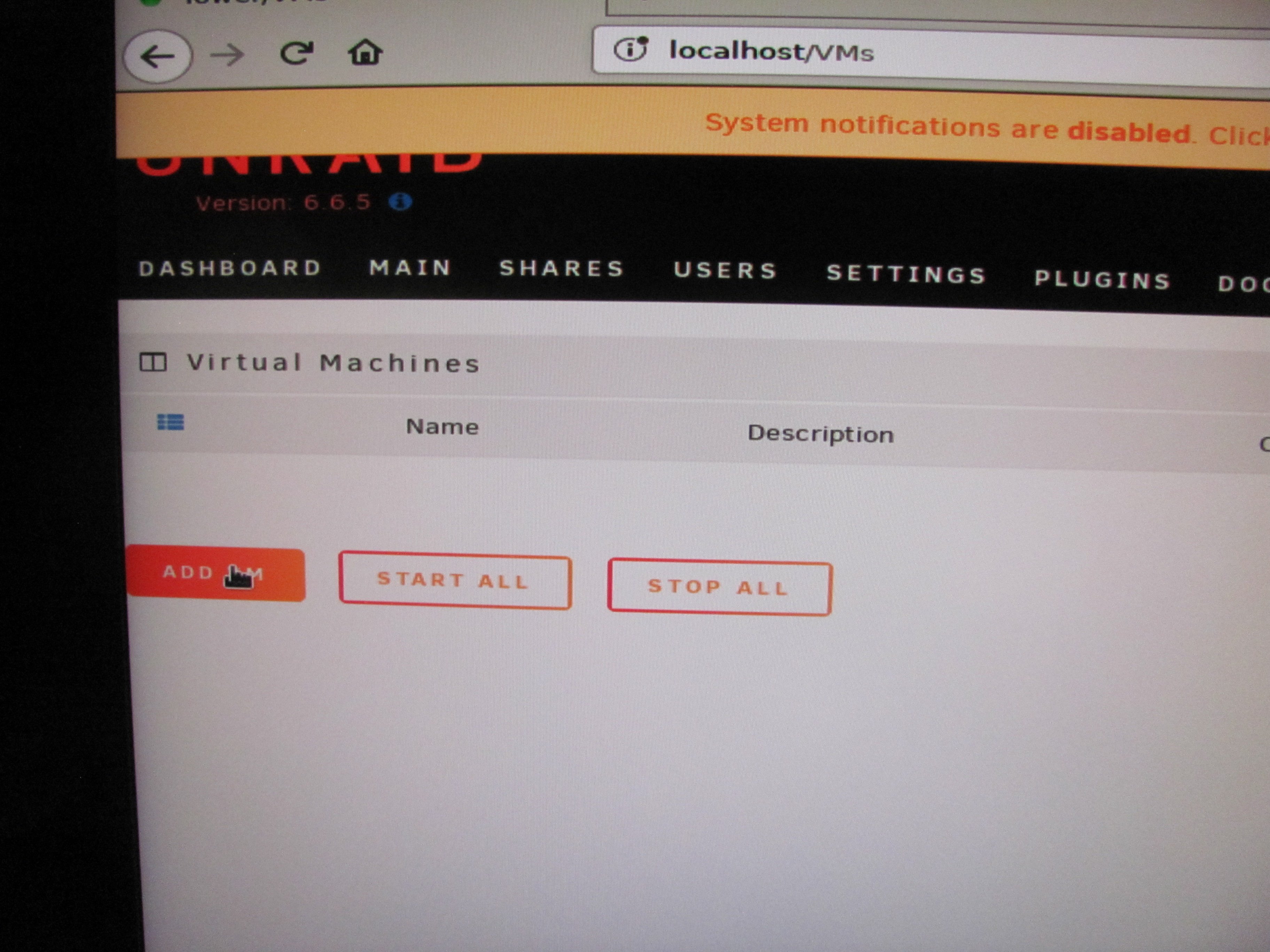

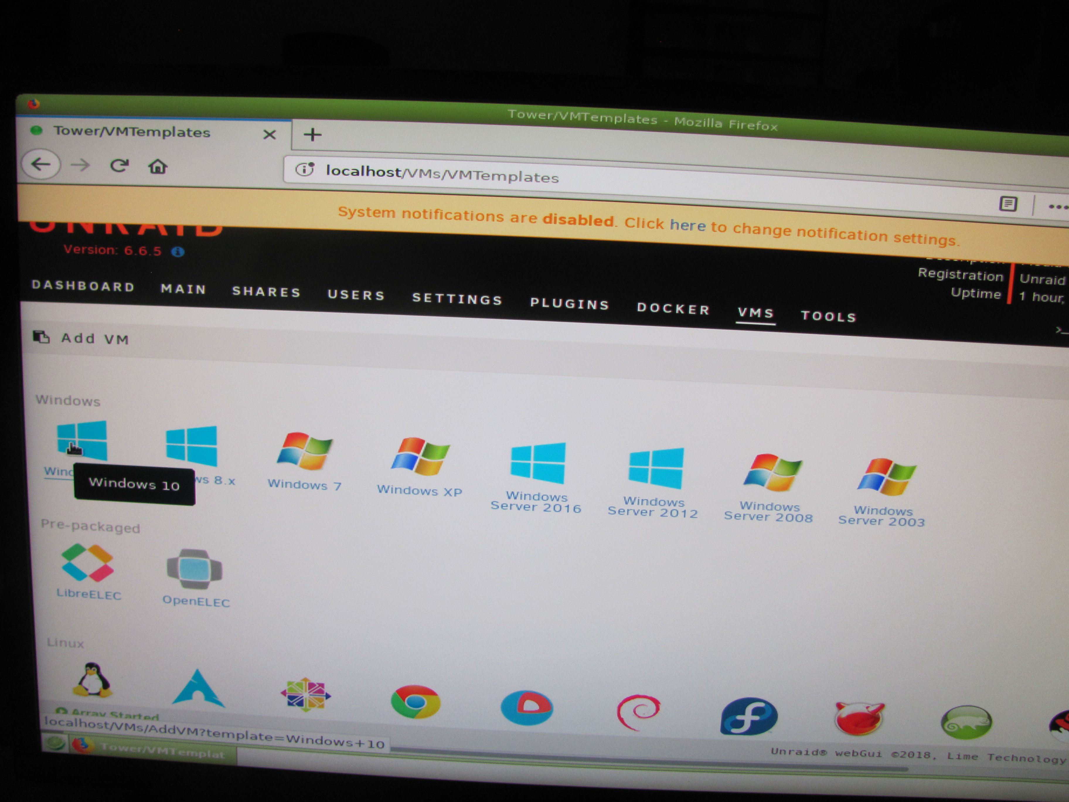

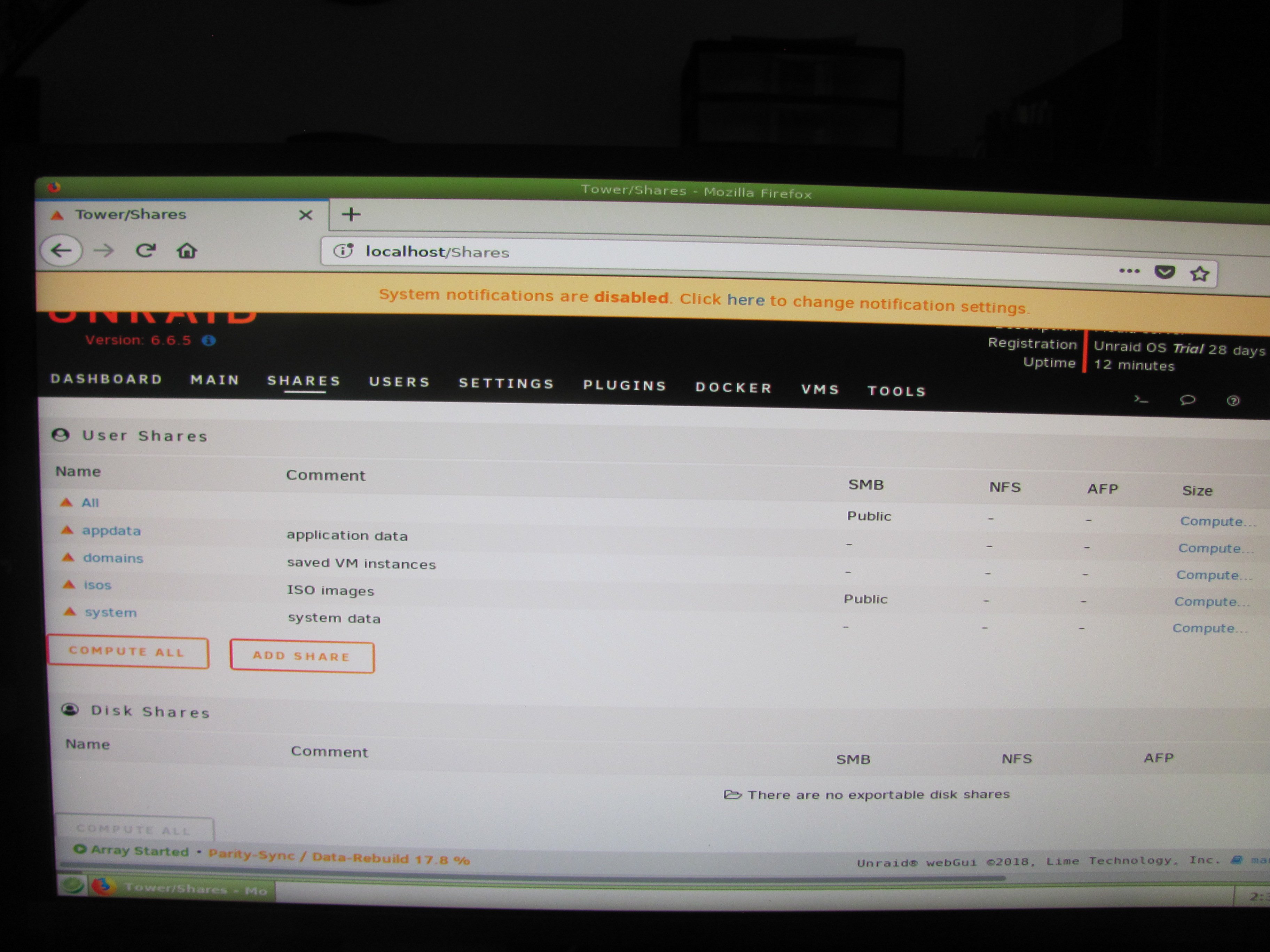

Ok this might be a lot but hopefully it will help me and other people, I have watched hours of videos and still cant comprehend something or idk.
Logging every step via camera.
Starting a new array, I have booted from a USB stick, and I logged into UnRaid with the local gui as username: root   pw: (blank)
I have a 500gb SSD that has windows 10 installed as well, I did not add this to the array.

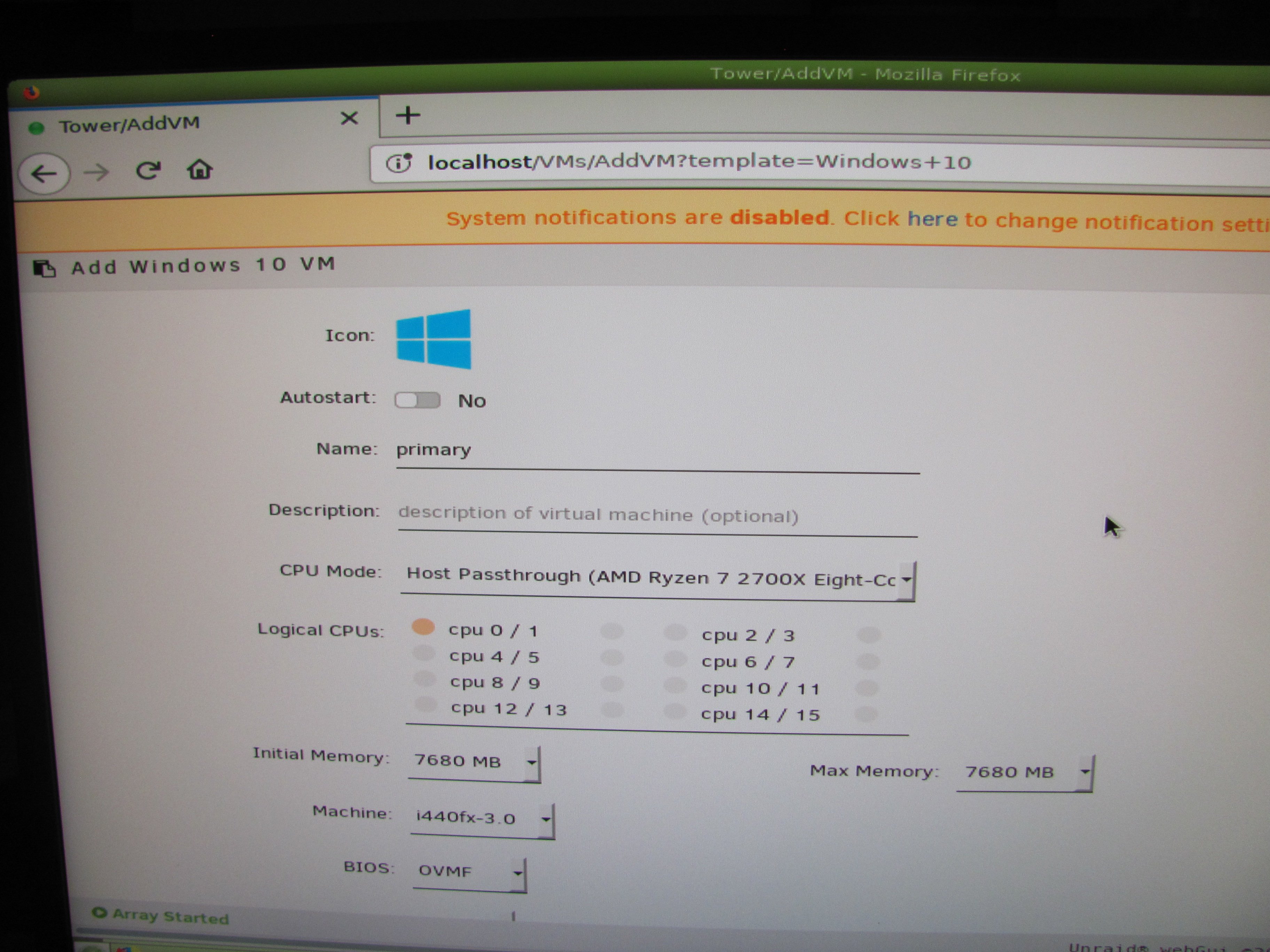

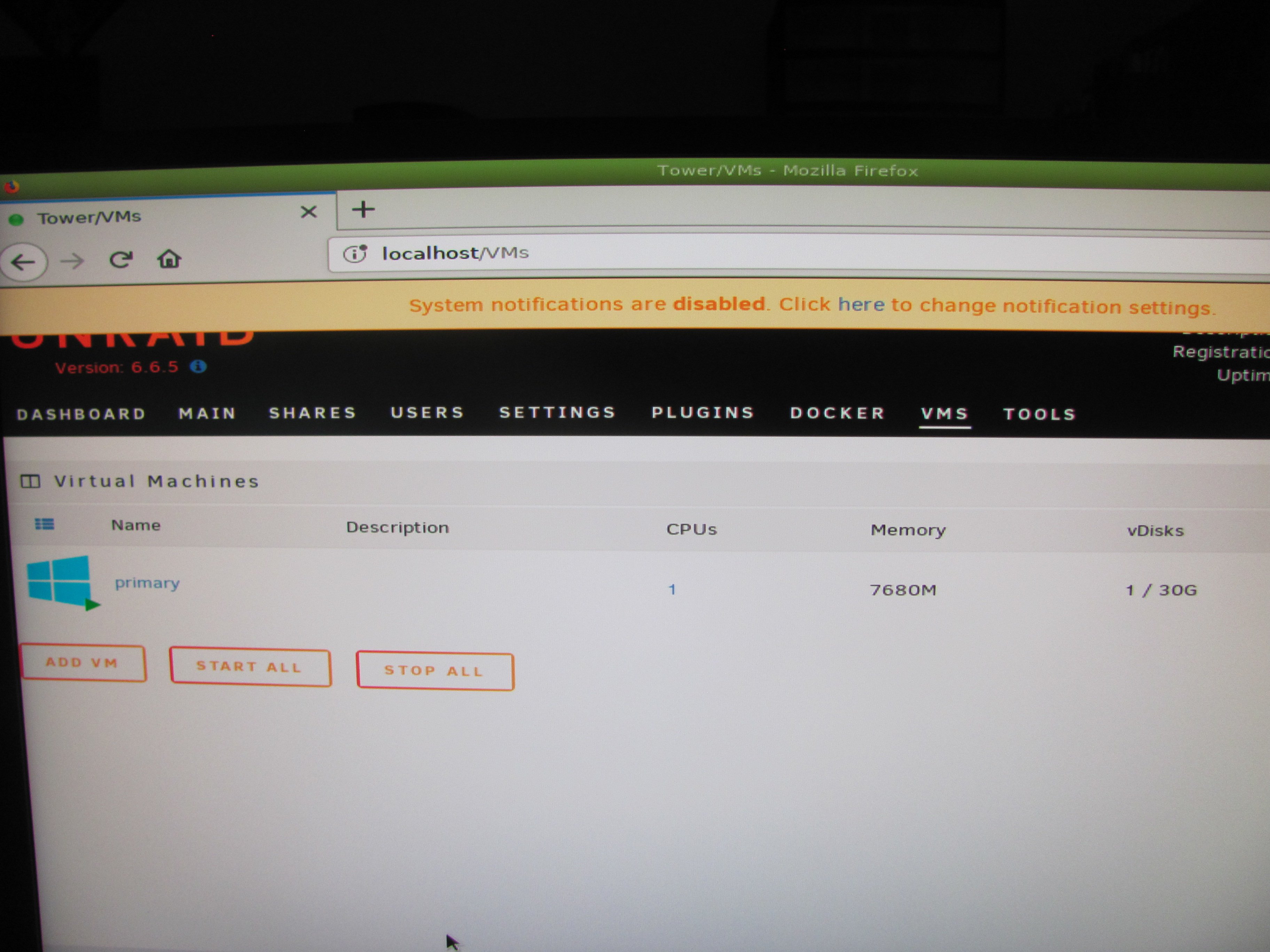

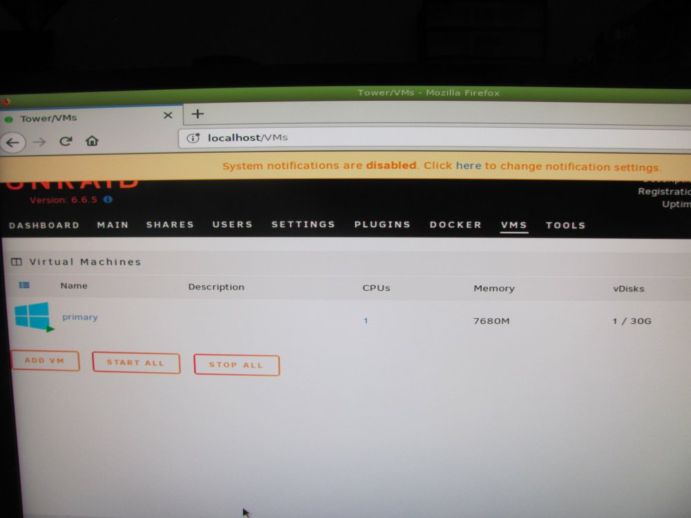

How far did you get with creating a VM? I have yet to see screendumps of a created VM under the tab "VMs"

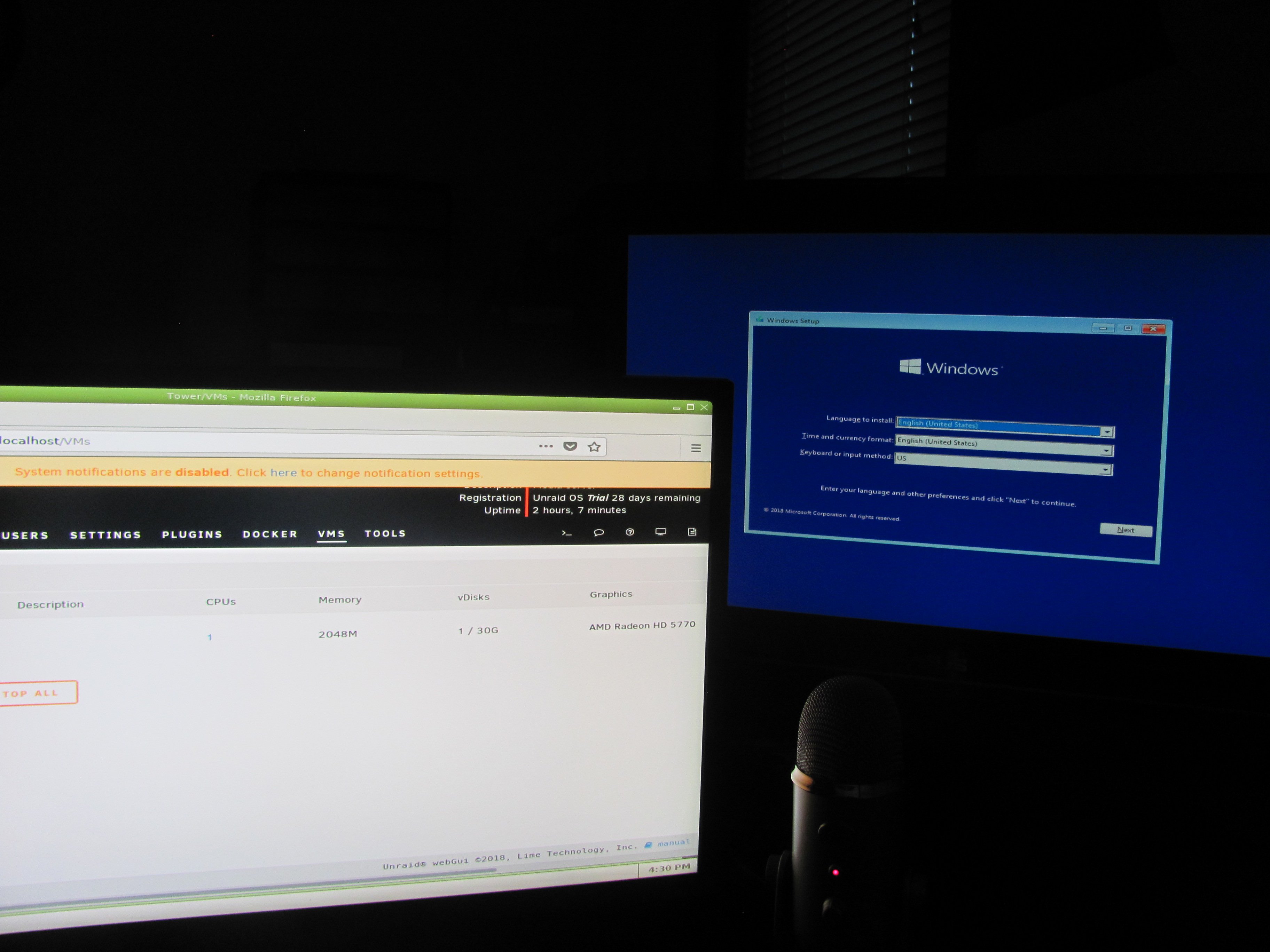

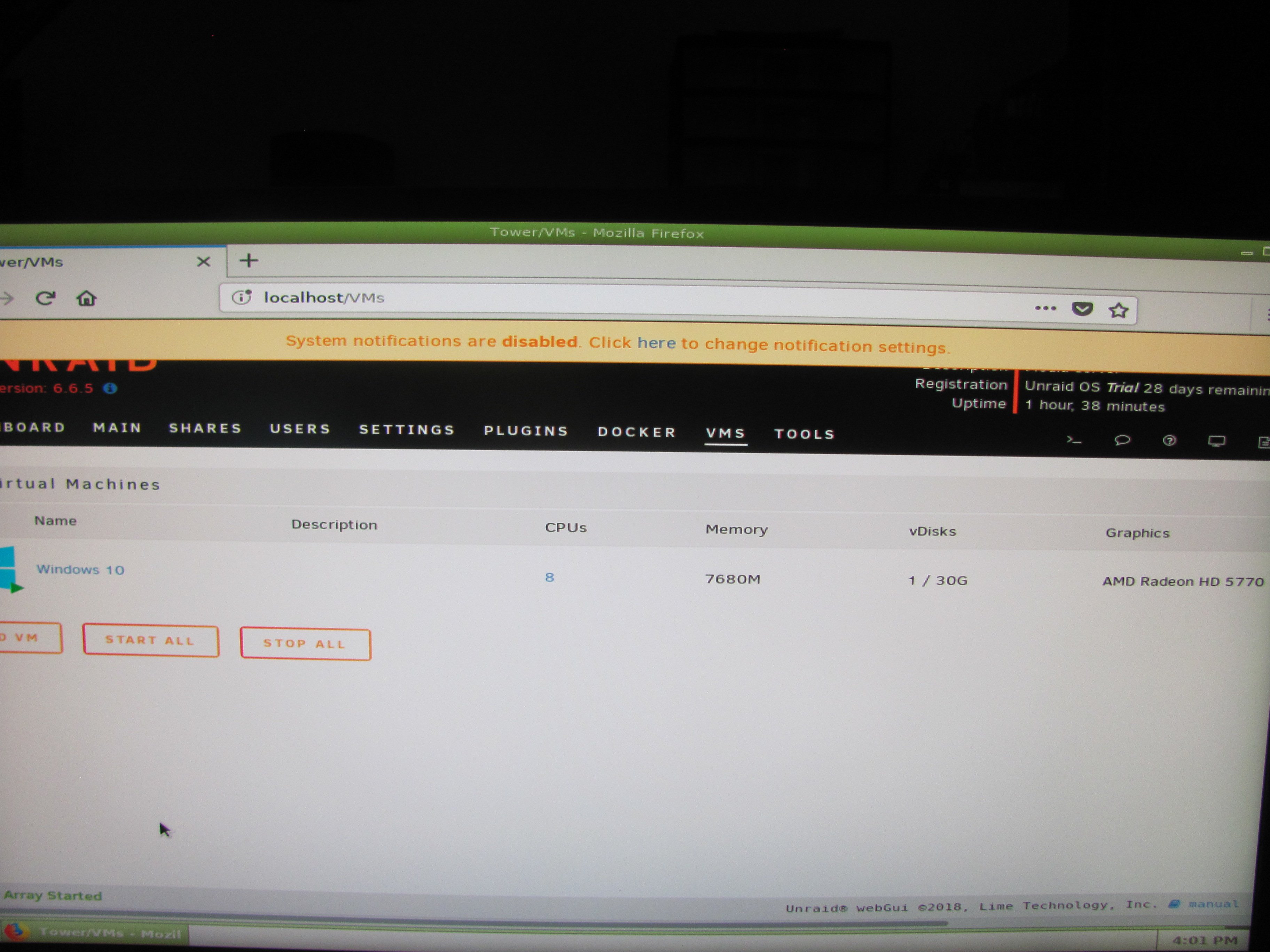

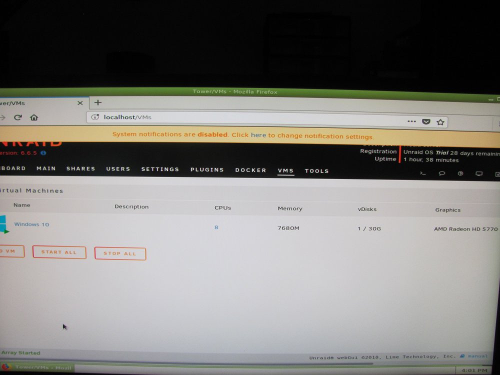

I have no picture coming out the second screen, it says it is running, this is as far as I have gotten, cannot seem to get to windows install.
also a side note, if I try to stop the VM in the UnRaid GUI, it doesnt stop.  I have to use Force Stop to edit any settings.
Ah, it seems you are trying to pass through your primary graphics card? Guess you only have one GPU in your system? :)
If this is the case, try giving the following video a look:
There's also a lot of search results on google for "unraid passthrough primary gpu"

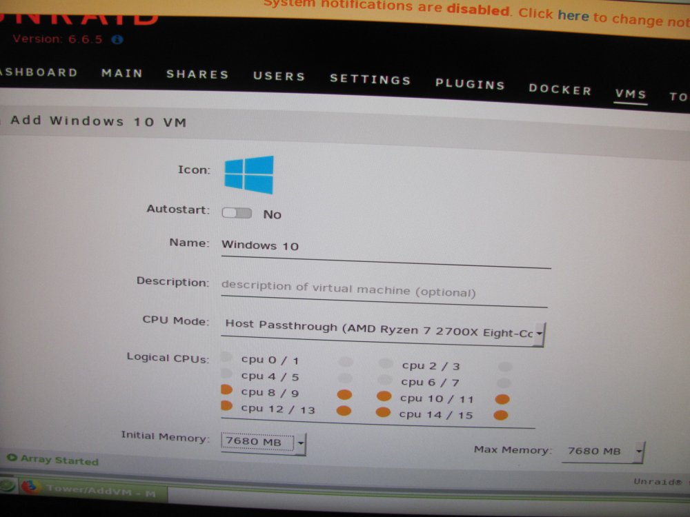

A quick note about pinning your CPU cores to the VM.
1. Unraid OS want to play with the first cores it seems, this is the pair 0/1. Two cores should be enough for UnRaid OS.
2. If possible bin the logical and virtual cores in pairs. That is 0/1, and 2/3 etc.
Space Invader One has more about this on his channel (
https://www.youtube.com/watch?v=f8ieFDCRkLs)
Also, you are only giving your VM 1 core. I guess you are suffocating the VM. Try giving it half your CPUs. Pinning everything from 8 to 15.
Having to force stop the VMs sounds to me like the VM has frozen. When you say "stop" it is sending the "shutdown" command / signal to the VM. If the VM is frozen it won't respond to this.
trying again.

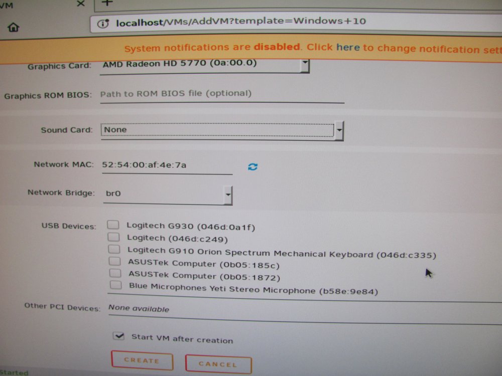

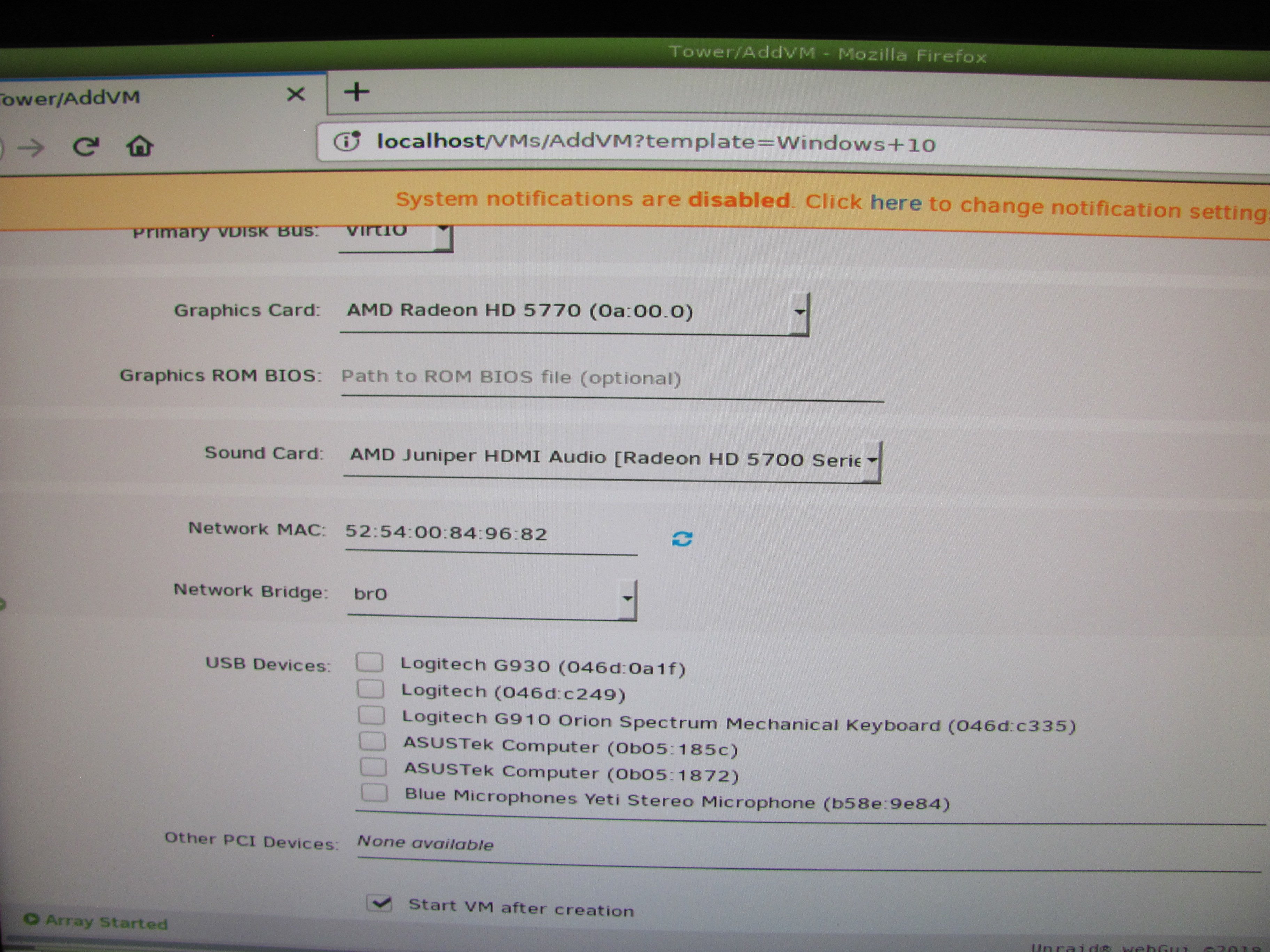

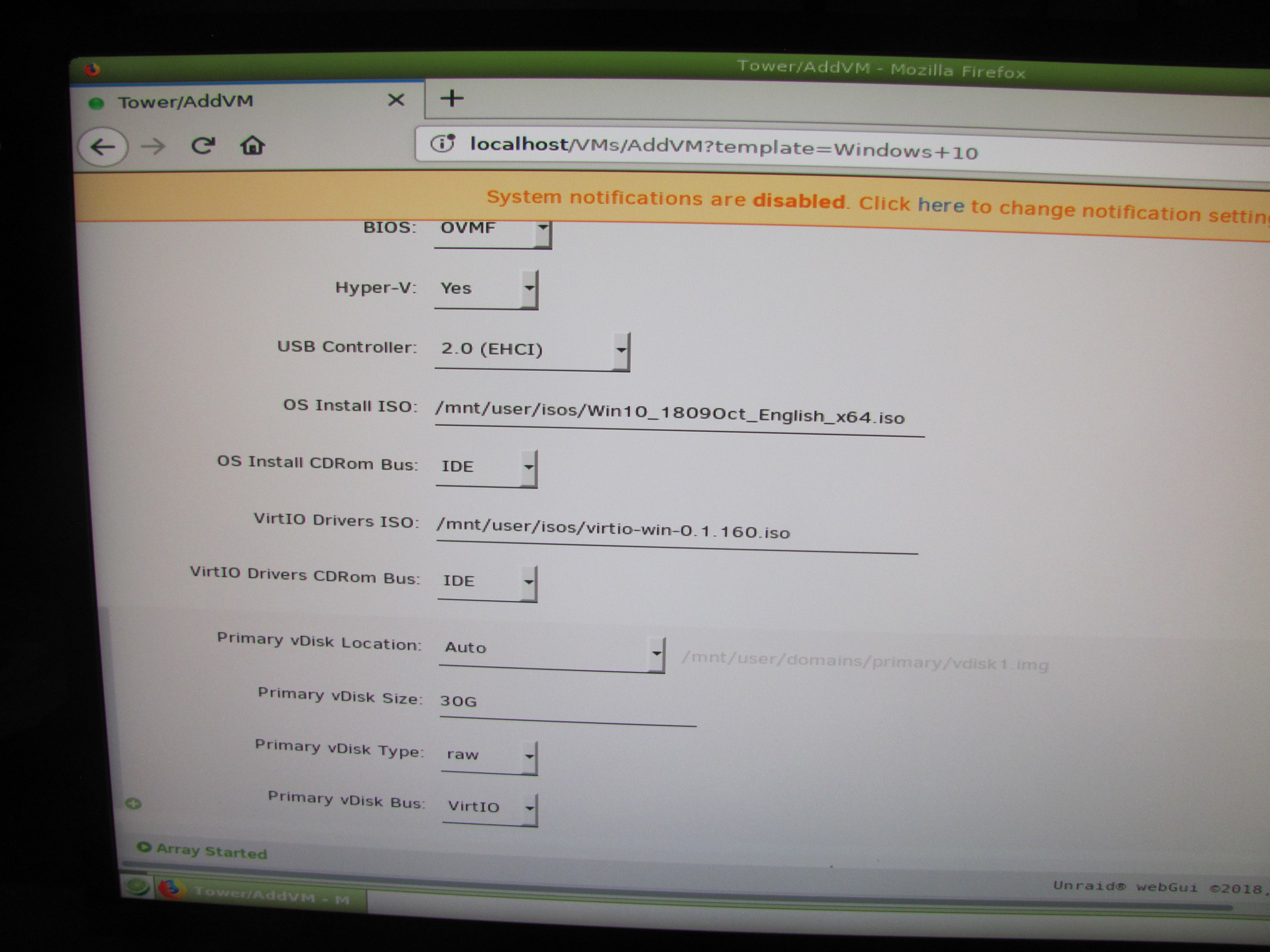

I have 2 cards in system atm.  I cannot get anything to boot through UnRaid.  I am trying to install windows with the GPU in slot # 2 on my motherboard, (5770 HAWK).  I am on the unraid os with the primary GPU on a 1070ti.
I cannot get anything to work and I dont understand why I cannot install or load a VM at all.
VM attempt number 2. Black screen.
this doesnt make any sense to me, I havent gotten a single VM working at all.  I have all virtualization in bios turned on, I am trying to make everything as simple and basic as possible.  I litterally Just CANNOT get a VM onto a screen.

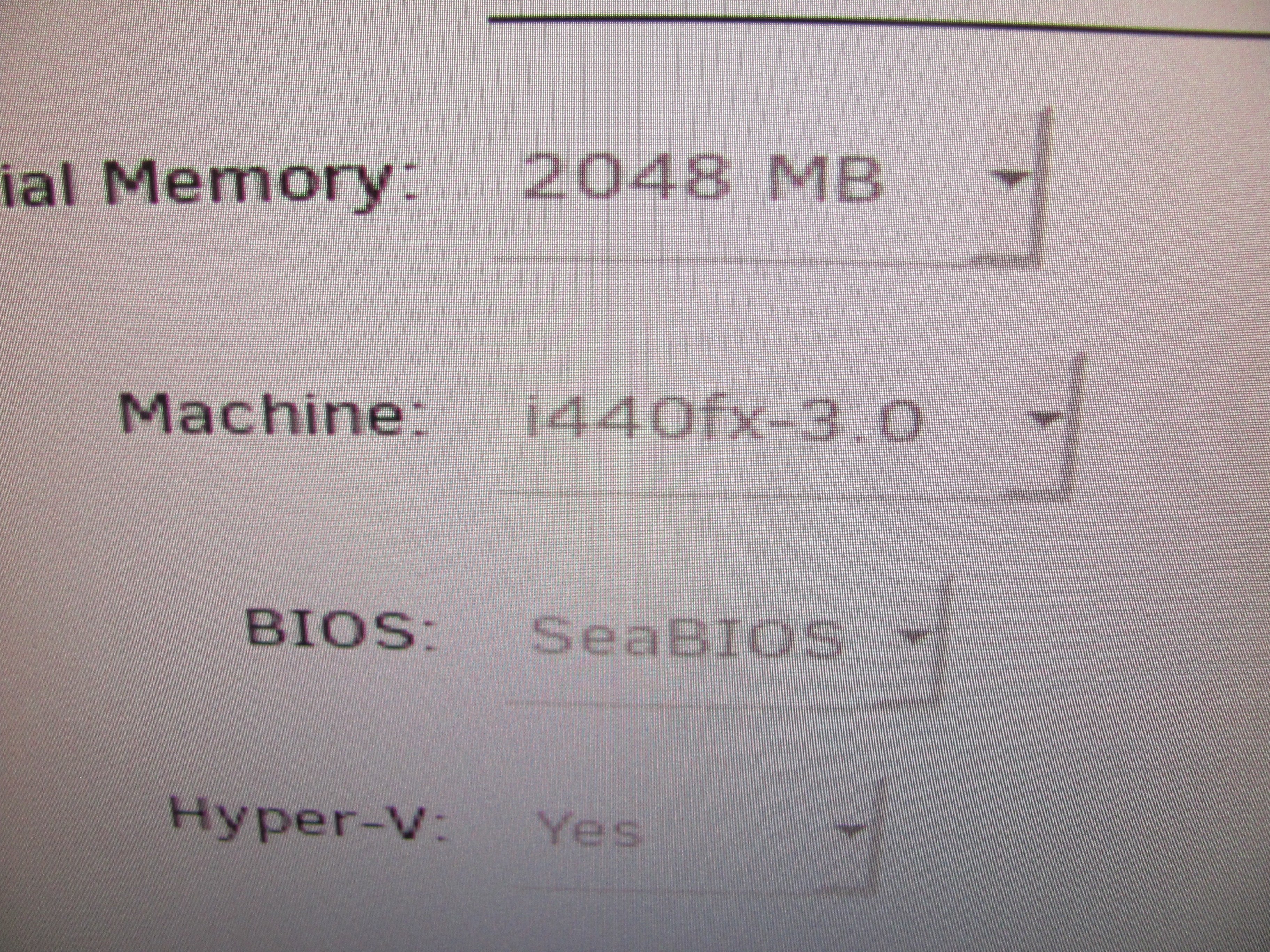

OMG BREAKTHROUGH FIRST IMAGE TO SREEN!
I understand your frustration :) I felt the same in the beggning.

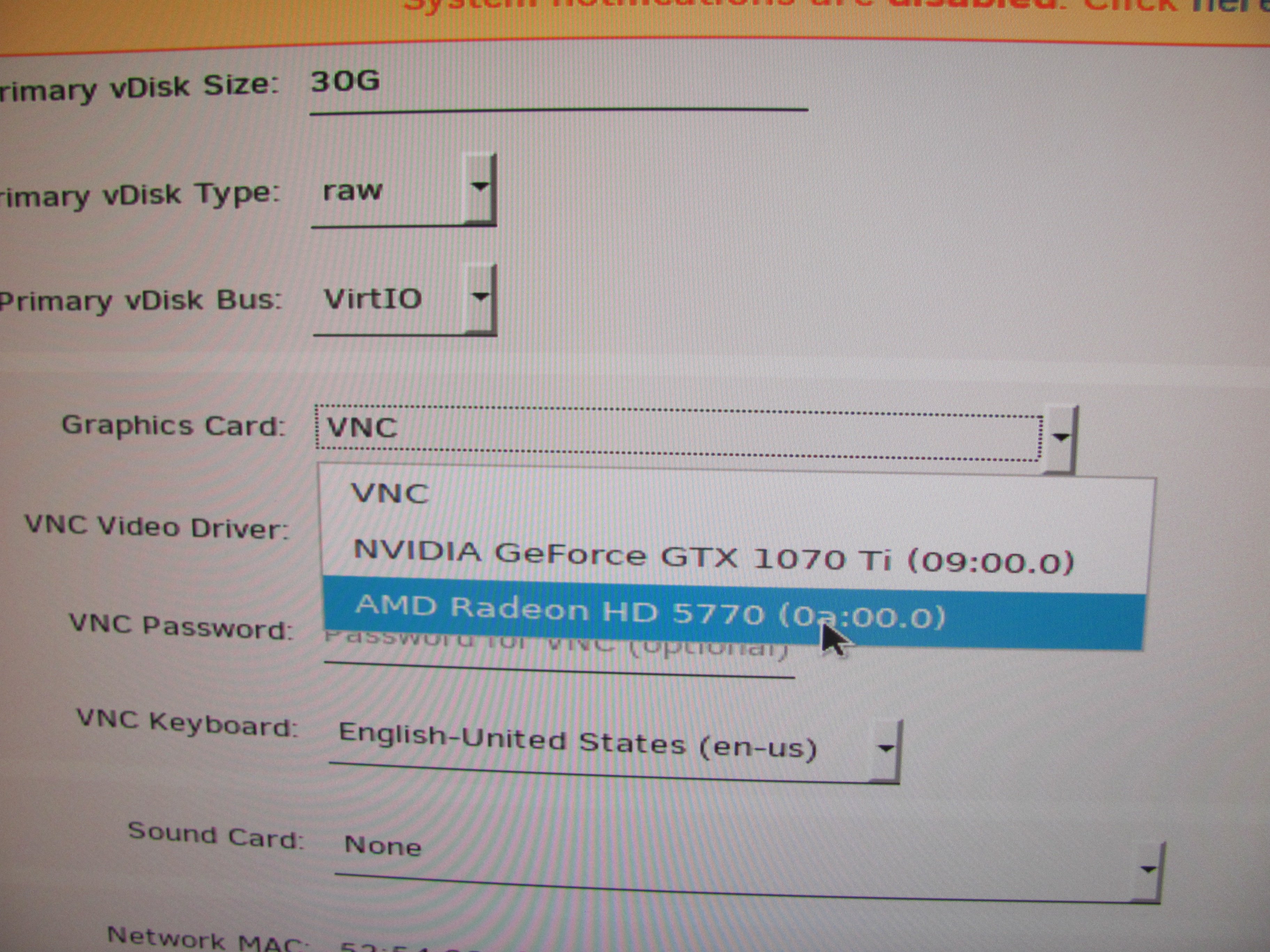

My next advice would be to try and boot it up with VNC as the GPU, as you would then be able to remove the GPU from the list of components that could give you trouble. "Remoting" in to the VMs is often a frist try for me to at least check if everything else works as expected.
But I'm glad you got an image to the screen now :D Looking forward to hear more on the future progress. Though, I'm on my way to bed, live in Denmark, it's 11:30 PM here :P
Edited by Squazz
posting images now TY for the help!
First image was setting BIOS to SeaBIOS
I will be make a new post and prolly a youtube video if I can get this working!
This has been some kind of hell working on this for litterally tens of hours and days, first success story.
Sounds crazy but moral of the story seems to be, try everything?
