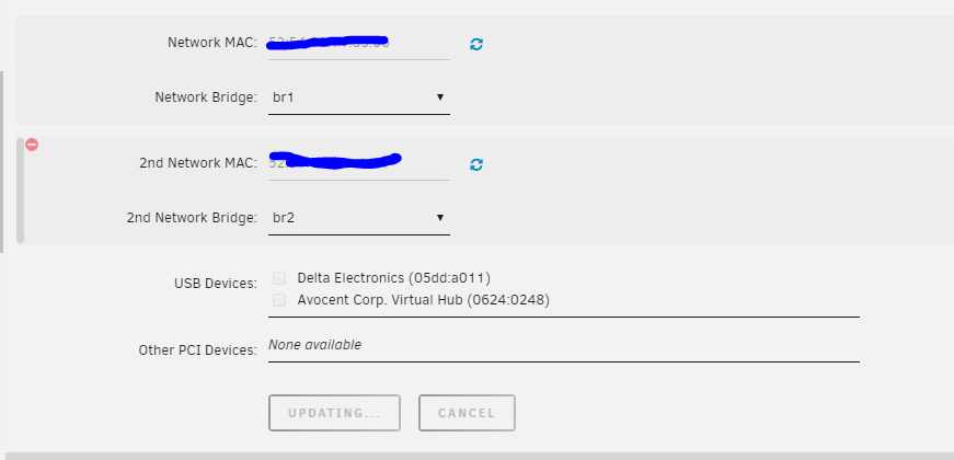

Having issues getting the second nic to add. Any help?
The VM doesnt like me adding br2. BR1 is added no issues.
Which part isn't working?
Your picture shows both br1 and br2 assigned to the VM.

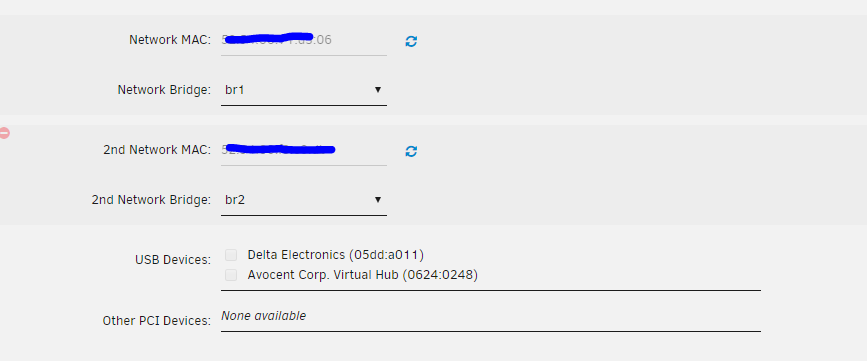

When I add the 2nd Nic (br2) and click update VM it just sits on "Updating" but never completes.
It has been on the image below for at least 30 minutes.
Just tested. Can add a second or third bridge interface without problem.
Are your first and second MAC address different (MAC addresses must be unique)?

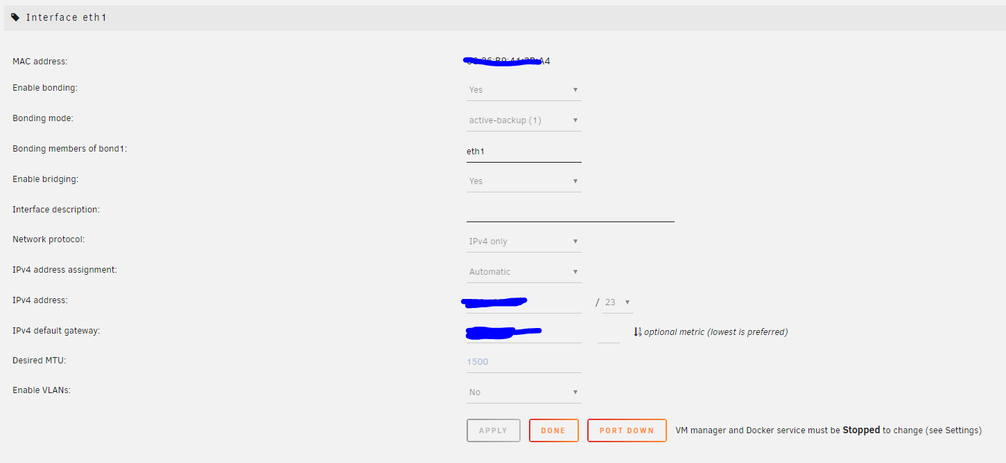

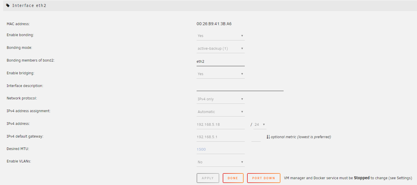

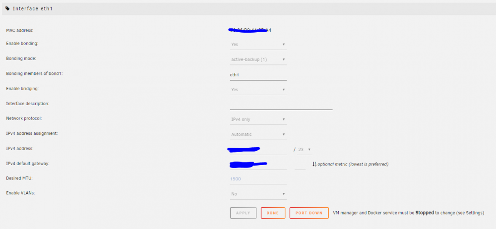

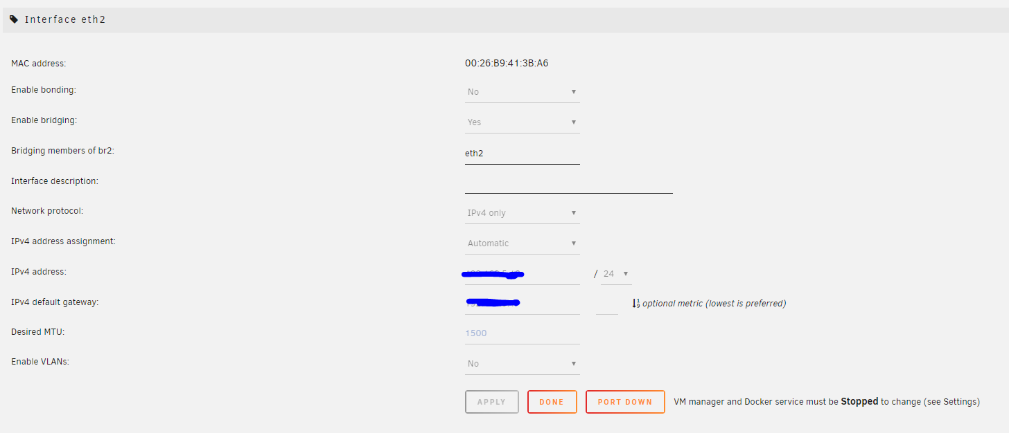

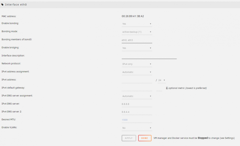

Yes they are. Here is screenshots of settings > network
Try disabling of bonding for both eth1 and eth2 and leave only bridging enabled. See if that makes a difference.

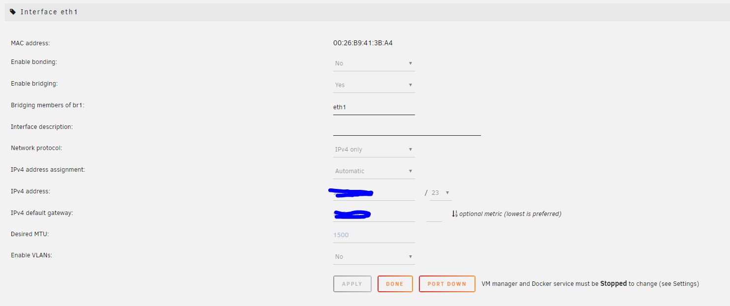

Same issue
Eth1 I am getting my public IP from ISP. Eth2 I have connected to same switch as eth0 (current network). Just so it has a ip address. Not sure if this should be disconnected for now?

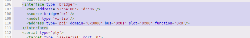

When you switch to XML view. How does the interface section look like?
    <interface type='bridge'>
      <mac address='52:54:00:c0:5f:69'/>
      <source bridge='br0.4'/>
      <model type='virtio'/>
      <address type='pci' domain='0x0000' bus='0x01' slot='0x00' function='0x0'/>
    </interface>
      <mac address='52:54:00:89:67:08'/>
      <source bridge='br0.5'/>
      <address type='pci' domain='0x0000' bus='0x03' slot='0x00' function='0x0'/>
    </interface>

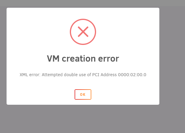

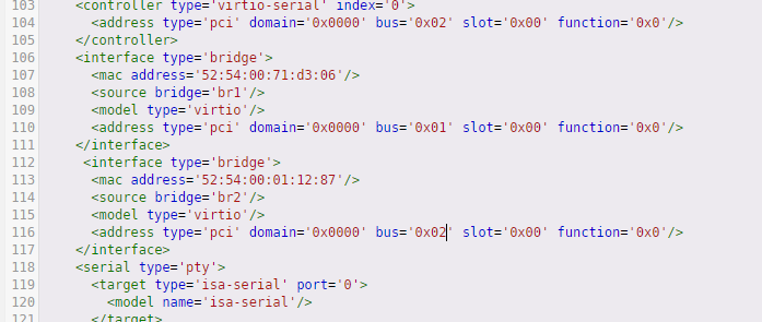

This is the only connection that shows up. When adding the second one it fails. Having issues writing a XML of second NIC.image.png.2b5c20682bbd54e723cbca0912a56849.png
I tried manually creating the second one.3333.PNG.1a564b114cb4d01ba7ebd78a0cbfcf95.PNG222.PNG.e95873ddb93f1ed80001aaf276f17547.PNG
