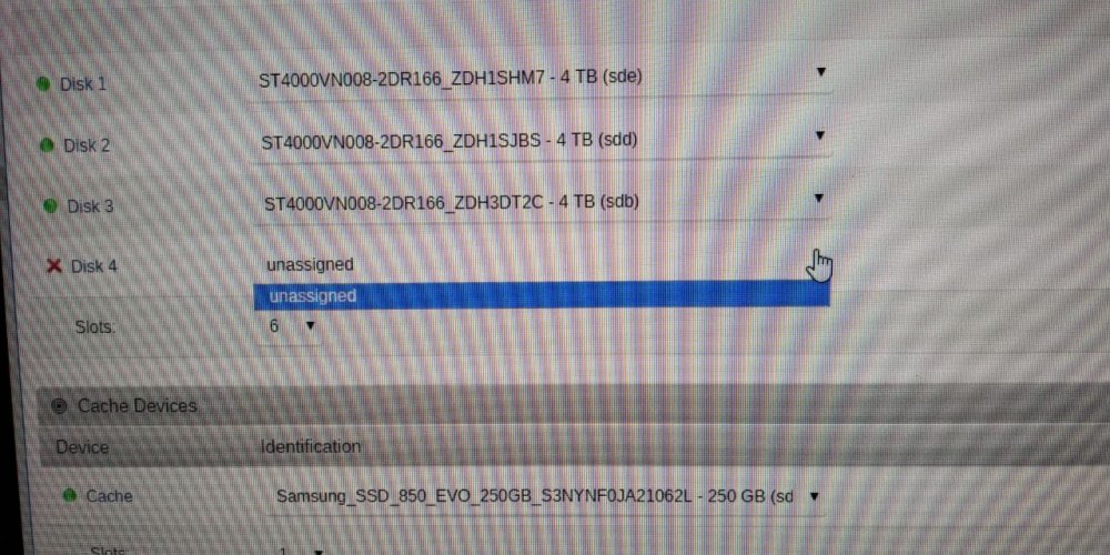

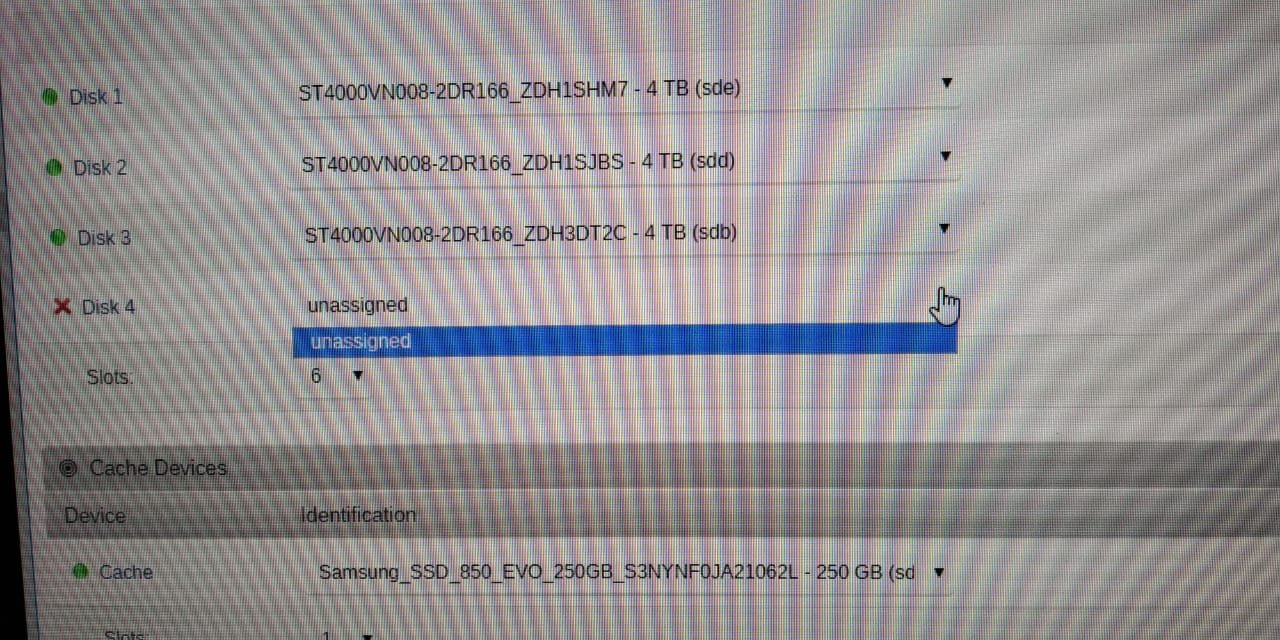

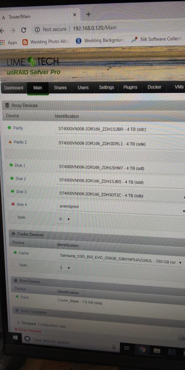

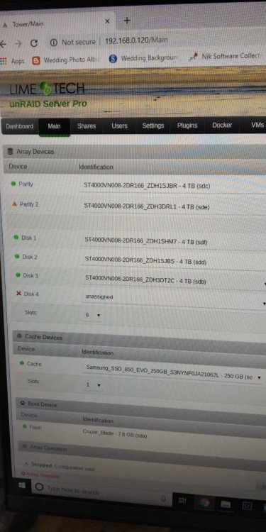

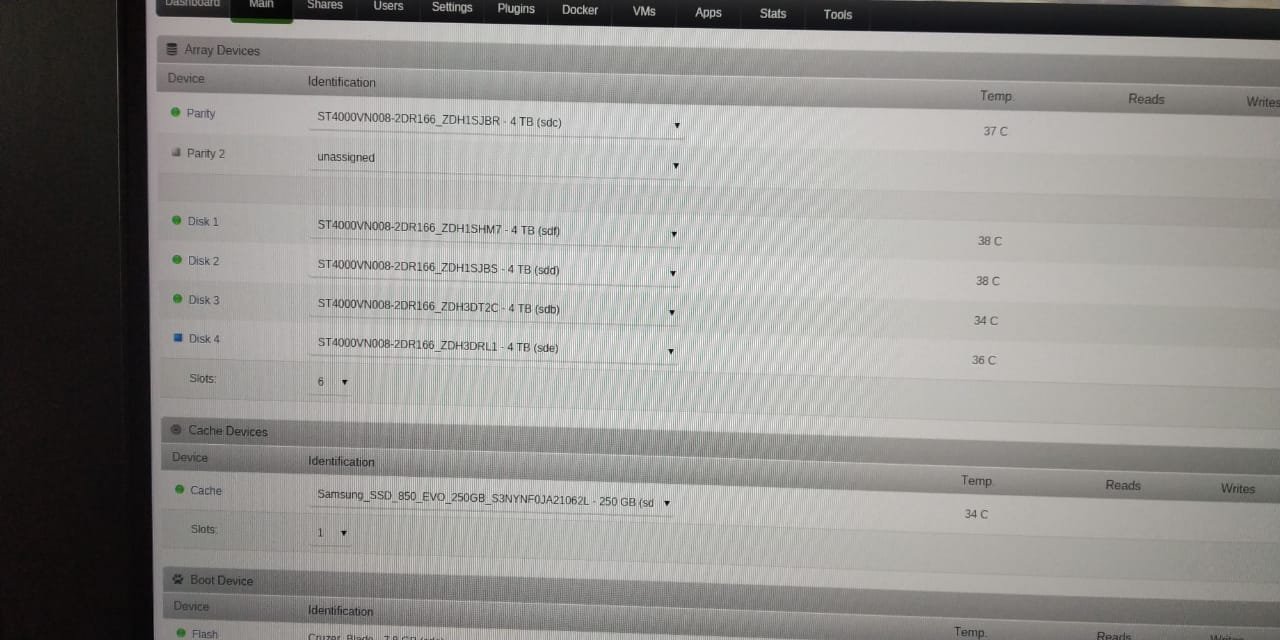

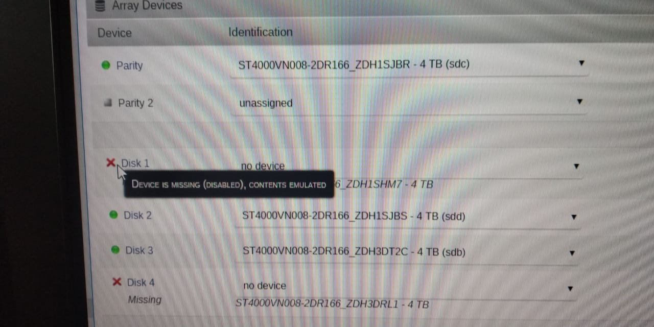

MAIN showed different informations. Once 2 hard discs weren't available. Then rebooted and one was working fine. Rebooted again then the other was showing blue box. ( am attaching all of them as images and tower diagnostics taken in different times)

While i was typing this one of my buddy have just messed it more by adding the 4th disc in parity 2 unknowingly. I asked to stop the array when i noticed it. Now the 4th disc is being shown as a new device. 💁‍♂️ i don't know what more to say. Complete mess.

First you should try to fix the issue causing the disks to not appear, possible some power or cabling issues, but then to fix the array, unassign parity2, start the array with disk4 unassigned, if the emulated disk mounts and data look correct reassign disk4 and start array to rebuild.
I can follow till "start the array with disk 4 unassigned"
What are the exact steps should i follow post this point ?
Edited by ThePhotraveller
Check that the emulated disk mounts by looking at the main page, you can also browse the disk to check all appears good, if yes, stop the array, reassign disk4, start the array to rebuild it.

And as per your guidance the rebuild process has been initiated. Fingers crossed.

These type of issues are very difficult to diagnose remotely, especially without any diagnostics showing the problem, all the diags you posted are after rebooting, so not much help, though one thing you should do now, and even cancel the rebuild if you have to, is to change tie onboard SATA ports to AHCI, never use IDE mode.
