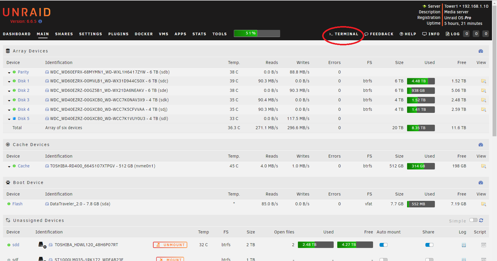

thanks 88 . i'm a newbie and not much pf a computer guy. Can you walk me through exactly what you are talking about . Is rsync a pluggin? where do I type what you have written?
Thanks!
rsync is included with Unraid, you type the command on the CLI using for example the built-in terminal window, shortcut is on the GUI's upper right side.

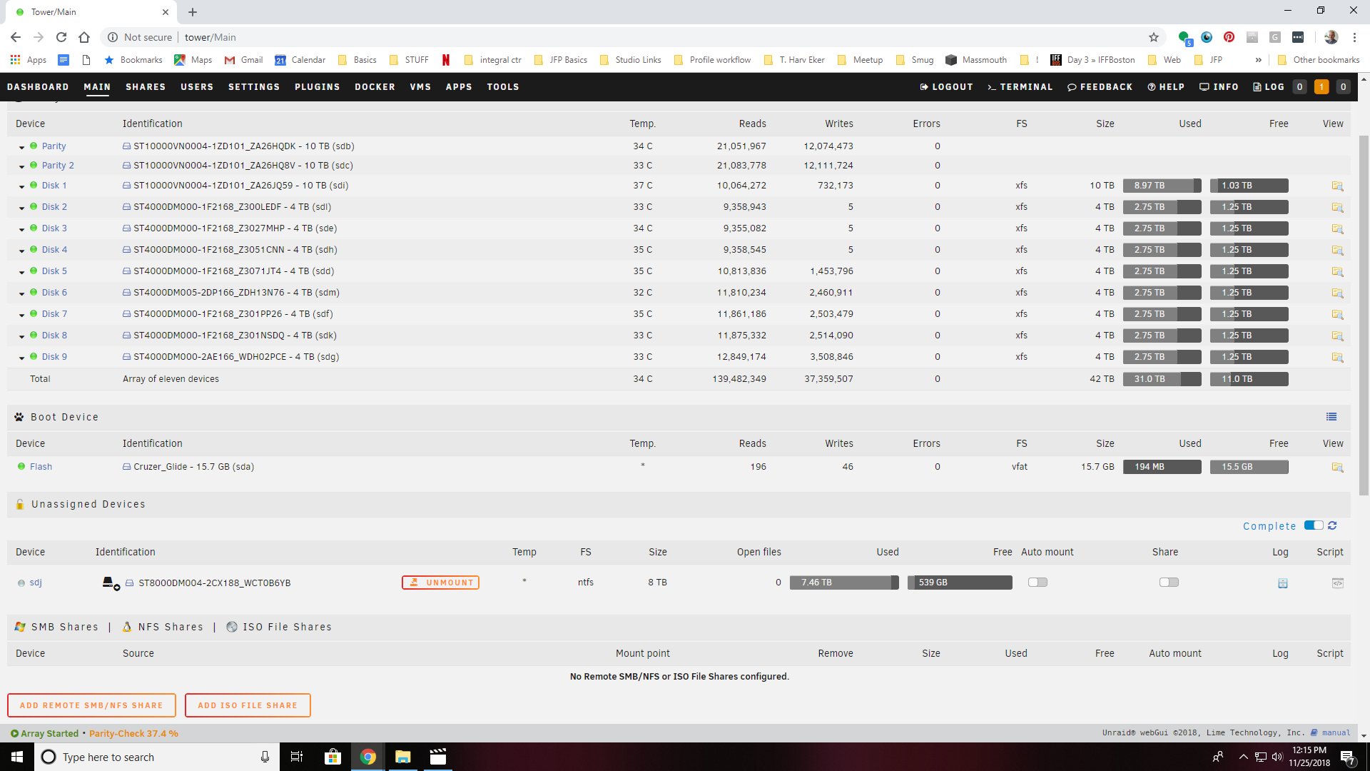

I think so .. here it is. sdj
Did you assign a name to that Unassigned mount?
At the command prompt, what do you get when you type this:
ls /mnt/disks
Events_1
here it is

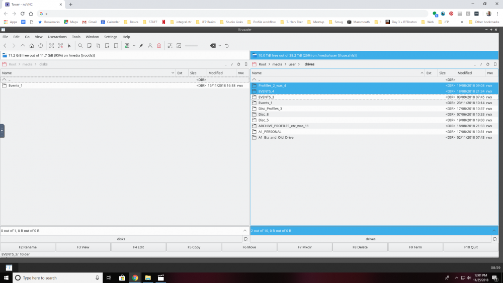

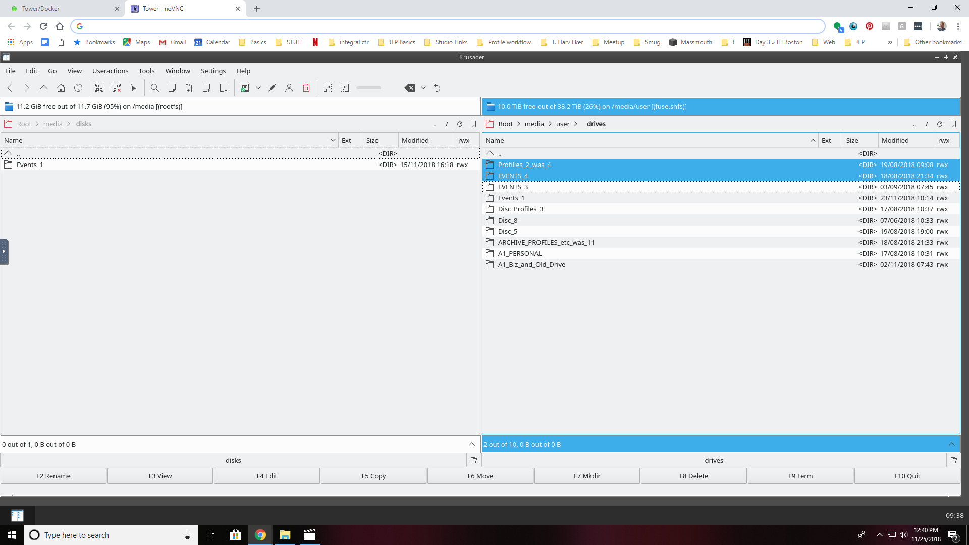

Krusader makes things easier for some things but confuses me since I don't use it. I use the builtin mc (Midnight Commander).
The reason Krusader confuses things is because the volume mappings for the docker are up to the user, and so the paths that get displayed in the docker aren't really the paths you would use at the command line (or indeed anywhere else). I just pulled binhex-Krusader up in Apps and it looks like it only gives one mapping by default, which is mapping the user shares (/mnt/user) to /media in the application. But that doesn't seem to be what you have and since we are talking about working at the command line I think it might be better at this point to just leave Krusader out of the discussion.
The actual paths to your array disks are /mnt/disk1, /mnt/disk2, ..., the path to cache is /mnt/cache, the path to Unassigned mounts is /mnt/disks, the path to user shares is /mnt/user.

17 minutes ago, trurl said:
What did you have in mind for the destination?
Thanks. I don't understand your question. The destination is already there.  Events_1
I already copied the disk into the array but I'm not sure if it was a complete copy and want to either confirm tat it is or complete it if it isn't
Edited by jonF
I thought we had already established that Events_1 was the source.
Events_1  is the Unassigned Disk (sdj) correct? And you tried to copy it to the array? So some disk on the array (or was it a user share) was the destination?

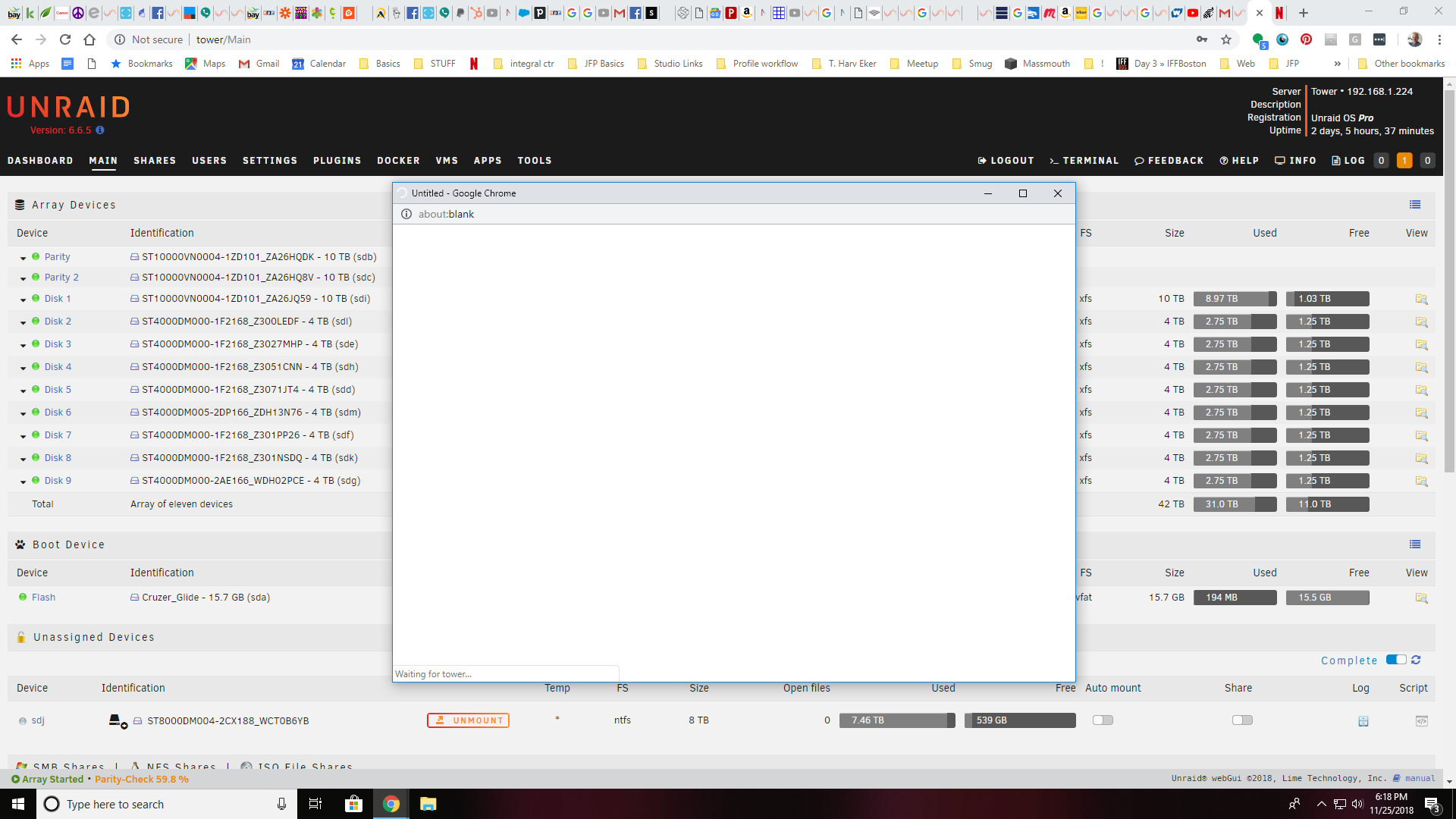

Johnnie, I'm about to paste that into the terminal window but when I click on the terminal there is a blank white screen and the command prompt isn't there.  Any thoughts?
29 minutes ago, jonF said:
Any thoughts?
Terminal is not working properly, try again after rebooting.
thanks. working now.

Is the Unassigned Disk still mounted? Is it really mounted with the name Events_1?
ls /mnt/disks
