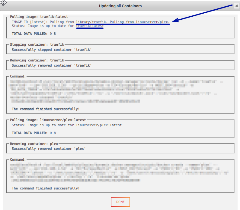

November 25, 20187 yr Hello, Getting updates for my Docker containers and it's pulling data for some but for most I get "TOTAL DATA PULLED: 0 B" I also noticed this (it is standard with 1+ update?): What could be up with this? Most of the updates are pulling 0 B. Not seen that before. Can't find any errors in logs. Unraid 6.6.5. Looked at other threads with "TOTAL DATA PULLED: 0 B" but not same error or solutions. Recently changes are all sata-cables (got some UDMA CRC error count on one drive (6), changed sata cable, put server back in place hard to get, ran parity check, UDMA CRC error on one of the other drives (got up to 6 here too), decided to get brand new sata cables and replace ALL. New parity check, no new UDMA CRC error's), added parity drive (had 0 parity drives before) and added "--restart=unless-stopped" to some containers. Then, this started to happen. appdata and system (docker.img) on samsung ssd (cache). Edited November 26, 20187 yr by Niklas
November 26, 20187 yr The container image that you're trying to update is already up to date (checksum test return 1) so it just use the local image.
November 26, 20187 yr Author Is the "pulling from" correct? Showing plex when working with traefik? At first, I thought it was only the linuxserver containers. It's not. I just see them more often because I mostly use containers from them. It happens to the others too. Pressing check for updates could show no updates, pressing again directly after could show there is updates but 0 B pulled data. Looking at docker hub the last push can be like a week ago but it still shows as update available, updating fetch 0 B and the status goes from update available to up to date. One example is uberchuckie/observium. Has shown updates several different times since 2 days. Always 0 B pulled. linuxserver builds once a week? I have seen different updates from them over the weekend. I have seen 0 B pulled before but now it happens daily. Some dockers updates without problems, like Emby server beta that got "real" updates yesterday. It's like Unraid is showing updates for containers that don't have any updates? Edited November 30, 20187 yr by Niklas Removed diag
