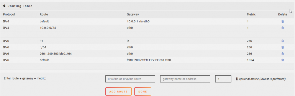

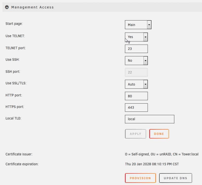

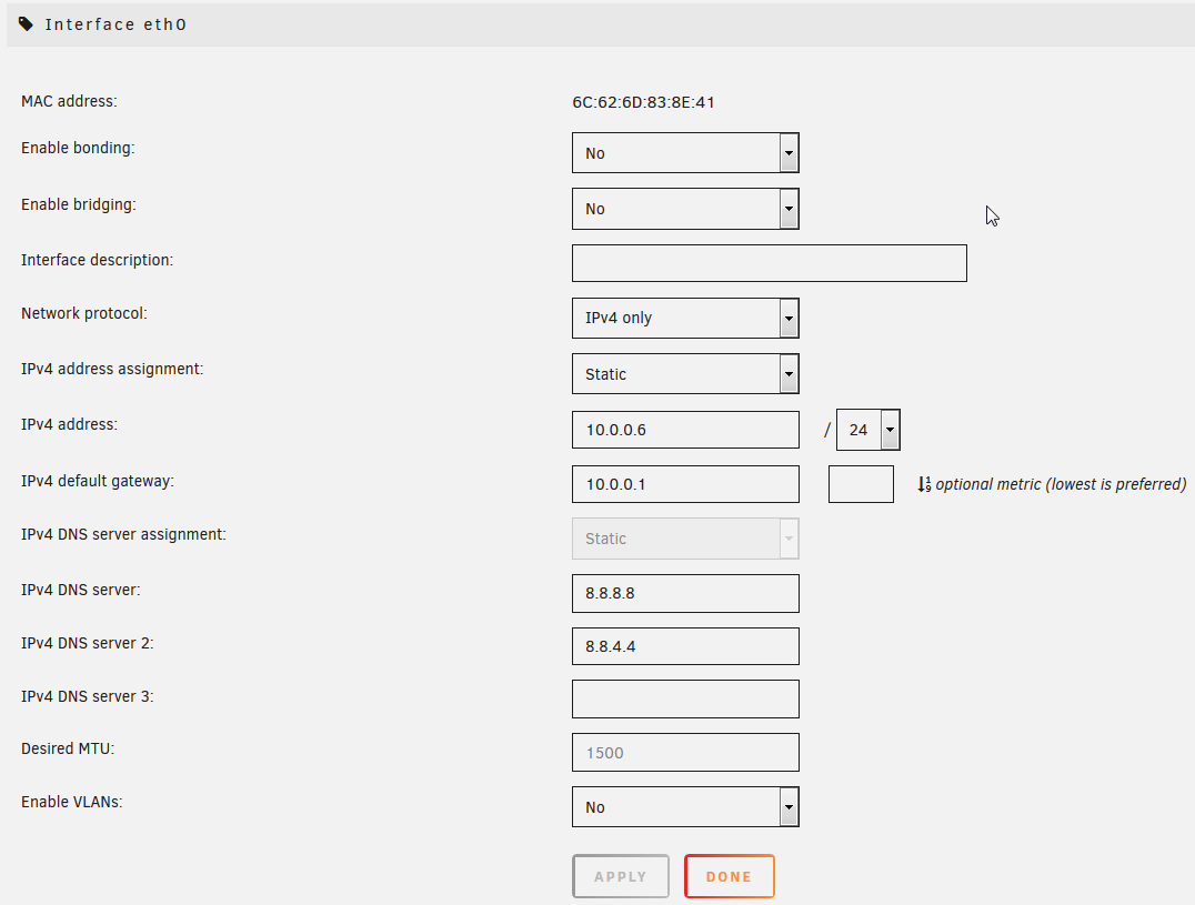

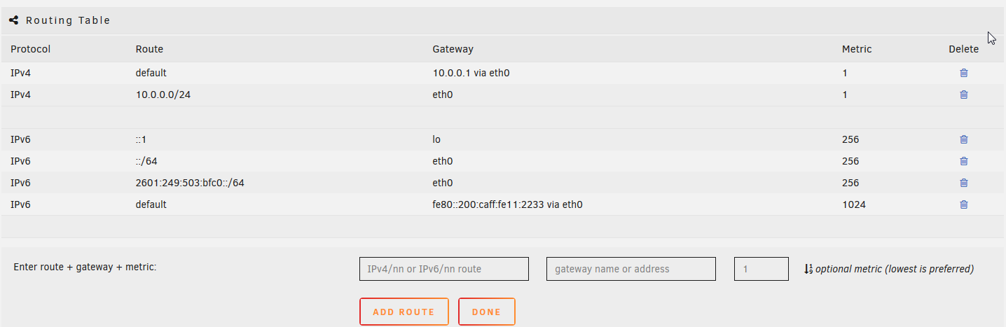

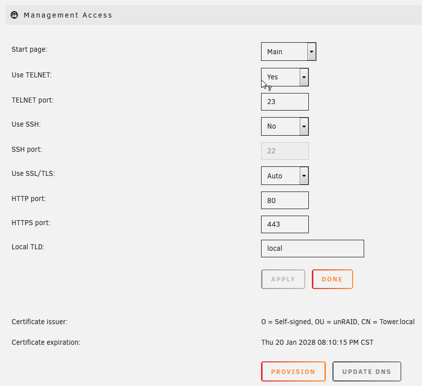

At this time this machine can not acquire a cert, but everything else appears ok, I am not sure what might
help so I included the identification and network setting screen shots.

I just realized the screen shot showing "Use SSH" set to NO is actually set to AUTO, I must have
grabbed it to soon.
