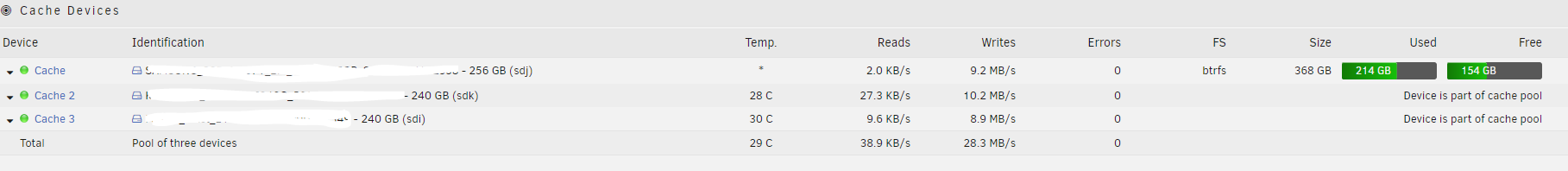

I have a cache pool option in my setup.
I have 3 ssd
1 x240gb
1x240gb
1x256gb
My probleme is that the total is 368gb in unraid.
How could this be right ?

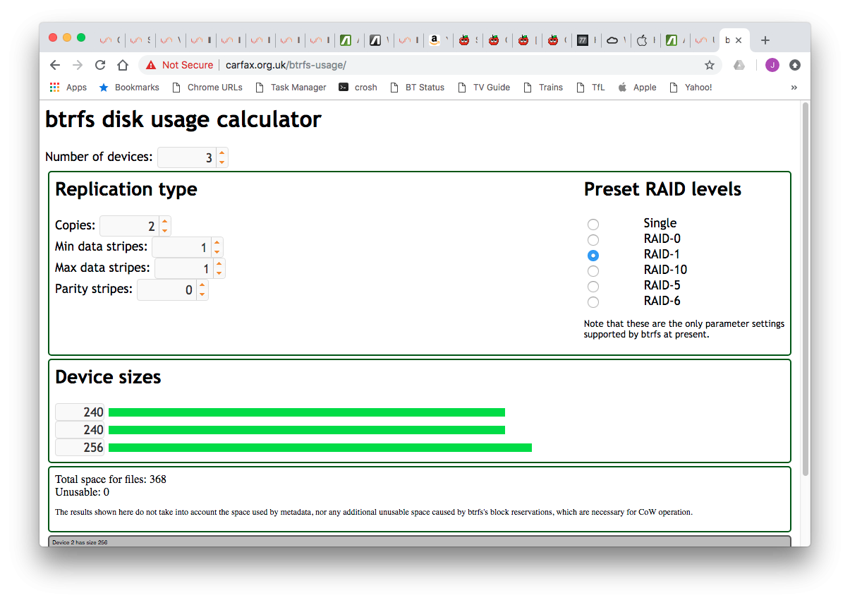

That is exactly correct. See here:
256685699_ScreenShot2018-11-27at13_55_35.thumb.png.9d536b15c727b6309a023cf3e728f41a.png
I'm not sure what capacity you were expecting to see but BTRFS RAID 1 is a little different from traditional RAID 1. With three devices you don't end up with a triple mirror. Instead you get exactly two copies of any block. I believe the blocks are allocated to the three devices in a round robin fashion. The fact that the three disks aren't of equal capacity makes it complicated to visualise but think of it like this: half of the 256 GB device is mirrored on each of the two 240 GB devices, leaving 240 - 128 = 112 GB that's mirrored between the two 240 GB devices. 256 + 112 = 368 GB.
