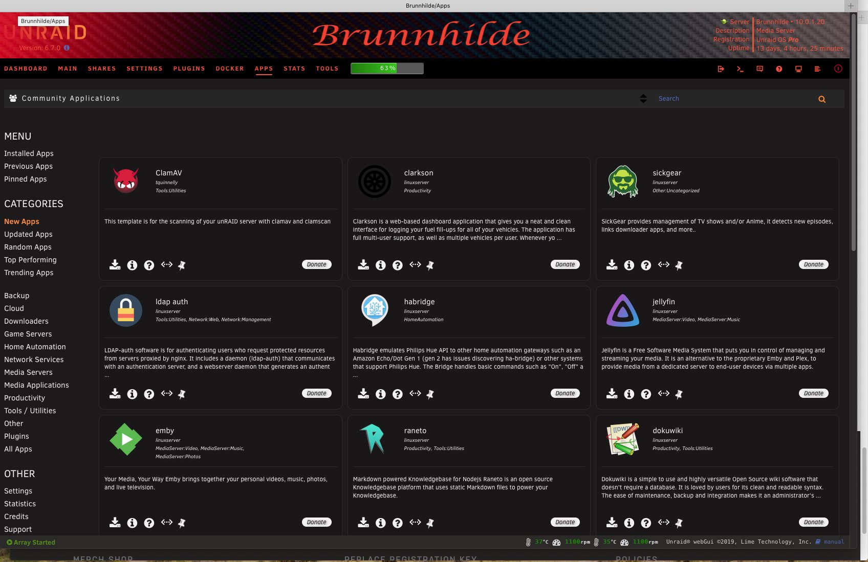

Also, just requested it be added to CA.
Looks like it's been added.

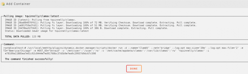

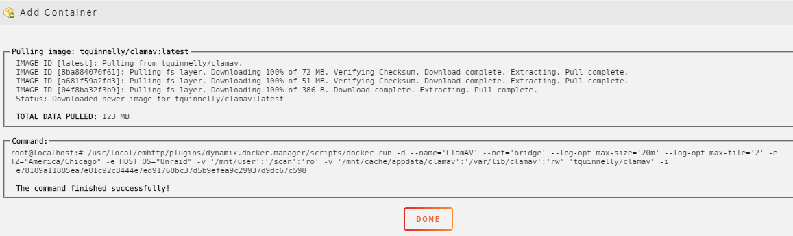

This is what it looks like running from CA. It adds the default `/mnt/user` as the scan target.
/# docker logs -f ClamAV

Installing in unRAID via CA is the preferred way now. You'll get updates and everything like magic.
