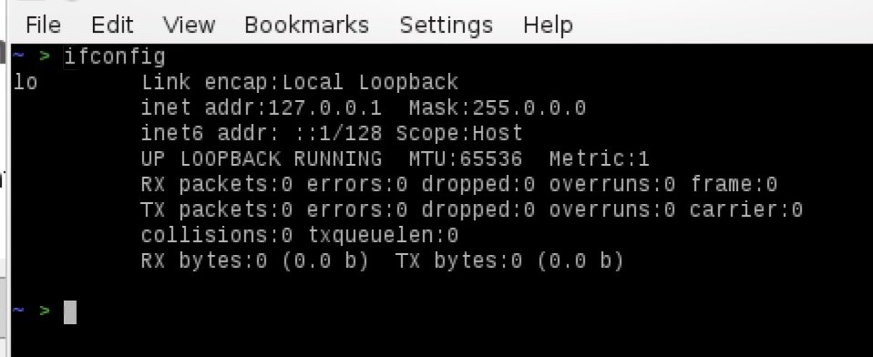

Do an ifconfig from within the OpenSUSE VM to see the networks presented.  All Linux-based guest VMs should support the VirtIO network drivers that we use for VMs with Unraid.
@jonp This is all I can see. (version 13.2)
Even though I have a br0 network configured, I can't seem to have access to the network card.

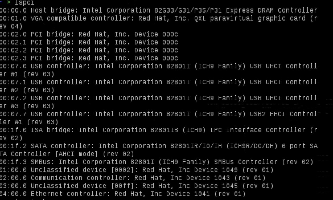

You shouldn't need to "install" any virtio drivers for opensuse if it's just a standard Linux based distro. Can you try typing lspci for me and report the feedback? And lspci with the -k option so I can see the driver bindings?
Sent from my Pixel 3 XL using Tapatalk

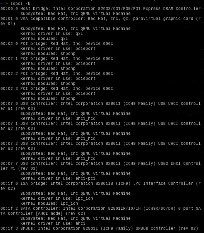

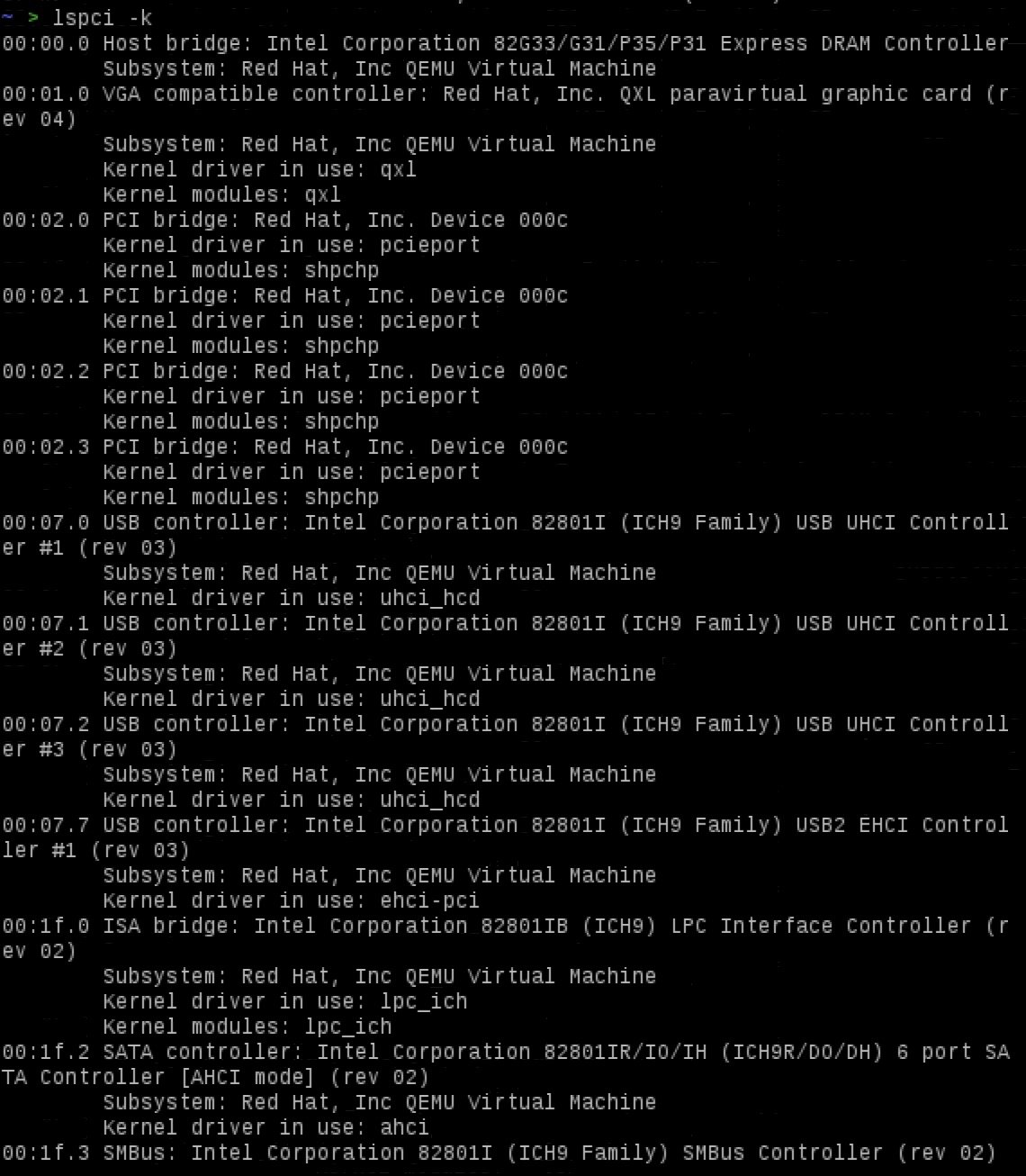

I haven't find any great fast way to paste the result here other than a screenshot. But here is that:

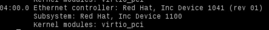

Ok the second screenshot at the bottom shows the Ethernet controller but it's cut off before I can see the driver part.
723054947_Screenshot2018-11-28at18_52_46.thumb.jpg.6fde1db0023045a51211dacca6a277b0.jpg
671768519_Screenshot2018-11-28at18_52_36.thumb.jpg.20afbfbacbaa09e1e689b170266c35f6.jpg
My bad. Here you go

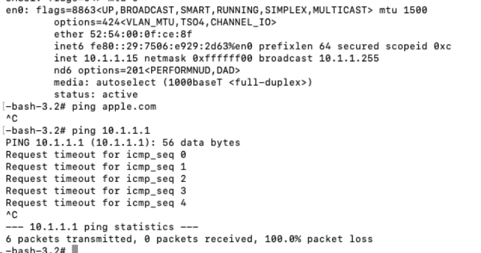

Can someone please help. I'm getting an IP but can't talk to my router or ping internet.
Server has internet, and is working great. I've tried reinstalling the VM about 10 times, each one following the SpaceinvaderOne MacOS installation guide.
Any help would be great.
