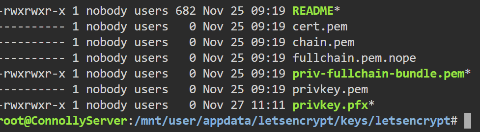

For example, I have this when I look at the files. From what I have read, I don't think I am supposed to have all dashes right? This means I don't have permissions to do anything with the files. I think...
So it all boils down to the fact that mover somehow dropped my permissions on the files. I just need to know how to allow user nobody to be able to read and write these files again. I think I have some idea what's going on I just don't know how to fix it.
Yes. The dashes mean neither read nor write access. However, most of those files have zero length so only the names were copied and not the content. That isn't what mover does. If it can't move a file it leaves it where it is. There must have been some problem with the move - either it was interrupted or the destination was full. Did you confirm that the old cache drive was actually empty of files before you removed it?

Had you actually created keys and certificates with LetsEncrypt? The only instance where these files could legitimately be zero length is as placeholders, before the keys have been generated. Maybe they are meant to have no access permissions by default for security purposes. Storing private keys in appdata and readable and writable by the nobody user is not very secure, is it? That would be a question for the relevant support thread.
Oh yes, I had. It had been working for months without any issues at all. My plex.domian.com cloud.domain.com all of that stuff worked fine along with the SSL certs. Nextcloud was working fine as well, I love using the auto-upload features for pics and vids I take with my phone of the family.
