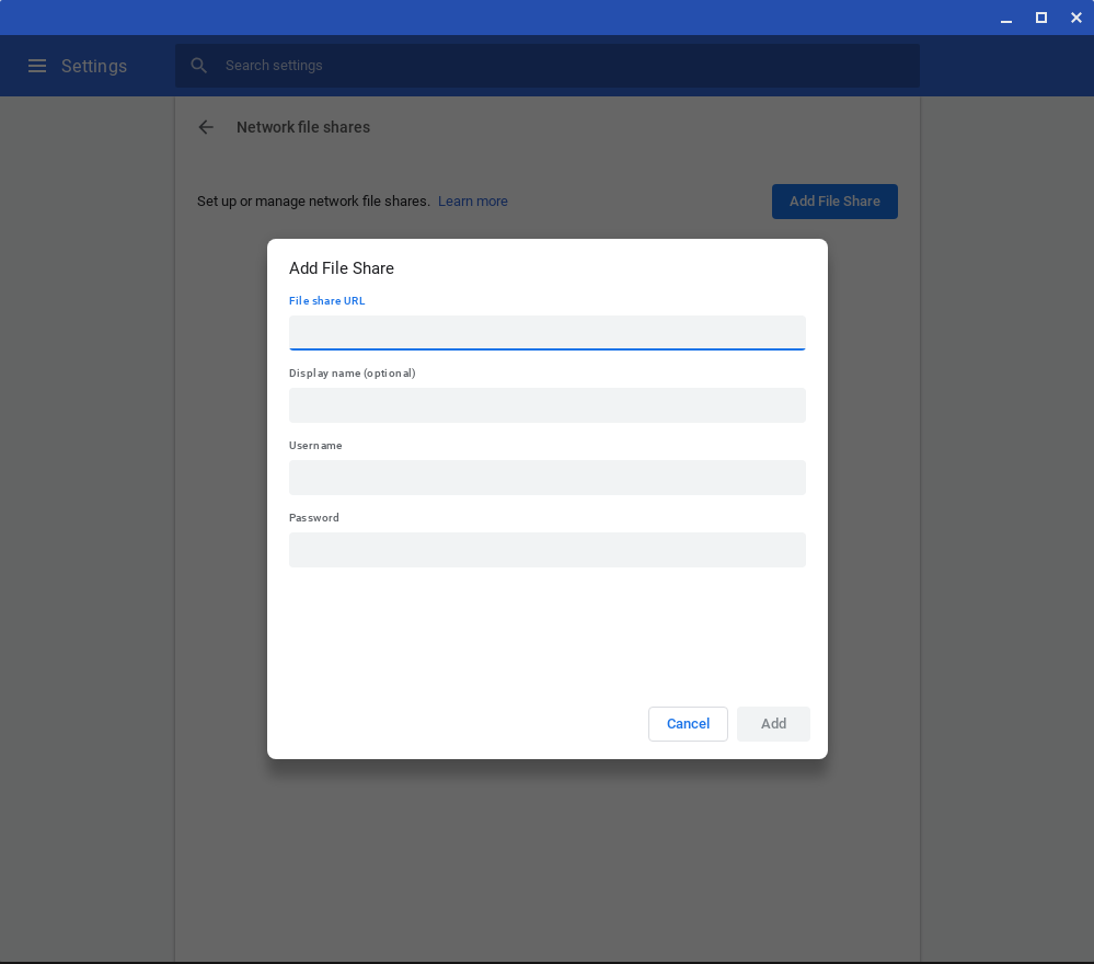

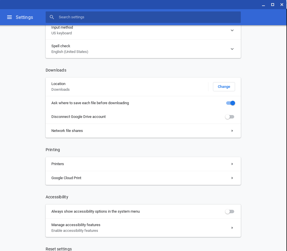

Now that time has gone by, Chromebooks are evolving, and there has been apps made as the "SMB for Windows app" that seems it was working (I haven't tried), but I was just looking at the settings (advanced > downloads > network file shares) and there is was, telling me to add the NAS by either smb://server/folder or \\server\folder.
But I could not connect to it for the life of me. Not sure if anyone here with actual knowledge would be able to educate me and help me tho this struggle.

Have you tried replacing the server name with its IP address? Often there are name resolution issues. Is it a private or public share? What are you entering in the Username and Password fields? The most likely to work is a private share which has access granted to a user whose credentials you enter in those fields.
Update to Unraid 6.6.5.
I'm sorry, I was a bit vague, I did attempt using the server name(bootland) and the local ip(192.168.1.2), I made sure nothing was capitalized, and properly typed. I attempted multiple shares, which some are private and public, all of them with and without user information, made sure password is good. Also, I did attempt more than one user(one user has r/w the other has only r).

It's working for me. Just use \\192.168.1.2\media or equivalent for your machine and add user/password, if required ...
Also smb:\\192.168.1.2\media it's working. I guess you have SMB activated...
For some reason now smb:\\ isn't working, but just \\192... is working for most shares. It's working intermittently, working on some shares that are hidden but not on some of the privates. some are saying that the credentials are wrong, while it's the same credentials across all of them.
