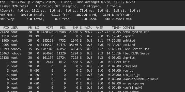

This morning, I woke up to find my other main server pegged at 100% cpu usage. I was able to get into the terminal and run pftop which showed qemu was the culprit.

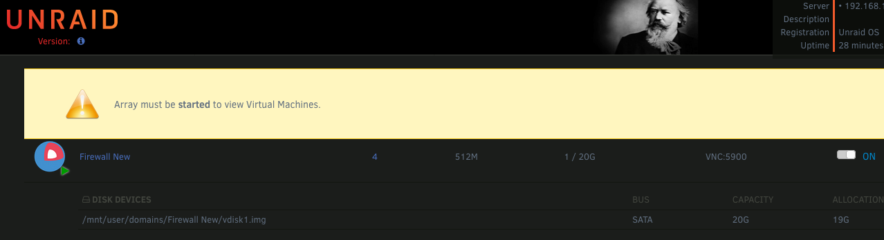

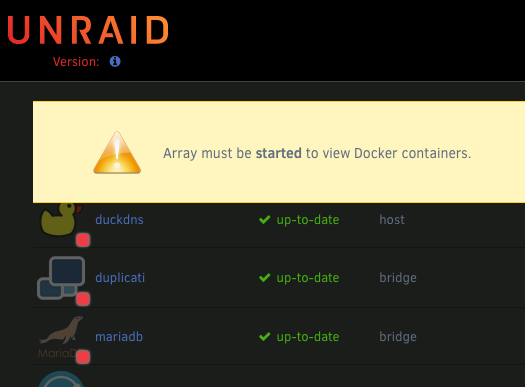

after rebuilding the firewall vm, i then ran app data backup. it stopped all the dockers, did some things, then reported an error. the array then went to an undefined state:

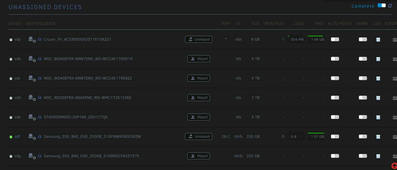

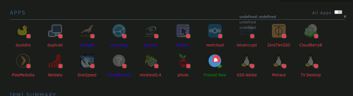

all discs now show under unassigned... and the dashboard shows no icons

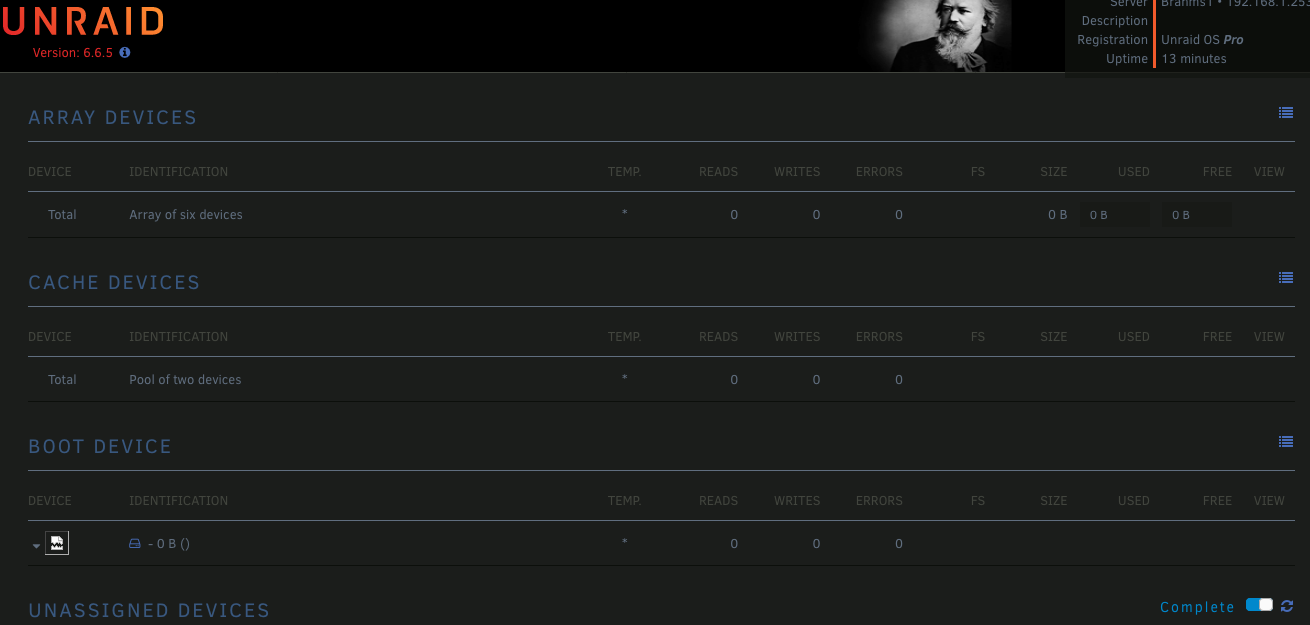

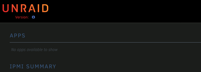

OK. so I manually ran the appdata backup after putting fix common problems in trouble shooting mode. It ran the backup said it was done with errors. The dockers never restarted. Then errors started pouring in the syslog. I also attached a video showing how wonky it was afterward, (at the bottom of this post) and also showing it not downloading diagnostics. The array status kept changing from green to orange.
It was all very exciting ... lol...
It did not stop the firewall this time. a reboot returned it to normal operation (I wasn't previously able to reboot via webgui but could this time.)
there was also something that i assume was a popup that never rendered correctly on the right side that said undefined:undefined undefined undefined.
220092787_ScreenShot2018-12-03at12_35_04PM.thumb.png.8537c9d4ab1c167a60d2df080565ebe7.png
I was able to get to the syslog, and while it wouldn't download, i could copy/paste it into a document. it is here: errors.rtf
I looked in the appdata backup location for the tar to "  verify errors occurred" indicated by the logs but only found 3 older backups from mid November and no new backups. the libvirt backup has a timestamp that coincides with this backup so it was copied over. there were no other browser tabs open at the time either.
