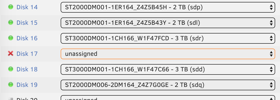

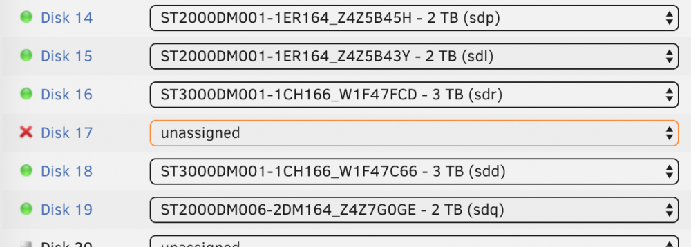

when I try to start the array again, disk17 says unassigned...
I mean with the array stopped, there is no disk assignment in disk17 slot.
The drive does appear in the drop down but I guess if I reassign it here it'll erase / overwrite it?
Do I need to force it back into the array or something?
What have you been running the commands against?  /dev/md17 or /dev/sdXX
Errr . I just clicked on disk17 in the GUI, I dont see any reference to which device it's working on..
Edited by fysmd
But its showing as "Unassigned" now and not "Disabled"  Post a screen shot.  Are the files now available when starting the array?
Edited by Squid

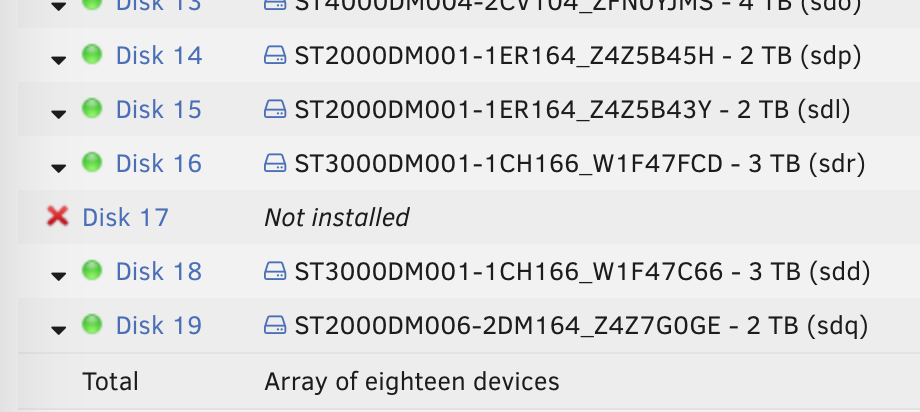

It just says not installed when started, unassigned when not :(
If you stop the array, and reassign the drive into 17, it should begin to rebuild.

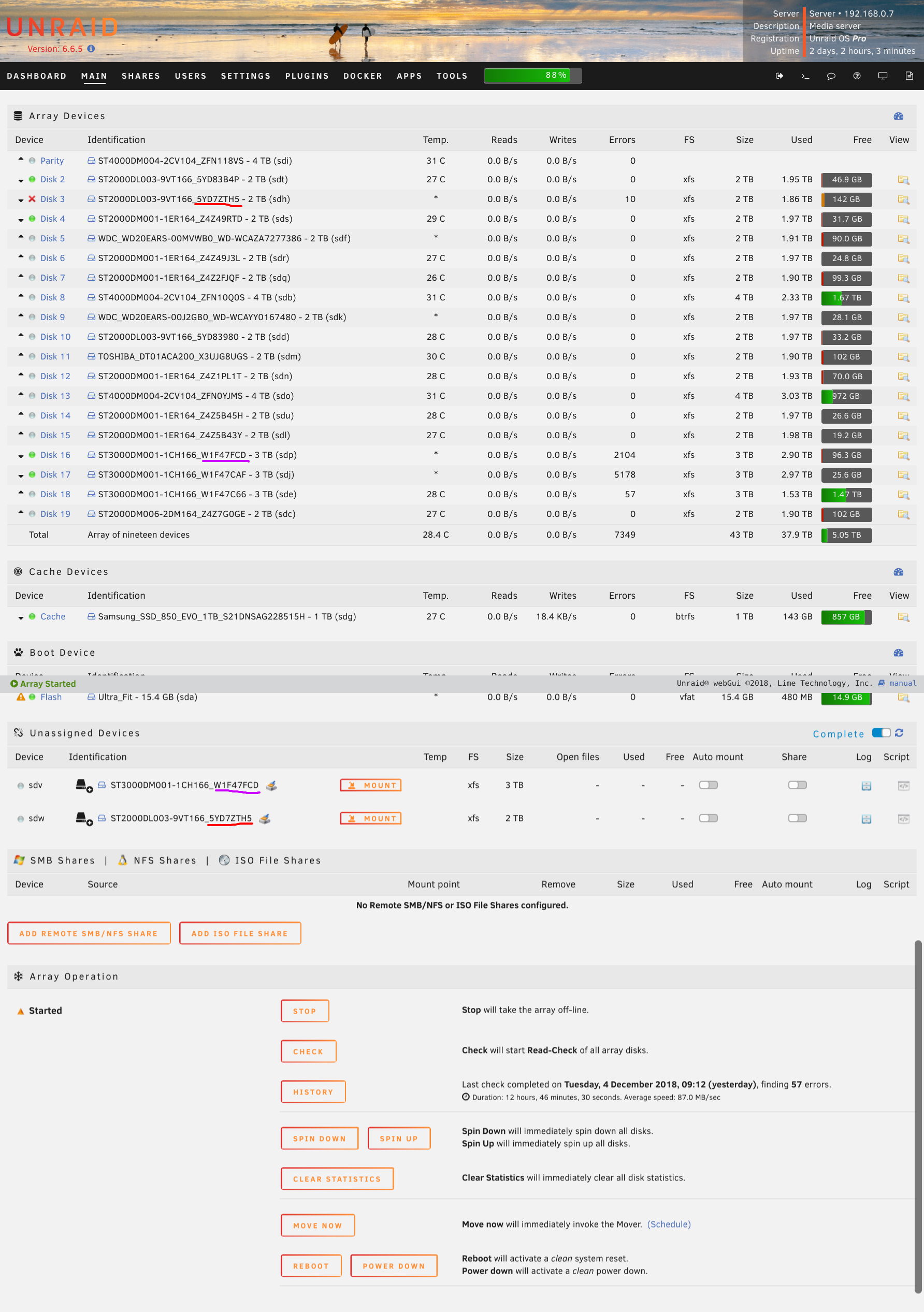

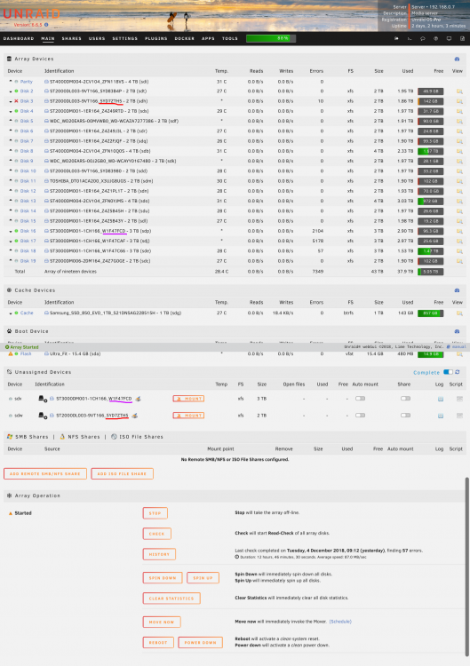

Today, I have the same symptoms again but with a different drive again - diag attached prior to doing anything:.
I notice that two drives from my array appear in my unassigned drives section on the main screen.  One of them is the drive reporting failed and the other claims to still be healthy in the array, screenshot below:
Array still started but not happy at all,  lots of data missing :(
Am I doing something really wrong somewhere, been running Unraid for a very long time without issues at all, seems to be all wrong right now!
Please help!
server-diagnostics-20181205-2219.zip
You are using Marvell controllers with ports multipliers, Marvell controllers by themselves are not recommended and are usually trouble, connected to a port multiplier you are asking for trouble, replaced them with LSI HBAs and your troubles should end.

1 minute ago, fysmd said:
I do not have any stand-alone port multipliers, could they be a part of the card I'm using??
The two Marvell controllers you have (they appear to be 8 ports each) have a builtin port-multiplier, and while one of them seems to be behaving for now the other one filled the log with ATA errors, timeouts, disconnects, reconnects and such.
