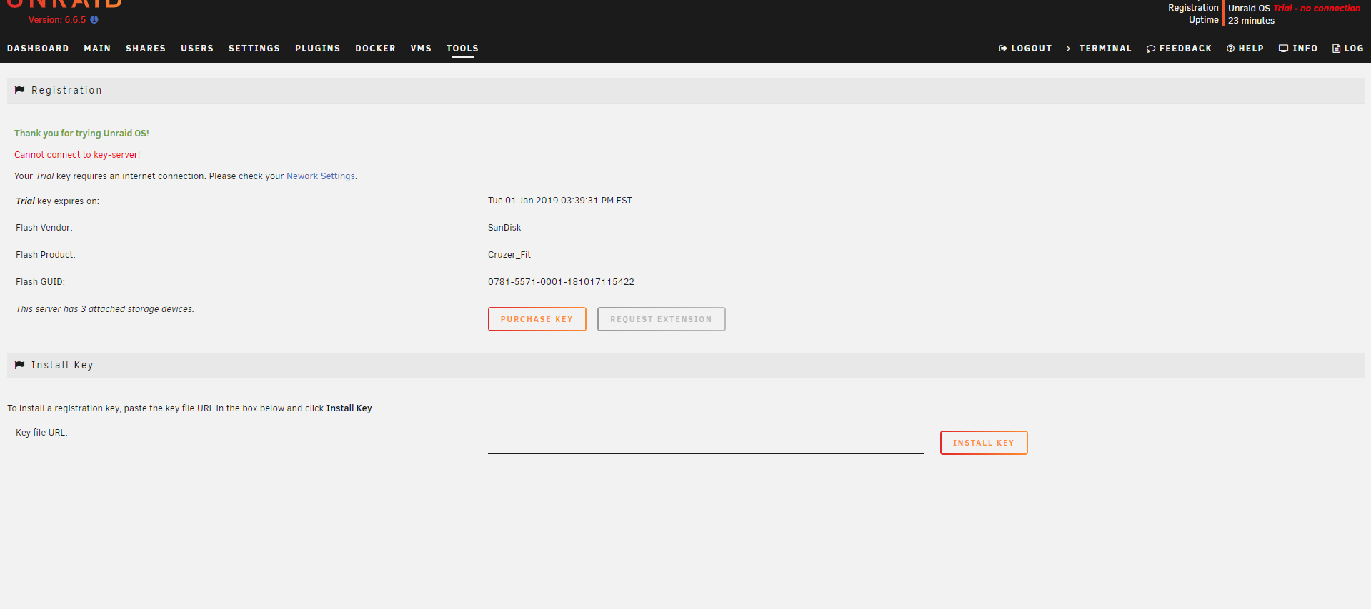

I set up the bootable USB using the software from the website. I am able to connect to the system by entering my IPv4 address in to my web browser. Here's where my issues begin...
Upon logging in, I selected "Start Free Trial" from the registration page. It then gave me a big green check mark (success) notifying me that my trial had been started. Now, however, I am getting the following error: "Cannot connect to key-server! Your Trial key requires an internet connection. Please check your Network Settings." I have attached a screen shot of this.

Did you try clicking on the Network Settings link displayed on that page? You shouldn't need a static IP, but you might need to change the DNS. Can you ping anything on the internet from your server?

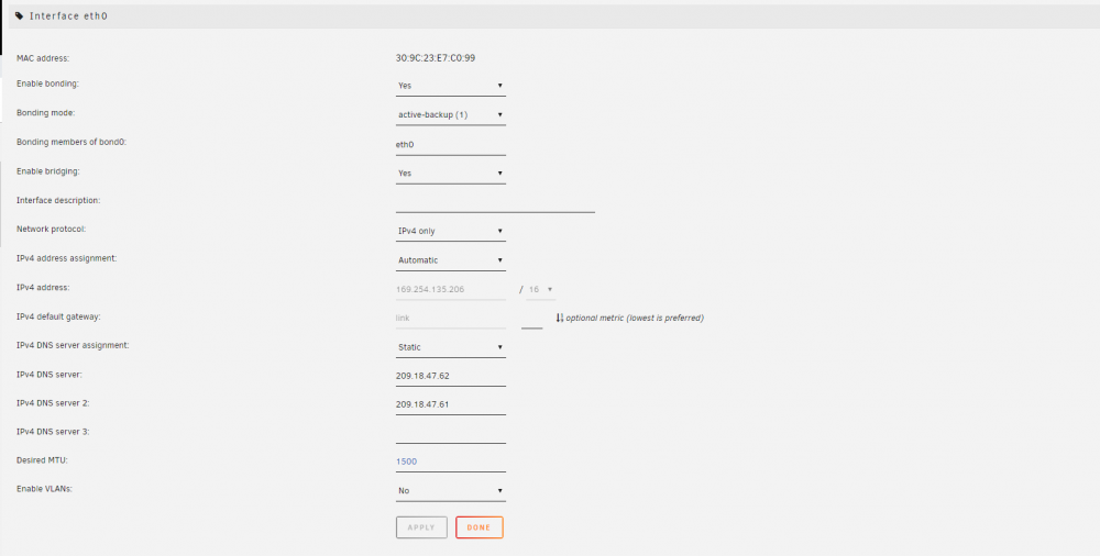

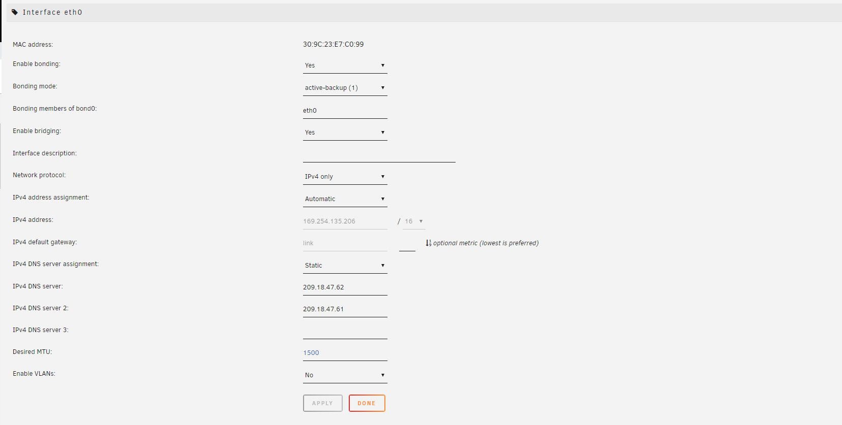

The IP address displayed in that screenshot means you aren't getting DHCP from your router. Do you have any evidence that your server is working on your local LAN?

Your server is fine, though you've made changes to the network configuration. The problem is this:
Dec  2 18:22:04 Tower dhcpcd[1839]: br0: carrier acquired
Dec  2 18:22:04 Tower dhcpcd[1839]: br0: soliciting a DHCP lease
Dec  2 18:22:09 Tower dhcpcd[1839]: br0: probing for an IPv4LL address
Dec  2 18:22:14 Tower dhcpcd[1839]: br0: using IPv4LL address 169.254.135.206
Dec  2 18:22:14 Tower dhcpcd[1839]: br0: adding route to 169.254.0.0/16
It's asking for an IP address from your DHCP server (usually a function of your router) and not receiving one. Therefore it's defaulting to a link local (or "zero config") address that will allow a degree of local connectivity but no Internet access.
First, reset your network configuration to the default by changing it back to how you had it in the screenshot you posted in the third message in this thread, then change IPv4 DNS Server Assignment back to Automatic. Click Apply.
