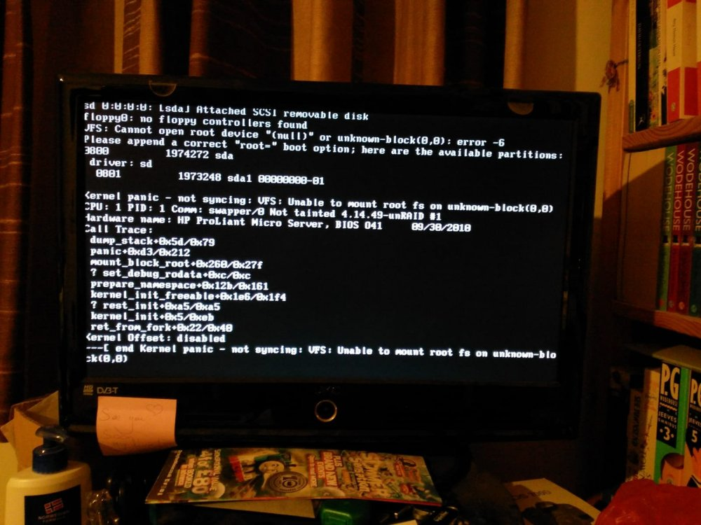

 I was hoping to get some direction on what to try next. My server won't boot after I gracefully powered it down last night.
This is the error:
Kernel Panic - not syncing: VFS: Unable to mount root fs on unknown -block (0,0)
what I tried after reading some of the other threads:
- chkdsk on the flash drive - comes out clean
- re-formated and re-initiated the USB stick with backed up config folder - still crashes with the same error
I'm currently running Memtest and will leave it on overnight, but I somehow don't think a bad memory will be the culprit here. Is there anything else I can try? What are my options after the Memtest comes out clean?

thanks for the reply,
I have updated the config file as you suggested, then I just get:
VFS: Cannot open root device "sda" or unknown-block (0,0): error -6
Please append a correct "root=" boot option: here are the available aprtitions:
0800     3052392 sda
 driver: sd
  0801   30523375 sda1 c307e18-01
memtest ran twice without reporting an error. It fails on the same spot when booting so I'm really not suspecting the RAM to be the culprit here.
thanks again for any feedback

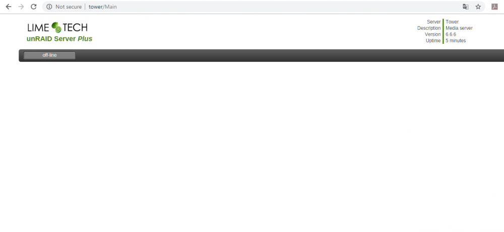

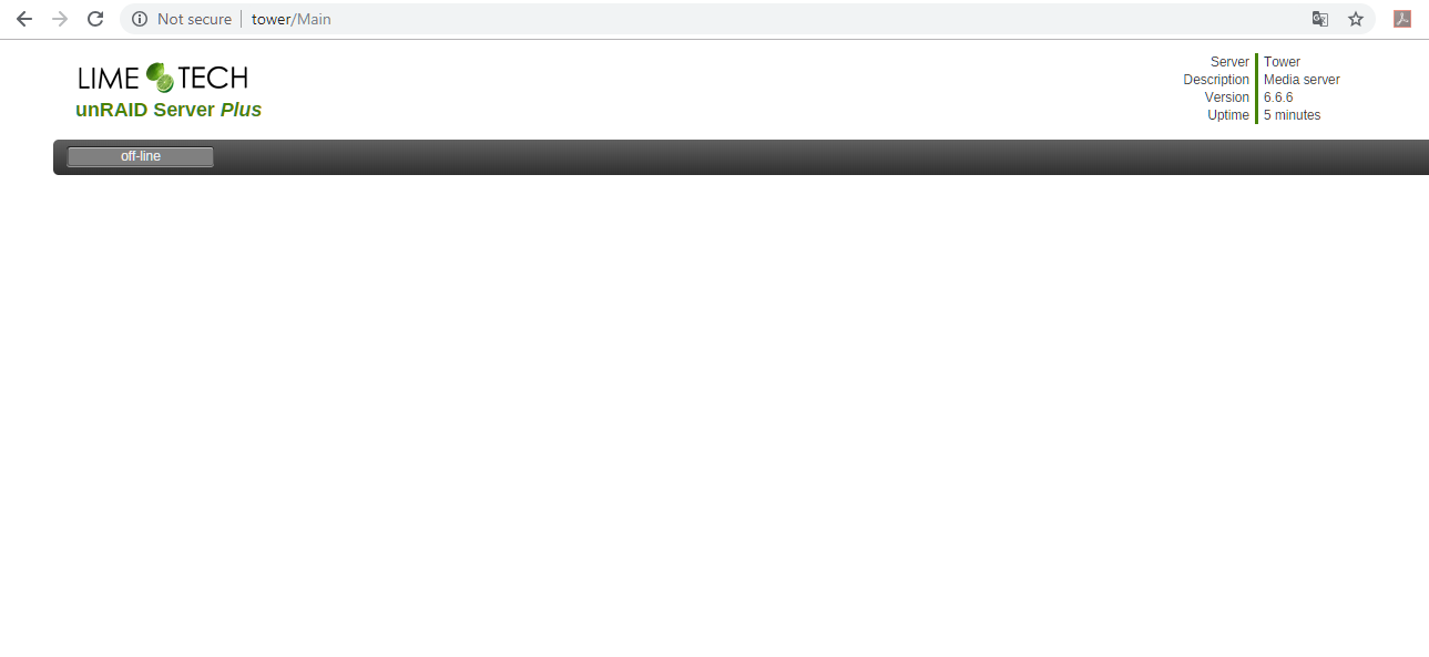

ok, so I downloaded the latest version and set up the USB key from scratch, only replacing the CONFIG folder.
the server now boots up, but I only get the banner from the GUI, nothing else
Edited by daan_SVK
On the flash drive, delete config/plugins/dynamix.plg, reboot and the GUI will come up.
all sorted, thank you so much for your help.
