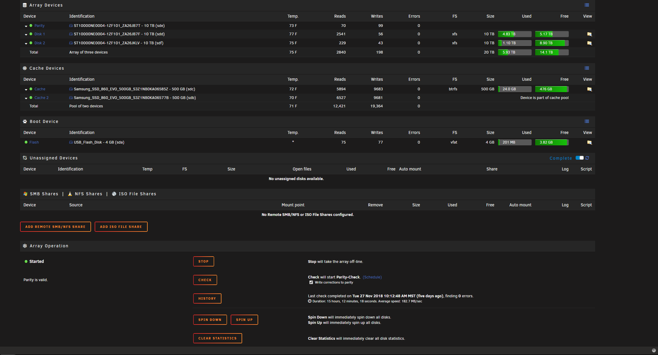

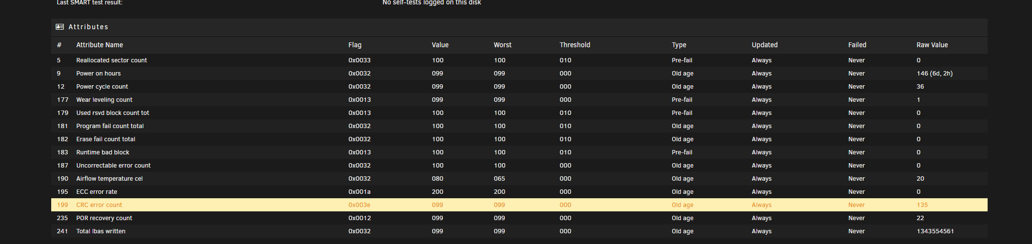

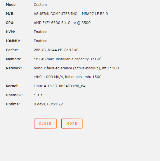

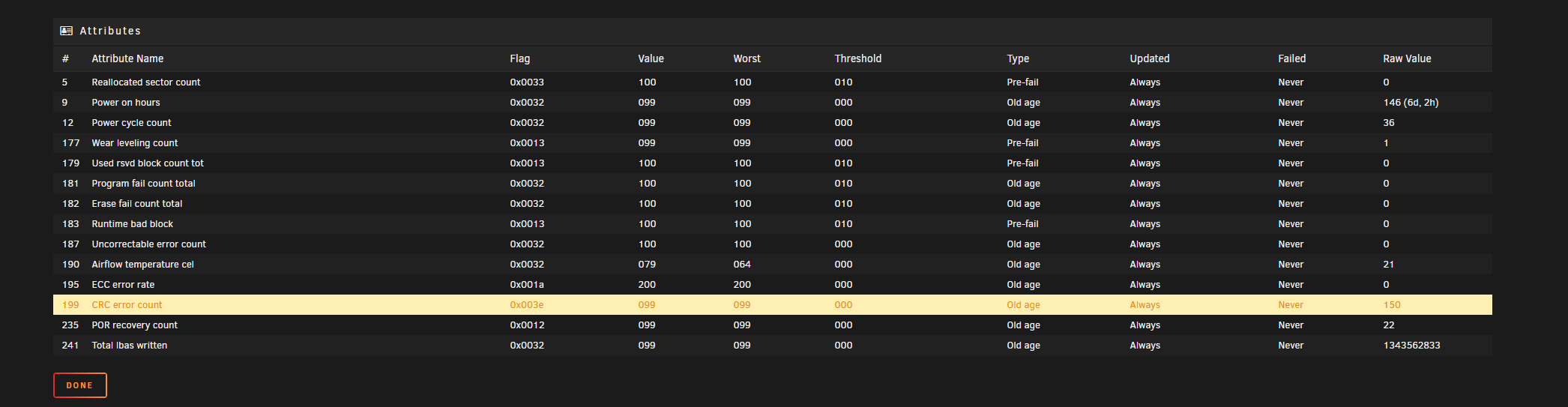

I'm getting CRC errors up the wazzo on my 2 cache drives in raid1 with 2 500gb SSD's. I've done a search for CRC Errors on the forums and have purchased new SATA cables, installed them and moved SATA ports around. that didn't change anything.
I've read the start here section and have gathered some info and I'll post below. Hopefully, I didn't miss anything.

Samsung SSDs can be picky about cables, make sure you're using good quality SATA 3.0 cables, if it's not the cables it's likely the SATA controller.
Curiously your board appears to have 6 SATA ports but only 5 are being detected.

Currently, I only have 5 drives in use. I used Hi quality shielded cables from cable mod.  Hopefully, It's not the board! Most modern cables are SATA 3.0 right? That could be an issue...

I know, I was referring to the fact that the controller is being detected as a 5 port controller, that's not normal:
Dec  2 19:54:20 rexsteel kernel: ahci 0000:00:11.0: AHCI 0001.0200 32 slots 5 ports 6 Gbps 0x1f impl SATA mode
Ah.... Seems like I might need a new board.

A Pci-e sata card fixed it!!
