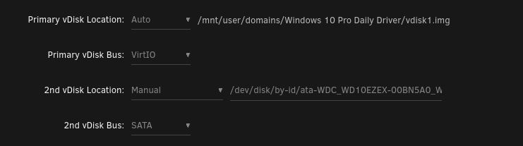

June 3, 20206 yr Has anyone found a way to fix this? Stuck on Updating.. I read a comment where you need to remove ata before the disk and that resolves it? Is that true? So if I was to use this /dev/disk/by-id/M_Series_NVMe_SSD_256G_205465464564565 Instead of this /dev/disk/by-id/ata-M_Series_NVMe_SSD_256G_205465464564565 It will work?
June 3, 20206 yr 16 minutes ago, alitech said: Has anyone found a way to fix this? Stuck on Updating.. I read a comment where you need to remove ata before the disk and that resolves it? Is that true? So if I was to use this /dev/disk/by-id/M_Series_NVMe_SSD_256G_205465464564565 Instead of this /dev/disk/by-id/ata-M_Series_NVMe_SSD_256G_205465464564565 It will work? If its any help, this is how mine looks for the 2nd HDD thats passed through /dev/disk/by-id/ata-WDC_WD10EZEX-00BN5A0_WD-WMC3F2418
