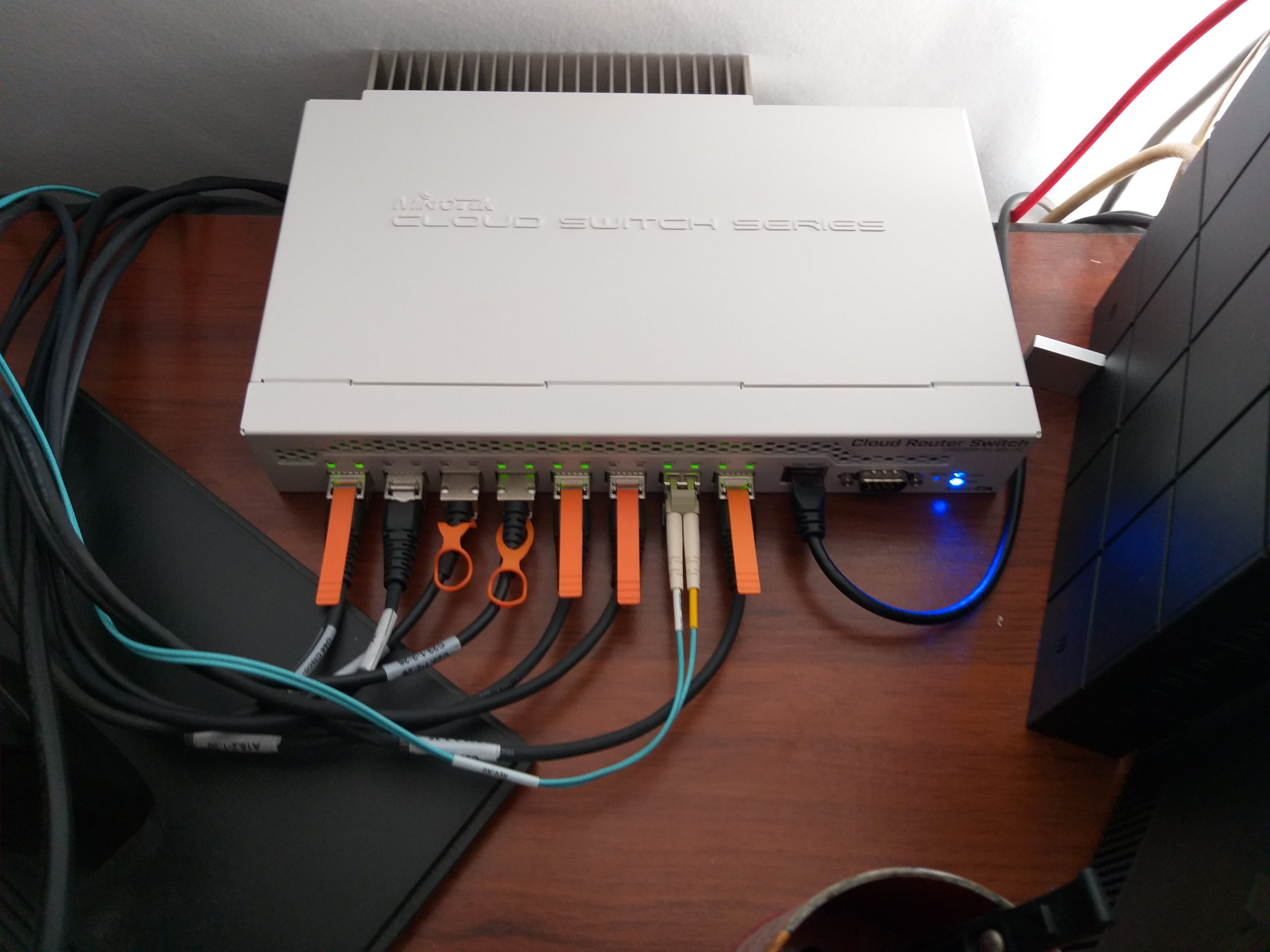

Just a heads up there's also a new 8 port model, not much more expensive, also fanless, very low power consumption, around 7w with 2 or 3 links, only have it for a few days but very happy so far.
