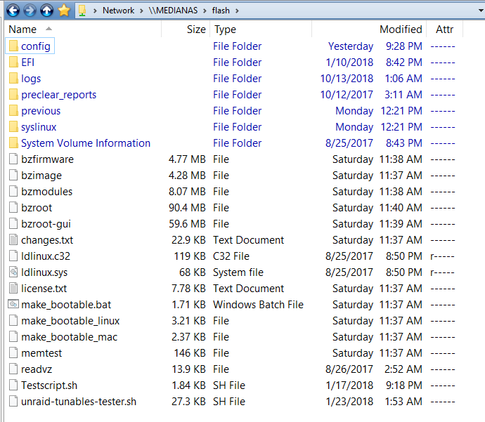

Once you get your other issues resolved and can get into the GUI again, click on the flash drive on the main page and set flash share to be exported.
Flash will then show up in your list of network shares and you can see and edit its contents from another computer on the network
