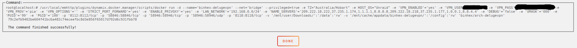

Post docker run command of Delugevpn. You can get docker run command by following instructions here (first link in Docker FAQ):
