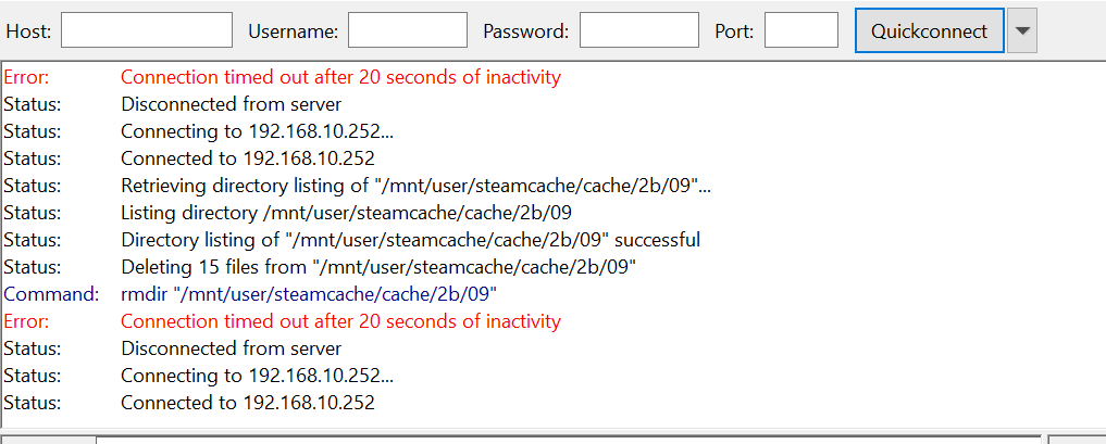

I've now removed the docker and want to delete the files so i can remove the share (freeing up around 900GB), however, when i browse to the share and select / delete the files (via SMB), it always ends up timing out and locking up the entire server.  It does the same thing if i connect using FileZilla, it just keeps timing out and reconnecting, eventually locking up the server.

Bit more info.  So the web interface isn't accessible at all, but the SMB shares are, and the dockers are up (pi-hole etc)
Filezilla keeps timing out over and over when trying to delete the files, and this also causes some dockers to hang (sabNZB)

It appears the issue here is the Seagate Archive  drive the Steam files are on.  I believe the cache on the drive is filling up, causing the entire array to stall
These drives are apparently fine for large media files, but crumble under many small files.  Lesson learned.
