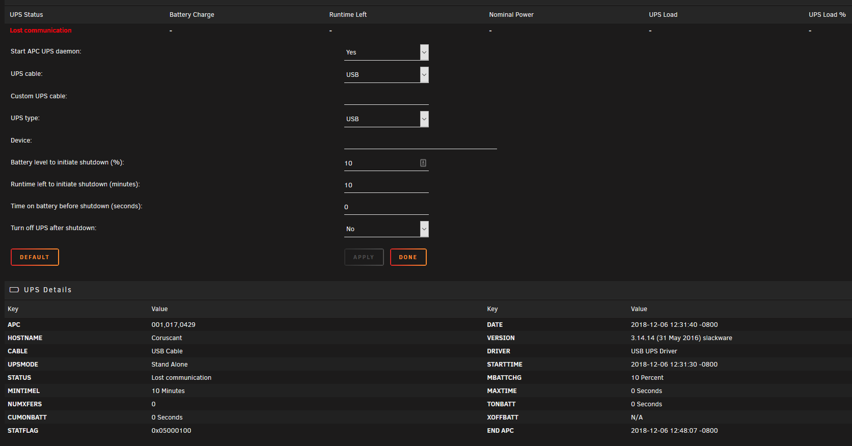

A couple months ago I purchased the CP1500AVRLCD for my Unraid server. I read on here, before I purchased it, that it works with Unraid, but I can't get it working. No matter what I try the UPS Status always reads "Lost Communication". Would someone mind sharing their configuration for this UPS?

I've tried them all, and all I get is "Lost Connection". I did a fare amount of research before buying a UPS to make sure I got one that people have used and works with Unraid, and almost all users who bought Cyberpower UPS' in general have "USB Cable" and "USB Type" set to "USB" and it works just fine.
I did do a little digging over the weekend and noticed that the UPS doesn't show up in the System Devices area under USB Devices. Should it? Can I plug anything into it and have it detected or are only certain devices detected? Also, is it labeling the USB as 1.1? My system isn't that old... I'm wondering if Unraid is incorrectly detecting the USB ports on the system.

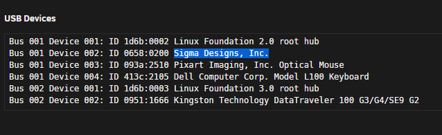

Did you ever figure it out, I got the same UPS, and I have the same issues (also not detecting the UPS in the USBs...
Yeah well, in my case, the UPS was defective (USB wasn't detected anywhere, tried different stations)... So nothing to do with UNRAID
Returned it and ordered an APC, not taking any chance...
