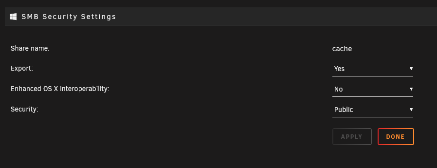

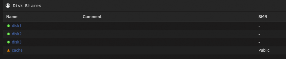

Cache is a disk share (located on the Shares page).  Click on it and set the sharing as desired.
I have temporarily set mine as Public as an example (although Secure or Private would be better if you really want to share it).
I have set mine as Public as an example (although Secure or Private would be better if you really want to share it).
I don't share disks, just user shares for the reasons trurl mentioned.  It would be too easy to inadvertently do something that could cause data loss.
