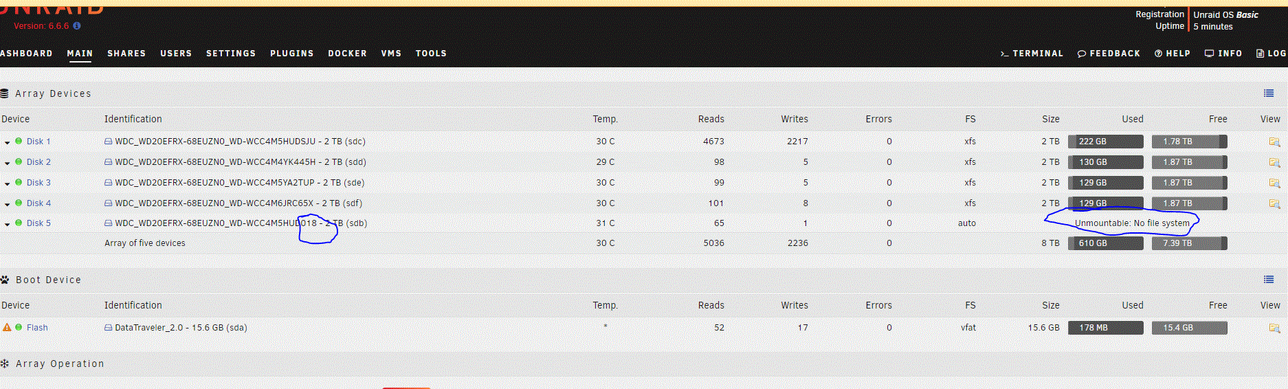

Assign all disks to data slots and no disks to parity. The disk that comes up as unmountable is parity. If more than one is unmountable seek additional help.
Hi Constructor - so far so good.
Put all into the array - and started - identified disk xxx018 which was un mountable (Capture 1)

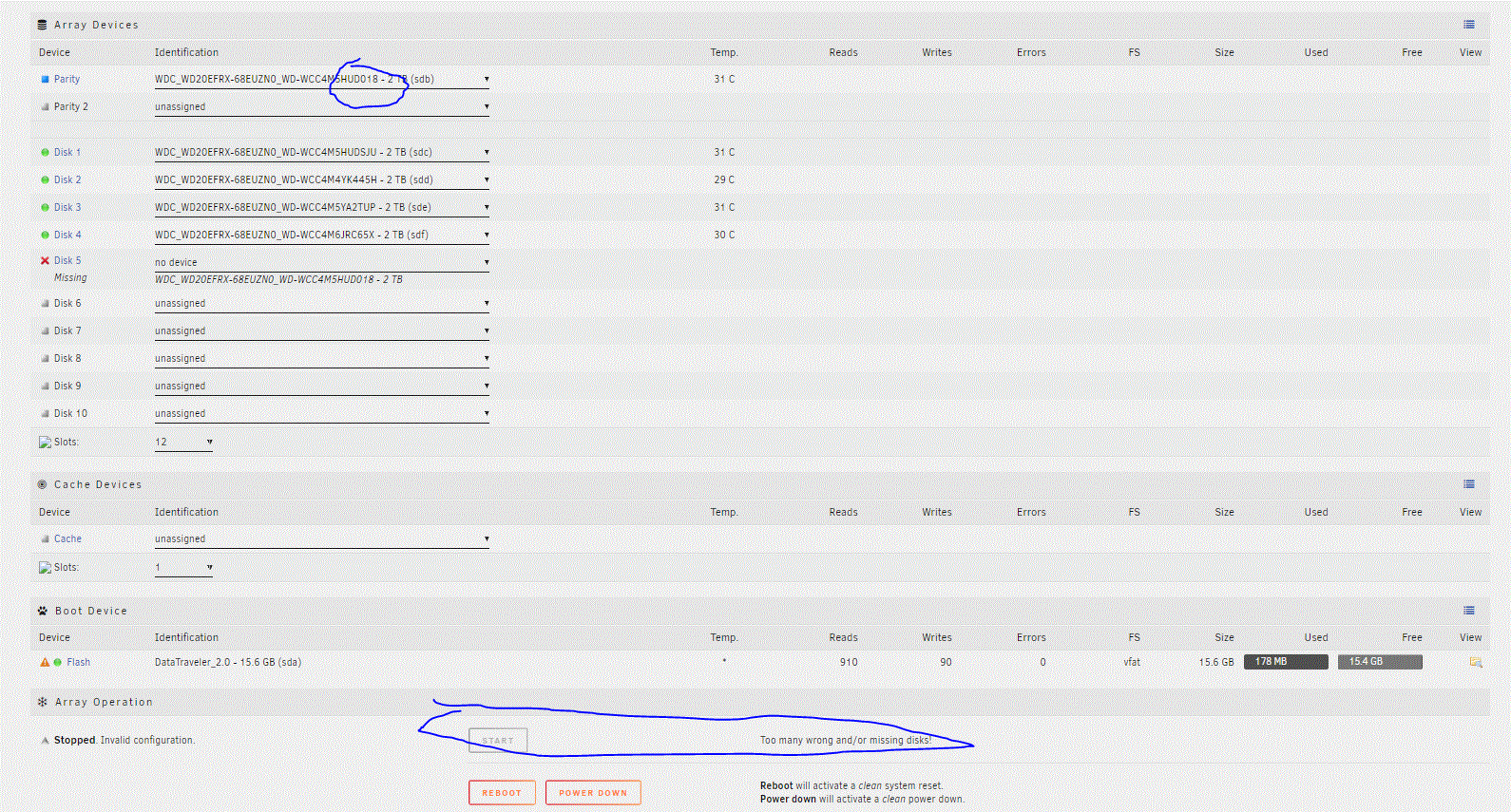

So de-selected from the array and put into the parity (Capture2) - and the array wont display as startable.
I've left config this way and rebooted, and upon re-start puts disk xxx018 back into slot 5?

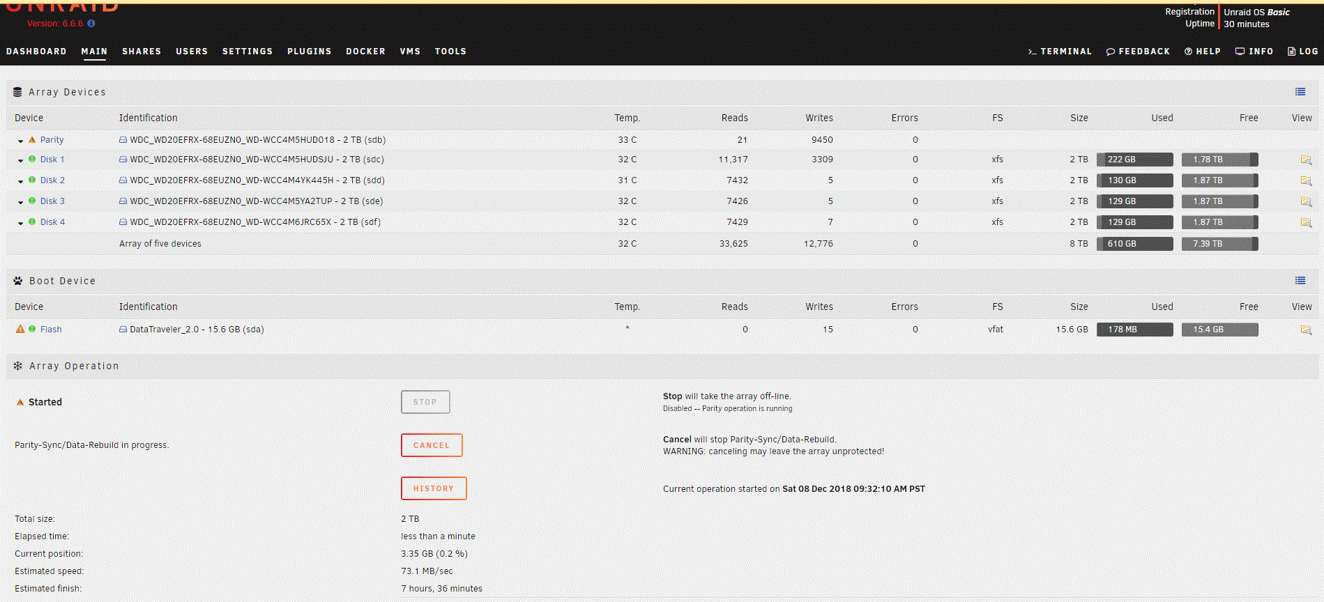

You have to set another new config to move drive around again. Now that you know where things are supposed to go, you can select the checkbox for parity is already valid and just do a parity check.
Make sure it's a correcting check since a few sync errors are expected.
Right - done a new config - but it's now saying "PARITY IS INVALID" when i hover over the drive error - the triangle
That means you didn't check parity is already valid, just let it finish
Ah right - so it's doing a check of the array - and will be back on line at the end of the rebuild?

All your shares should be online and available now. However, you should avoid a whole lot of file activity, as it will slow down the parity build.
If you had users and user security set up, all that will be gone and need to be reset.

All back on line, parity check took 5 1/2 hours, thanks Again....
