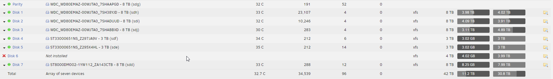

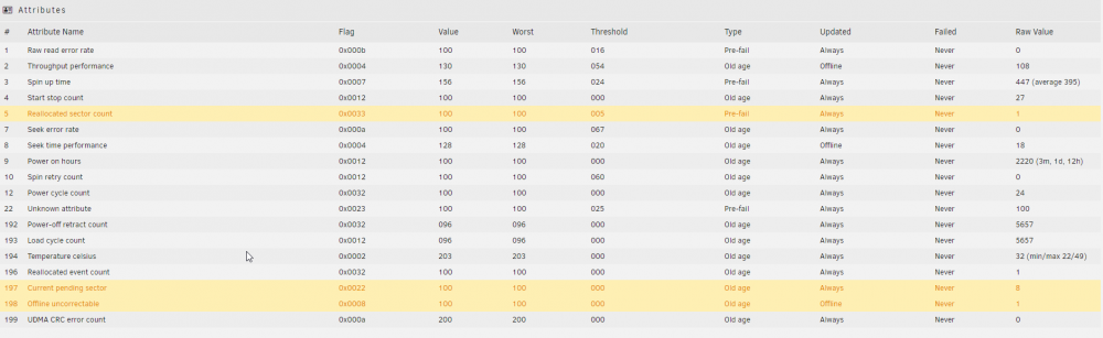

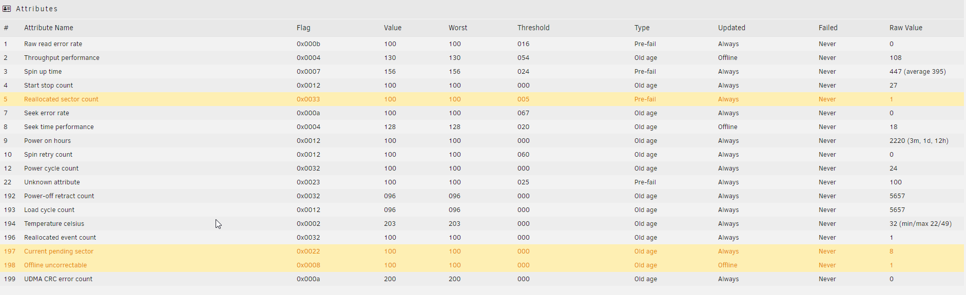

My current array consists of a total of 9 drives (5 X 8TB, 2 X 3TB, 1 X 4TB and 60GB SSD cache). Obviously my parity drive is one of the 8TB models. I started getting notices the other day that the 4TB and the 8TB parity drives were throwing errors. Specifically that the parity had 198 errors with current pending sectors at 8 and offline correctable at 1. The  4TB has 768 errors. The 4TB was marked as being offline and is no longer able to be mounted. Furthermore, I performed a read check on the 8TB parity drive and it finished with 128 errors after some 18 hours running.
1602400437_UnraidparitydriveSMARTreport.thumb.png.5867defb941de27cd316a6579bf64a13.png

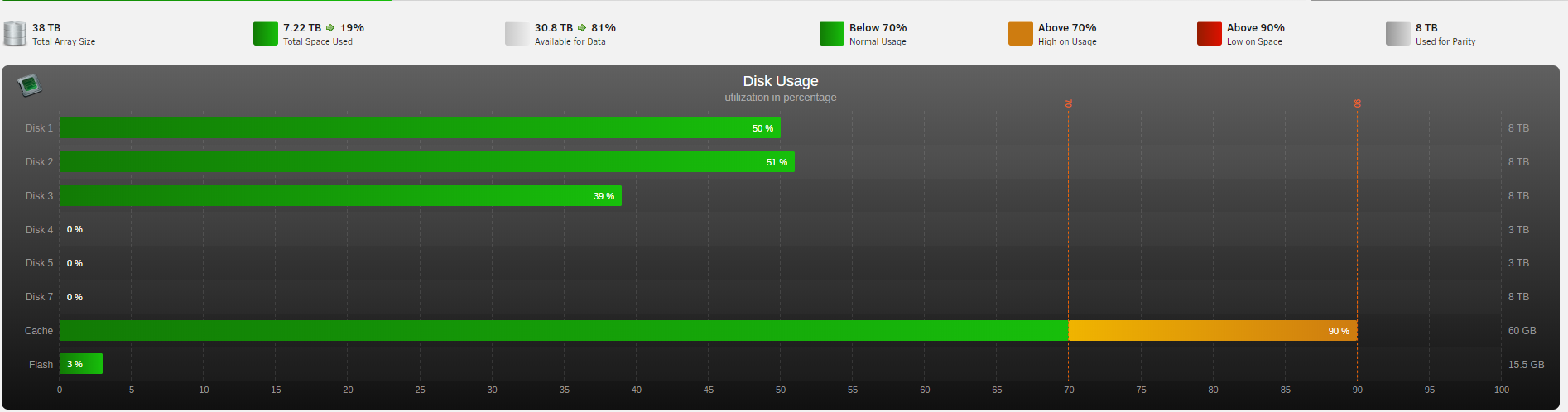

OK...Makes sense. 2 thoughts come to mind though. a) I don't know how to mount it and the GUI will not let me and b) to the best of my knowledge no data has been written to it as of yet. Doesn't my config write up to 50% of each drive sequentially through to the end of the array? For instance disk4, 5 & 7 have no data written to them yet since disk3 has not reached 50% full yet. Picture below to illustrate.

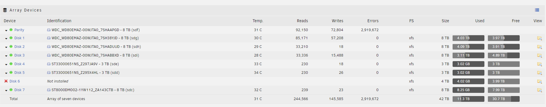

Sorry it has taken me through today to address this. I have the array stopped and am in the new config menu with the retain all setting checked. I am presented with this rather ominous warning however.695329701_2018-12-1014_34_20-NASNASHURRAY_NewConfig.thumb.png.80d7d52c2f32329247f4817f0f79f88b.png
I'm a little hesitant to move forward. However, in the interim the amount of errors on the parity drive has exploded to this1394699851_Unraidmoreparityerrors.thumb.png.541151bbfcb0170e5cf1ecda012cdf6d.png
I guess my ultimate question is how much danger am I in of losing everything on this array?

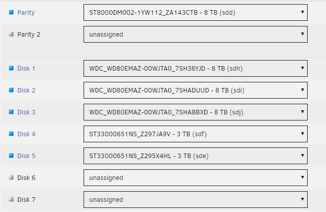

I was able to stop the array, and did as instructed. Here is screenshot from new config...1734638295_Unraidnewarraybuilddriveassignments.png.0b0453ca5785d62ee31e71c210c427b3.png
and screenshot prior to starting array1650079620_Unraidconfigpriortorestartarray.thumb.png.f342e72dae758e9a63bc8b8eb627ac70.png
I'll wait for further instructions prior to firing the array back up. Or should I power down to pull the drives from the array?
Looks good. Start array to sync parity. Check occasionally to see if it is making reasonable progress and see if it is throwing any errors. Parity sync for 8TB will take most of a day.
