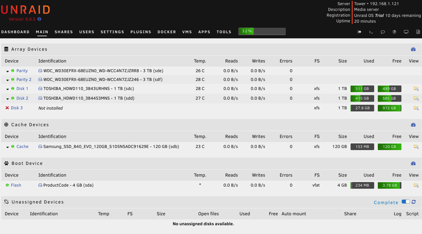

Now my question. Do I have parity check manually? There ist still the "not installed disk" visible in main tab. See below...

You didn't remove the disk correctly, it should not be listed under array devices any longer, repeat the procedure.

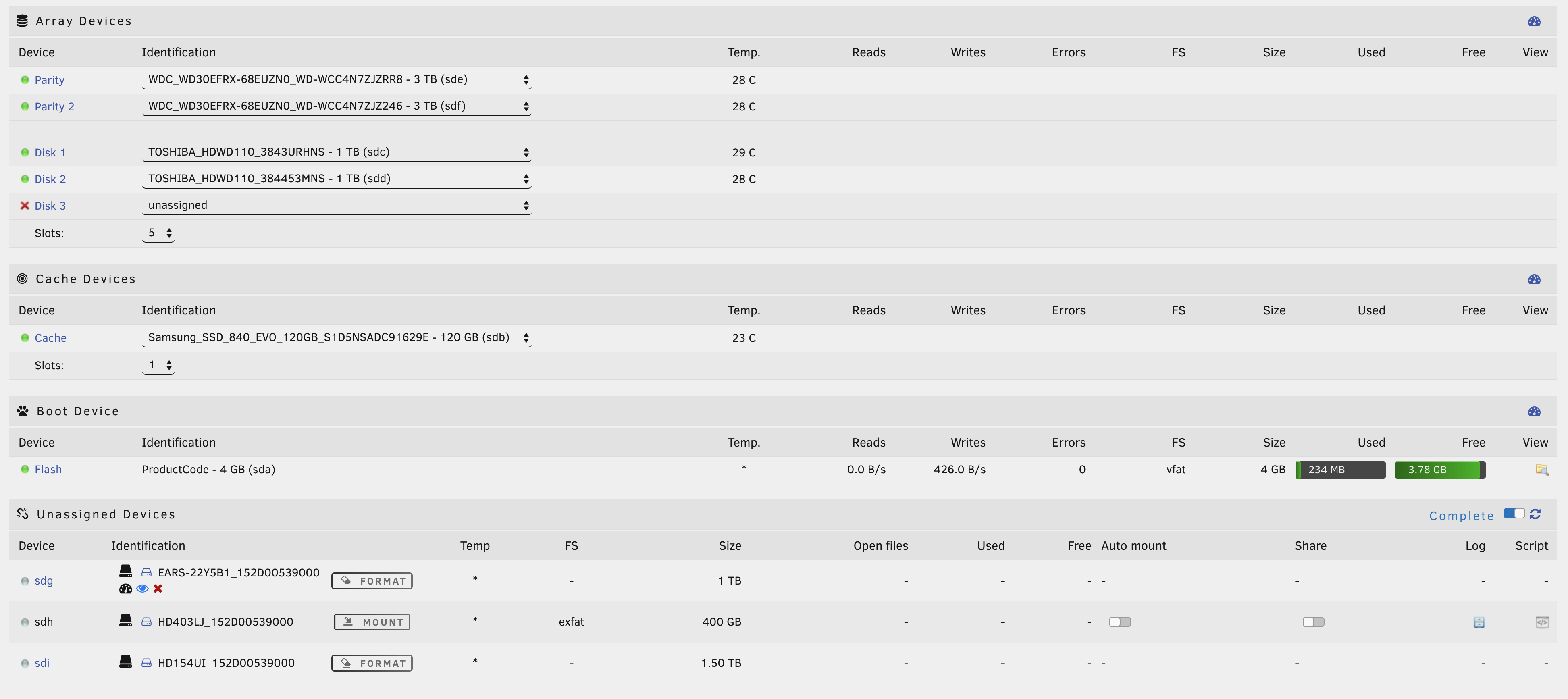

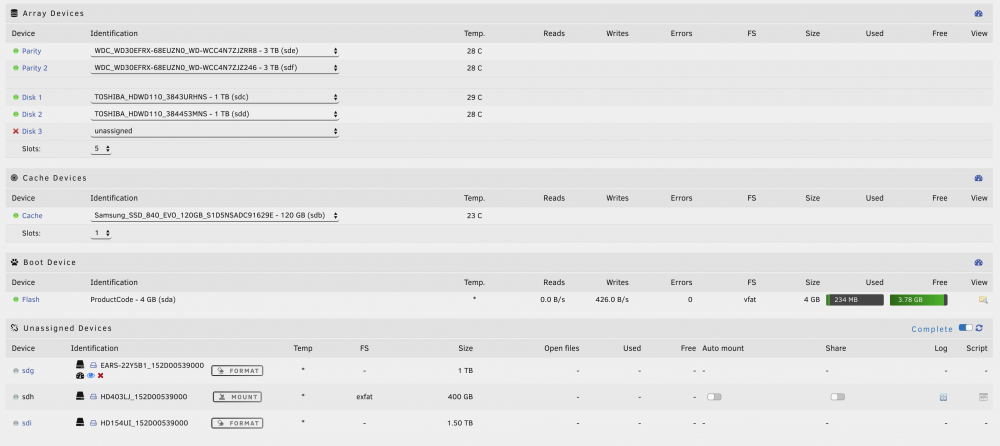

after stopping array:

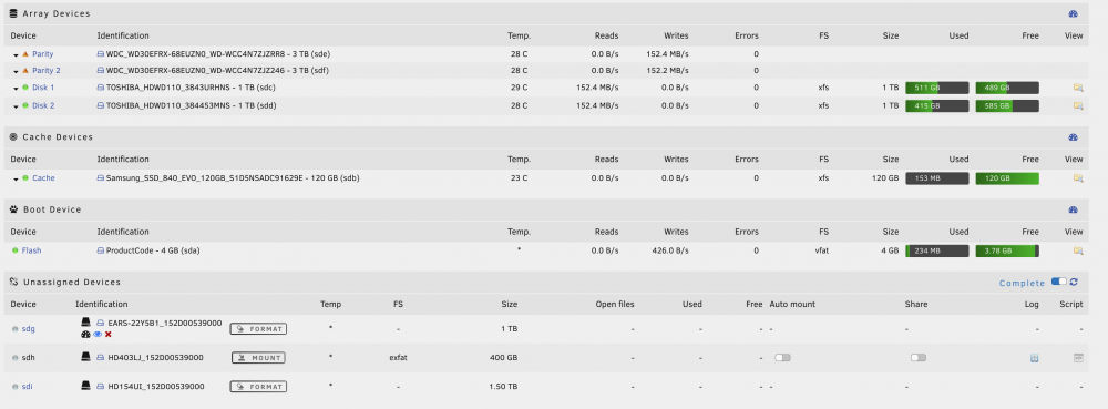

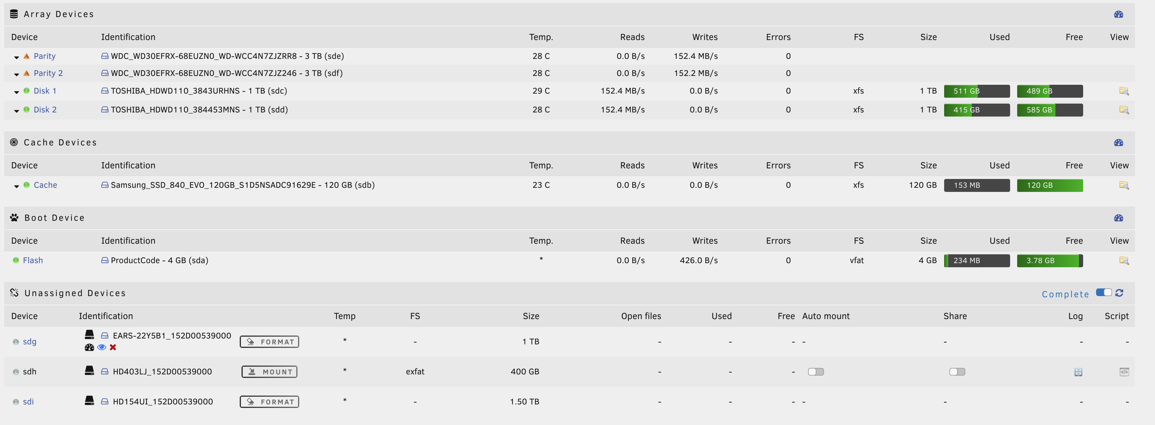

and after did an new config (with clicking on "apply") and started the array it looks perfect:
