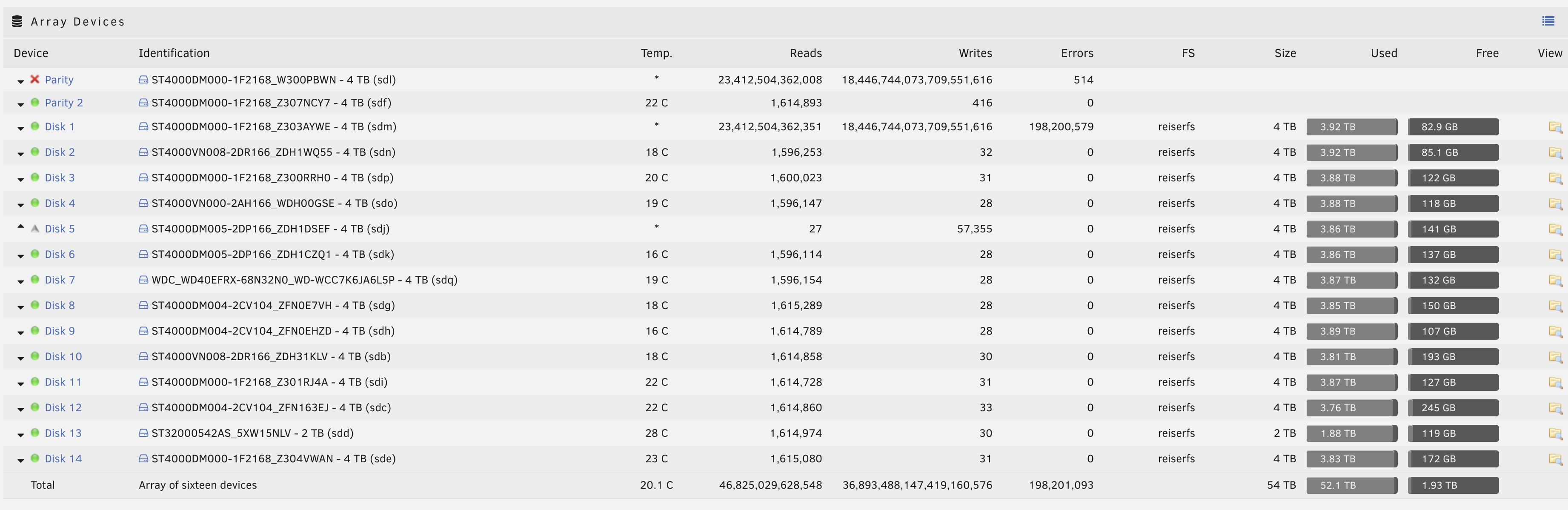

I checked on my server last night to see how much free space I had and one of the disks was disabled and being emulated (Disk5). The error pointed to a possible cable issue. I shutdown the server, reseated the cables for Disk5 and rebooted.
This morning I removed Disk5 from the array, started the array, stopped the array and re-enabled Disk 5 and started up again. The array started and the contents started being reconstructed.
I'm at work 2 hours later and I check how it's going. One of my parity drives is now disabled and Disk1 has millions of errors on it.
See pic
I must have disturbed the other cables when I was sorting Disk5 (idiot). I immediately stopped the sync.
I'm guessing I've lost the contents of Disk5?
What do I do next?

There appears to be a connection problems with parity and disk1, power down, replace both cables for those disks and try the rebuild again.
Okay thanks. Will it not matter that it has wrote errors to parity1? Won't Disk5 be rebuilt from parity1?
Nothing was written to parity1 since it dropped offline, though you'll need to resync it since it got disabled, you can do that at the same time as you rebuild the disabled disk.

Both drives are back and have no issues via smart report. Disk1 is back in the array as normal. Parity1 is still saying disabled. Do I need to do a new config? Will that effect the rebuilding of Disk5?

My array is stopped. How do I resync the parity drive?

Unassign it, also unassign the disk you're rebuilding (disk5), start the array, check that the emulated disk5 mounts correctly, stop the array, re-assign both disks and start the array to begin parity sync and disk rebuild.
That did it, thank you!
