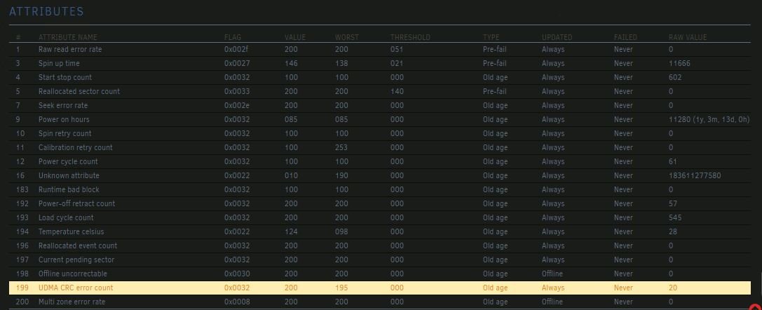

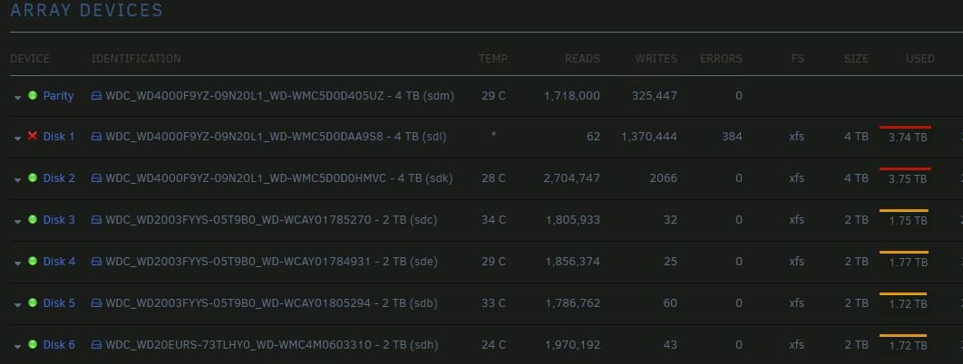

Got an issue as of lately, Disk 1 Fails with a redX and requires me to remove/add to rebuild. The rebuild usually completes fine and at a decent speed may i add.
Smart Test's show the Drive to be healthy (Quick and Extended Test).
But randomly and some stage, it will show errors (small number) and fall out the array. A few UDMA Errors but id of thought this wouldnt be enough to Kick the drive offline?.

**Please See Attached**
Those SMART errors typically are caused by a bad connection or bad cable.
Go to Tools - Diagnostics and attach the complete diagnostics zip to your next post.
Replace the SATA cable.
