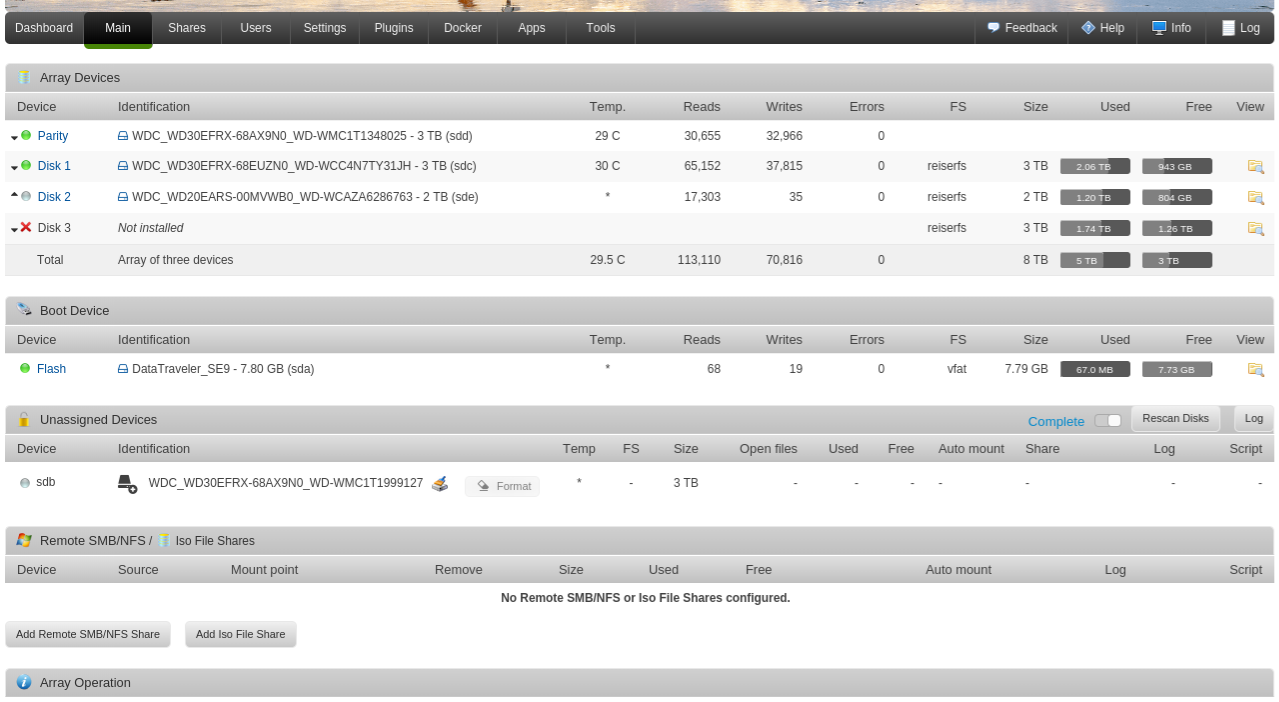

A couple of months back,  a drive failed.  I took the option (I forget what it was...)... to let the parity drive emulate the failed  (rebuild ?).  I have now managed to afford a new drive as a replacement.
So, the current situation is that the Parity drive is standing in for the failed drive ?
The array is unprotected.
So, how do I get things back into order ?  I hsve tried my best to describe the situation as below
  • I have attached the diagnostic and a screenshot of my Main page.
  • The Drive that failed was a WD Red 3TB
  • My new drive is a WD Red 4TB
  • I only have 4 drive slots
Presumably I should
1. remove the failed drive from its slot
2. plug in the new drive to that slot
3. perform a pre-clear on the new drive X 3
4. ?? presumably the old parity now becomes the actual replacement for the failed drive ??
5. ?? presumably the new drive becomes the new parity??
if so, how do I effect 4 and 5 above
Your help is much appreciated.
Parity PLUS ALL the other disks allow the data for the missing disk to be calculated. Parity by itself has none of your data.
OK, you edited your post to include screenshots while I was writing my first post. You didn't specifically mention you intended to use a disk larger than parity. Wait while I get you a different link.
You can test the disk with preclear or some other method if you want, but you don't really need a clear disk in this situation.
Yes it is and you really should not have been using it for this long in this state. If you had another disk fail during this time you would have lost data.
Emulating a disabled disk is what Unraid does automatically, no option. The word rebuild does not belong in that sentence.

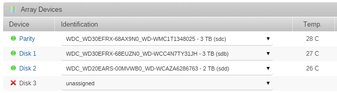

Apologies for the delay... I am now ready to rock....but I have a bit of uncertainty.... I aborted........ I am performing the parity swap procedure; in the instructions it says "IMPORTANT!!! This procedure REQUIRES that the data drive being replaced MUST be disabled first. If the drive failed (has a red ball), then it is already 'disabled', ...... I hate to be pedantic/paranoid... but I don't want to make a mistake here.... There is NO RED ball there is a RED X..... I am CONCERNED THAT when I  restart as per below... the new drive will be auto assigned to Disk 3... with adverse cosequeces.....(there is no option to unassign it and I can't power up withot the array coming back onlie)). As per the screen shot below, I have removed the failed drive.... I stopped the array... and am about to:
  • power down...
  • put the new drive into the old slot....
  • then power on again  -  QUESTION:  won't the new drive now get auto assigned to Disk 3 ??
  • stop the array again
  • assign the parity drive
Just give me some comfort here....thanks.
