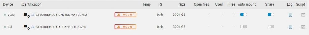

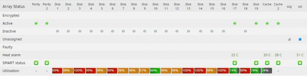

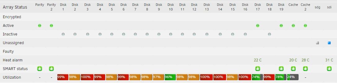

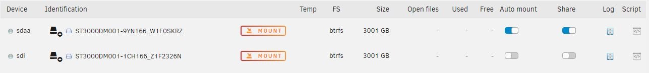

The device "sdaa" is shown within the Unassigned Devices section of the Main page but does not exist on the Dashboard. Opposite, the device "sdg" is shown on the Dashboard but not on the Main page - neither in the Unraid pools nor in the Unassigned Devices section. It's not possible to mount the device.
The result of a short self test of the device was "No Errors Logged". But syslog shows lot's of BTRFS errors (syslog attached).
1.) Why is there a mismatch in device names between Unraid and Unassigned Devices?
2.) What are the steps to mount the first disk again? If it's a BTRFS thing, how to fix that? And if the disk is faulty how to replace that disk in this RAID1?

6 minutes ago, hawihoney said:
BTW, any idea about the device mismatch?
The sd? type names are assigned dynamically by Linux and can change between boots so should not be relied on.
This particular case an be explained by the device originally getting a sd? type name that Unraid recognizes, and then getting a new name after a disconnect/reconnect which UD (which handles device dynamically changing) is using.
