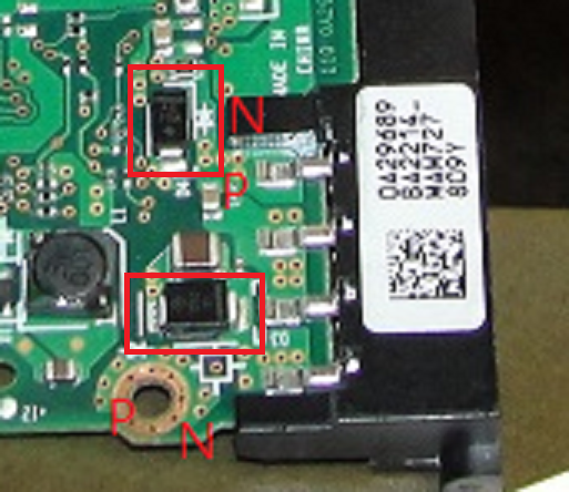

If all hdd connect with power plug haven't shutdown immediately during power on, then more serious issue was happen.
BTW a simple check (by mulitmeter) you can do, pls found 2 diode near power plug, 5v and 12v, a negative mark was connect to power +, if you got 5v or 12v on diode negative mark (N means negative, P is positive), then you can ignore problem on the diode. You need further troubleshoot.
If not success, then you need donor board, swap board usually won't work  https://www.donordrives.com/pcb-replacement-guide (this is ref. only and not up to date)

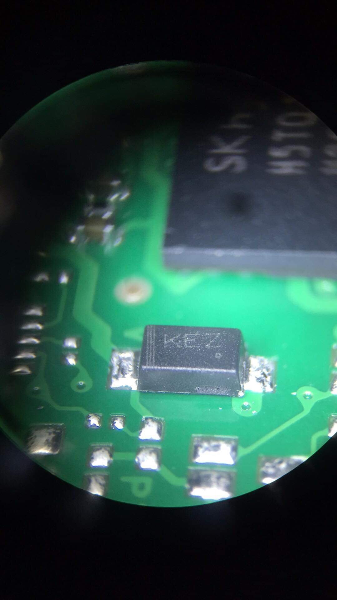

Any idea what this one is? Trying to looks for a similar piece on website like mouser electronic.
