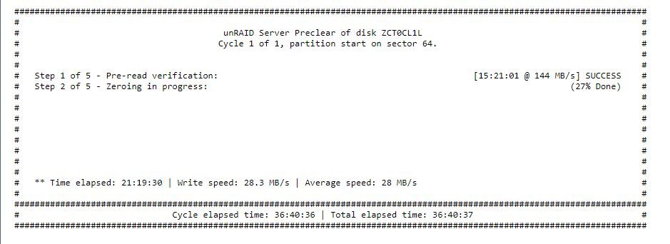

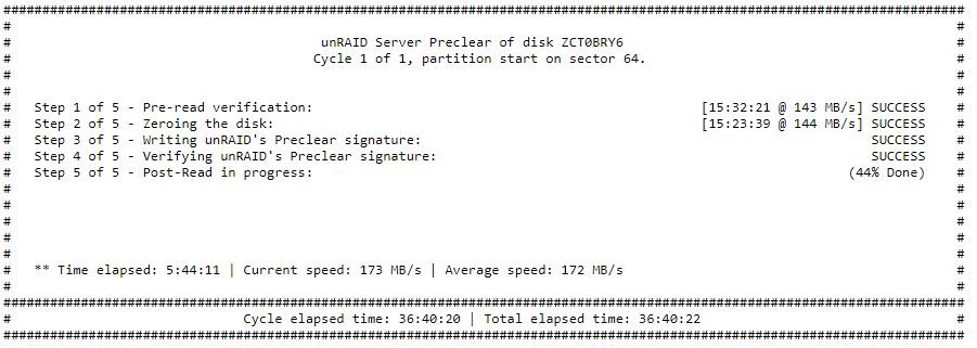

Interesting...I Started Preclear on both 8 TB Disks that i got from Costco at same time...Currently both are running (in N54L with 8 GB RAM) but i can see huge difference  in speed. Preclear is not yet completed but see the current status....

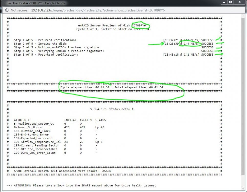

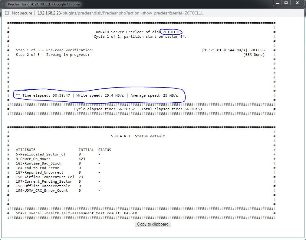

Hi Johnie and Turyl,
As you suggested I have done some test and I was wondering if you can share your inputs on same. Below is a brief summary of what i have done so far.
  1. Purchased two 8 TB Seagate Hard Drives from Costco At Same time.
  2. Both are connected to Proliant N54L with 8 GB RAM exactly in same way via SATA Connector (both connected to Motherboard via same SAS connector)
  3. There are no other Hard Disks connected to Proliant machine as of now except these 2.
  4. Unraid ver 6.6.6 was installed alongwith Community applications and PreClear Disk (from gfjardim's plugin Repository)
  5. I started preclear on both hard disk almost at same instant.

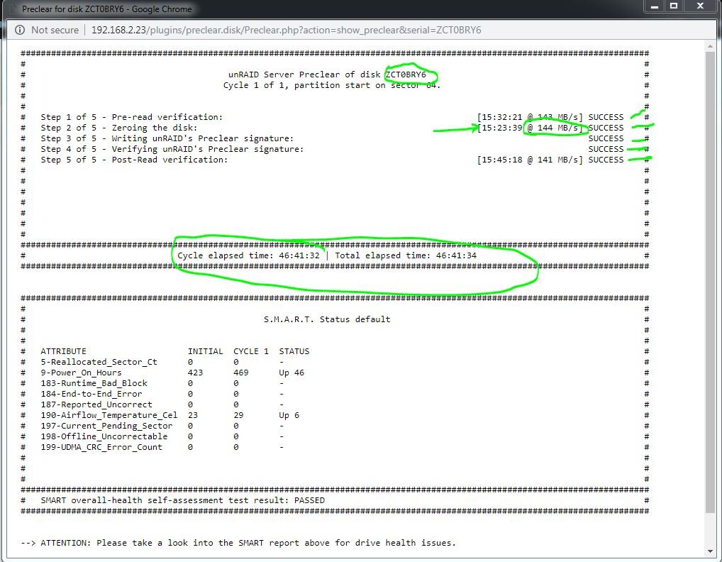

  6. Disk 1 Took in total  under 47 hrs to finish preclear. Out of these 47 Hrs it took rought 15 hrs for Step 2 i.e. "Zeroing the Disk" at average speed of 144MB/sec. Screenshot attached below.
  7. Disk 2 has already taken 66+ hrs and still preclear is not finished. Out of 66+ hrs it has consumed 51 hrs in Step 2 and still only 58% completed. Step 2 is running at average speed of 25MB/sec.Screenshot attached below.
I am feeling as if I have just got one of the bad hard disk (Disk 2) which is causing this issue but other hard disk (Disk 1 ) is correct.
Can you guys please share your views on same ?
It's possible, if the preclear stats are correct.
Hi Johnie,
What do you mean by if preclear stats are correct ? Is there any possibility of same as well ? I attached preclear results so i believe i am reading it right.
Please help.
Preclear has been known to show wrong stats and/or clear disks at different speeds when clearing multiple disks, though the results appear to confirm your issue nothing like replacing the slower disk and test to confirm.

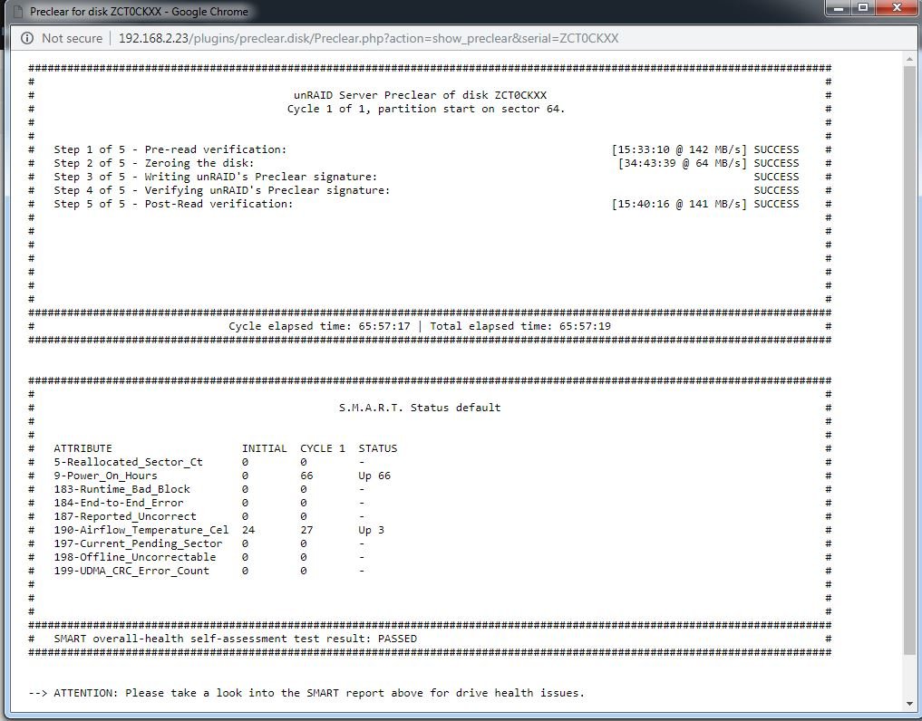

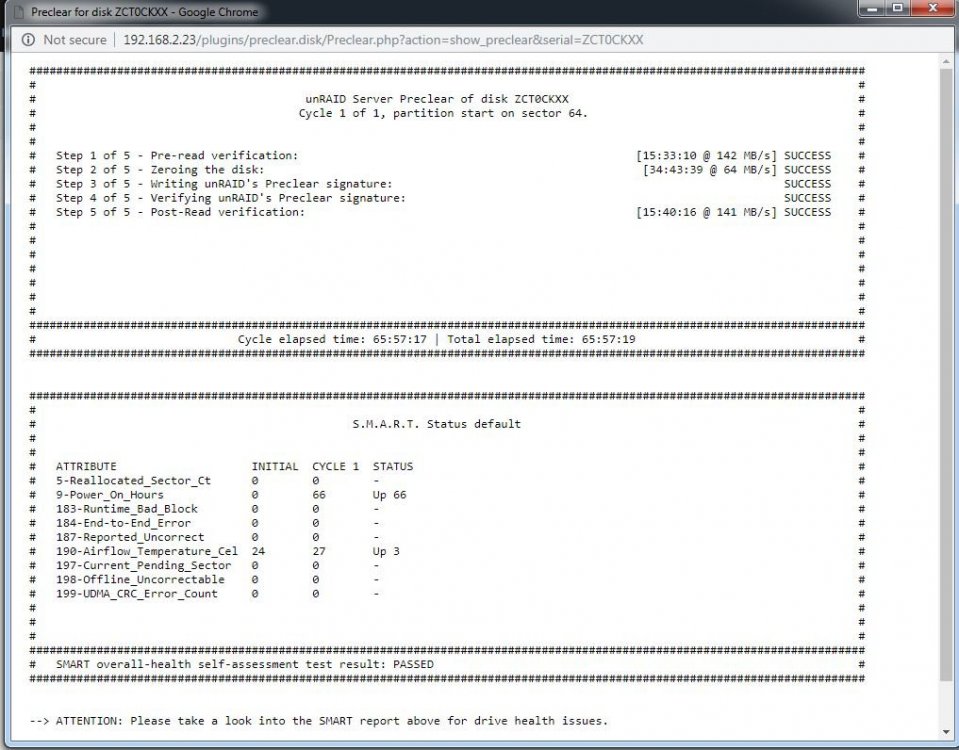

Here are the Stats when i ran preclear on new 8 TB Disk. Still Slow as compare to 1 st preclear result but much better than previous 8 TB Hard Disk.
Should I run preclear again on both Disk 1 and Disk 3 together again 2nd time ?
64MB/s average is still rather slow, but you can try using that disk in the array together with the previous fastest one, if writes speeds are now around 60MB/s instead of 25MB/s you know the disks are the problem.
