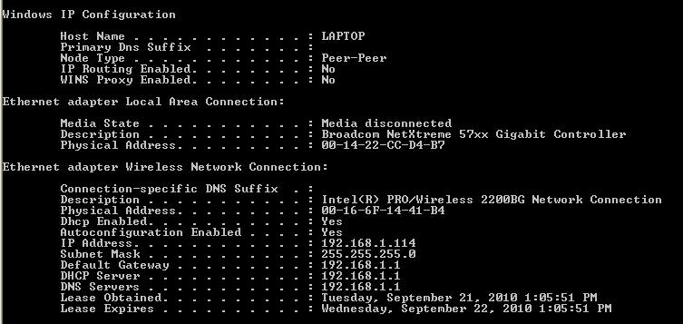

in XP, invoke a DOS window and type "ipconfig /all", post the output from this command in here.

The results from the ipconfig /all command at the dos prompt are attached.

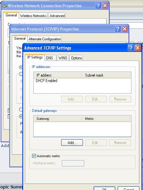

My default gateway setting is blank?  Image attached.  Do I need to put something in there?
Your IPv4 stack from Windows shown your default gateway is blank, however your ipconfig reported it has been configured to 192.168.1.1
not sure why there is inconsistent. I knew some wireless card vendor like D-LINK has their own management tools that some times
bypass those network management tools provided by Windows.
(a) Try to manually add default gateway 192.168.1.1 in IPv4 stack, see how it goes.
(b) If it doesn't help and you are using tools provided by wireless card vendor then you need to look up their manuals.
I added a default gateway of 192.168.1.1 into the IPv4 stack and it made no difference and to my knowledge I am not using any vendor specific tools to manage my wireless network adapter.
Hmmm, now what?

Hmm... one thing looks fishy to me from your ipconfig output is node type, it set to peer-to-peer. it usually set to "broadcast" mode.
you might want to look into following MSFT article for information. meanwhile you mention about your Win7 machine doesn't have problem, you might want to cross reference IPv4 setting on both machines for difference.
http://support.microsoft.com/default.aspx?scid=kb;en-us;903267

Thanks GK20.  I followed the instructions provided in the MSFT article you cited and it fixed the problem.  Now unMenu works like it should on my laptop.
