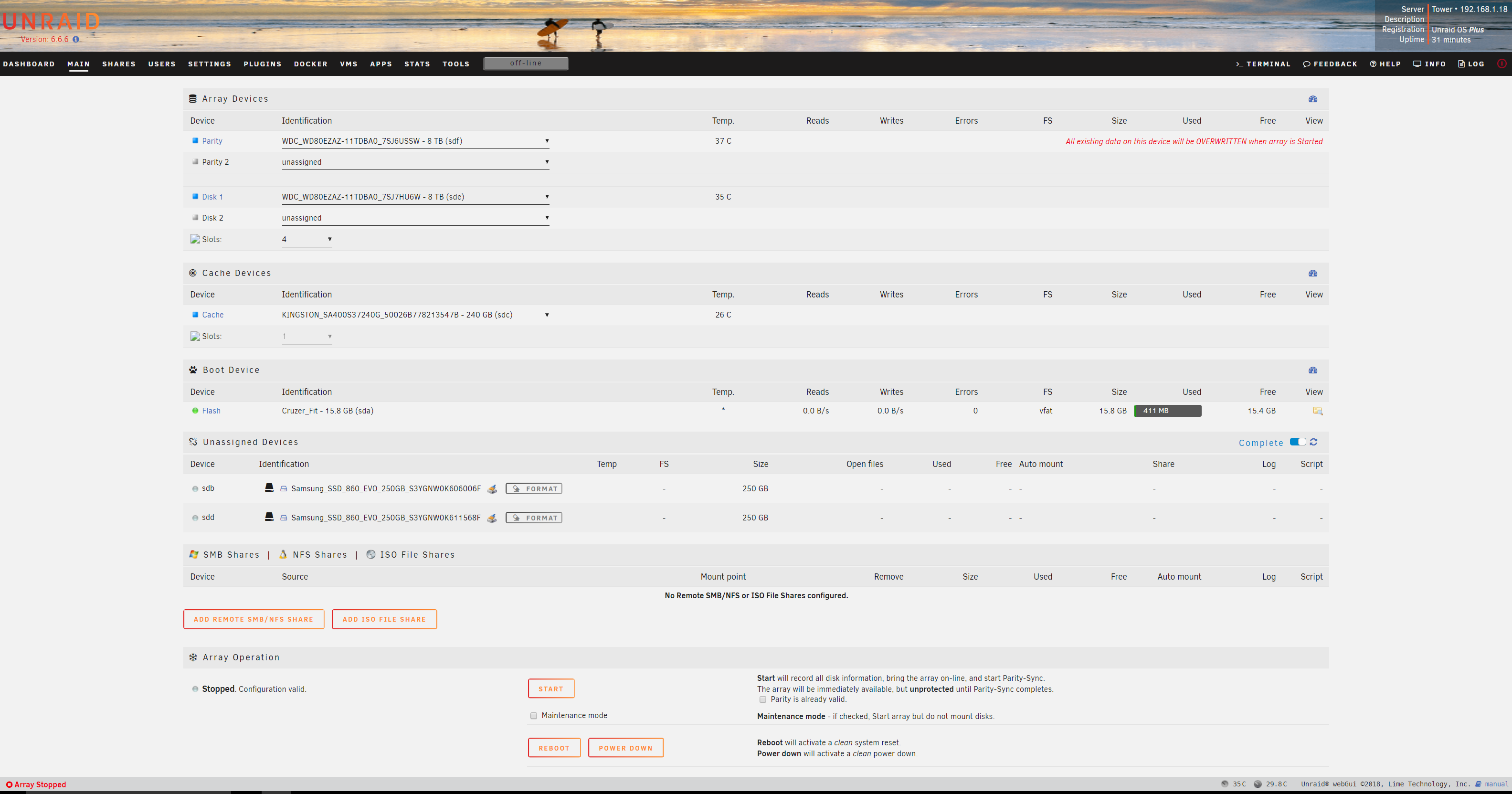

I have a drive (disk 2) that has refused to spin up, I've tested it on a few different systems and it still won't spin up.  So the array restarted and now It says that all the data on the parity will be overwritten.  it also thinks that the parity and disk 1 are new drives when they are not. How do I start up the array with the disk missing so I can access the data until the new replacement drive shows up? If I can't start up without a new drive How do I start it up without losing any data?
How exactly did you get to this state? Since parity and disk1 are in fact ALL of your disks then you must have either done a New Config yourself, or else it couldn't read your disk assignments from flash. Did you New Config?
Don't do anything else without further advice.
Go to Tools - Diagnostics and attach the complete diagnostics zip to your next post.
a few days ago I accidentally bumped the power cable on the drive and unraid refused to run off of it. So I ran a new config so It would read off the disk again and it rebuilt parity and was fine, Today I tried to add some ssd's and bumped it again, so I ran the new config but this time the drive won't spin up at all.

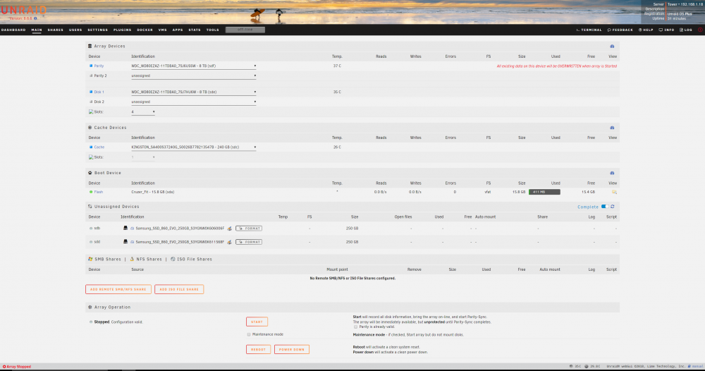

If parity is valid, and the by way you describe what happened it should be, this should work to rebuild disk2:
-Assign the new disk2
-Important - After that leave the browser on that page, the "Main" page.
-Open an SSH session/use the console and type:
mdcmd set invalidslot 2 29
-Back on the GUI and without refreshing the page, just start the array, do not check the "parity is already valid" box, disk2 will start rebuilding, disk should mount immediately but if it's unmountable don't format, wait for the rebuild to finish and then run a filesystem check
