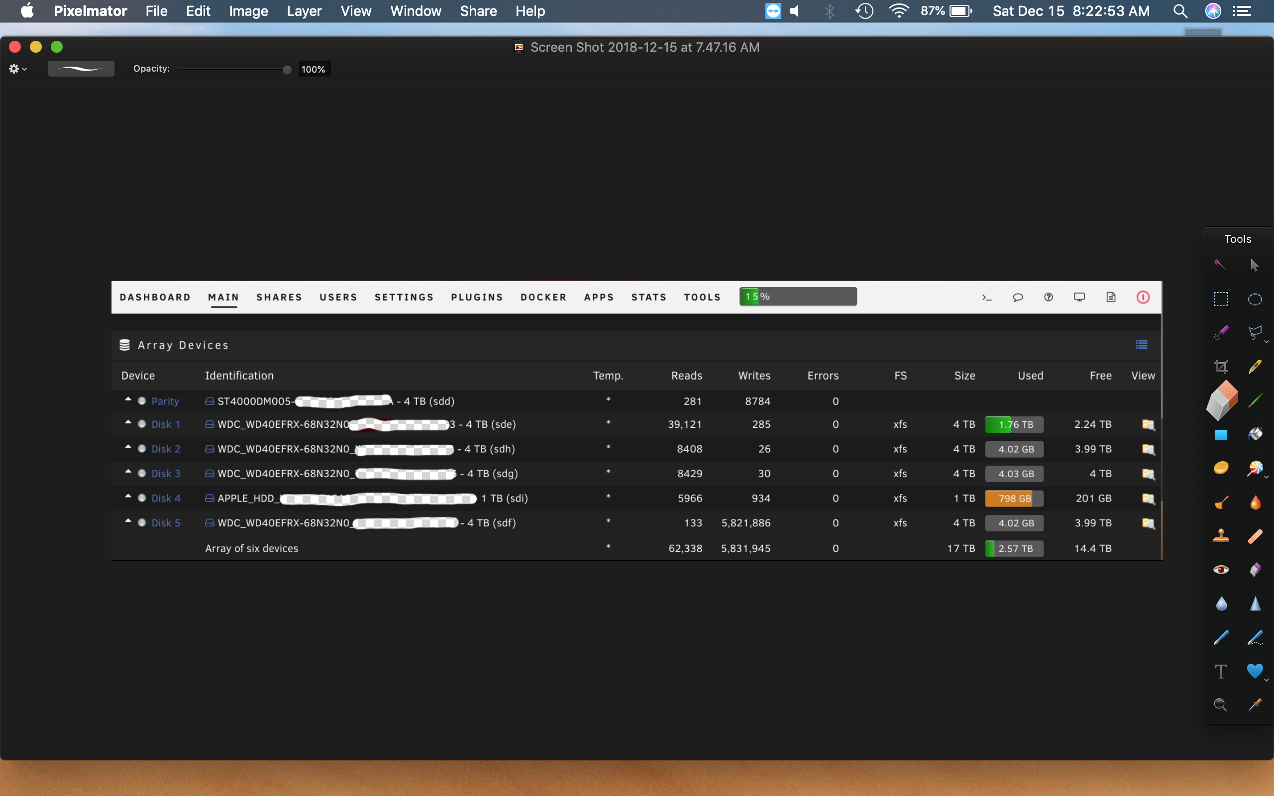

Thanks Trurl I have brought down parity2 and put it into the array as disk5 and all is good Now I can add 3 new disks and reassign sata ports maintaining parity1 position? I purposely left parity1 as the seagate drive since its the only one I have to make it easily identifiable805754834_ScreenShot2018-12-15at8_22_53AM.thumb.png.5db9128439f3ea61cd3c3e417d2553be.png
It seems like you jumped ahead and put parity2 in as disk5 without checking back with us. How exactly did you do that? Of course you could have done it as part of the New Config, but it would have invalidated parity. Did you add it in afterwards and let Unraid clear it?

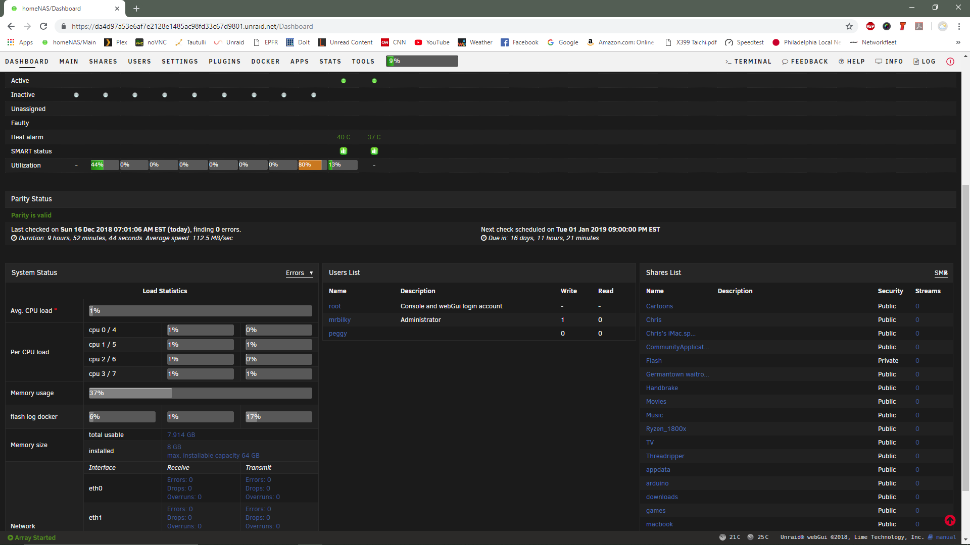

Just an update and a thank you all went well I did a new configuration to put the drives in the order I wanted them in and went to bed while it ran the parity check all is good no errors and all data and drives appear correctly, I do have one question though I noticed my ram is hovering around 40% from a previous 20% is that because I added 3 new drives to the array
Where exactly are you seeing this?
It was as high as 50% but has come down a bit:
Of course we have no evidence or anything to work with regarding what it was doing before. Maybe it will settle out. Simply adding drives should not matter.
Yep not sure when it started I guessed it was from adding the HBA but I have very little experience with linux and networking stuff I've been winging it and got away with it for some time but sometimes it catches up to me, I'll figure it out sooner or later appreciate your help don't think I would have found the "tools, new config, preserve current assignments without a few more days and allot more reading sometime information overload gets ahold of me, thanks again!
With all the changing of cables and installing a hot swap bay and HBA I dislodged a stick of ram thus running normal at 20% of 16GB would equal 40%+ of and 8GB stick go figure🤐
