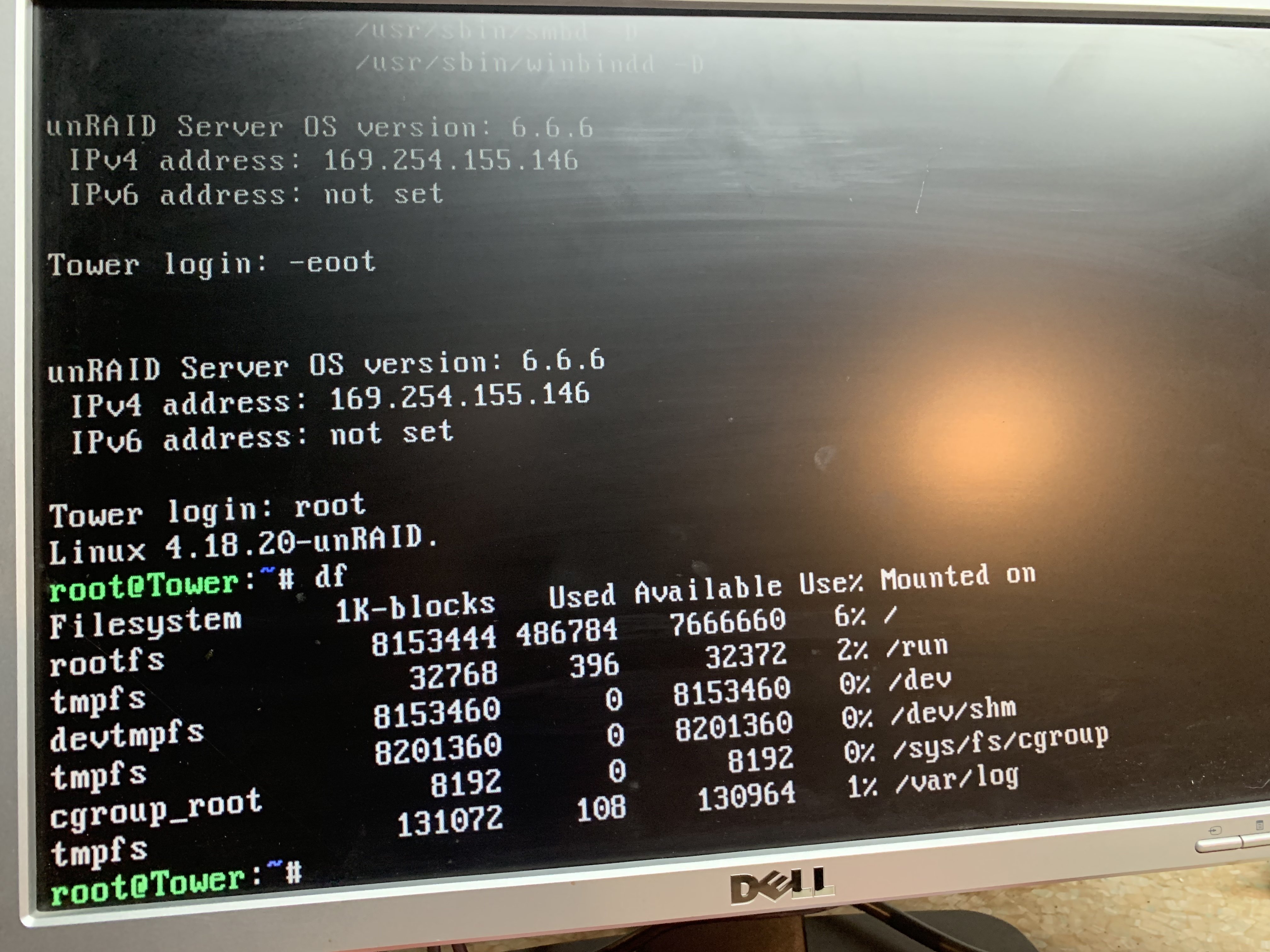

This is from the “df” command and I also just plugged it into the back instead of that spot on the mobo
That shows that there is nothing mounted at /boot (which is where the USB drive should be mounted if the boot process is completing correctly).
The problem is going to be to work out what is causing this.
