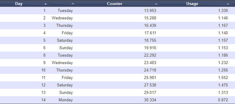

Capture_Domoticz_-_Google_Chrome_2019-01-14_14-20-42_74627127.png.4f06d7aa45e89be9ee6f58103bae87a5.png
Specs in signature. Spinning down hdds after 45 min inactivity. About 1.5 kWh the day of parity check.
Edited by Niklas
