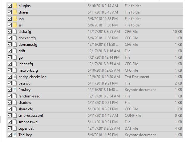

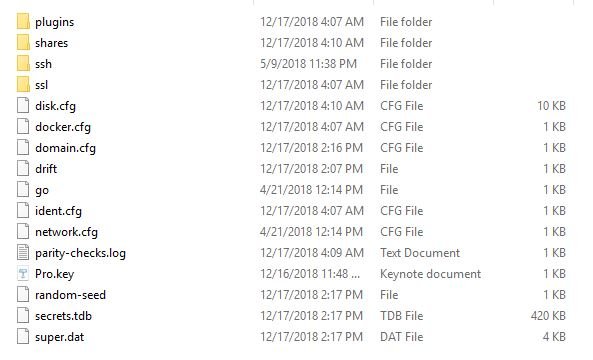

Get me a list or screenshot of the files and folders inside the config folder on the flash drive. Don't really need to see any of the subfolders, just config.
When I look on the flash drive, there are two "unRaid" Folders: Unraid (D:) and Unraid (F:)
Inside config folder on Unraid (D:)
Inside config folder on Unraid (F:)
Well that is definitely wrong, sounds like you have 2 partitions. And I can't imagine how you could have gotten to that state if it was working before.
There probably isn't much point in trying to figure out how you got to this point. Looks like the (F:) partition is new and maybe the (D:) partition has what you need on it. So we will start there.

Make a backup copy each of these config folders to somewhere on your PC. Make sure you keep them separate and you can identify them later.
Prepare the flash as a new install, copy the config folder from the (D:) backup to that new install, then try to boot Unraid.
